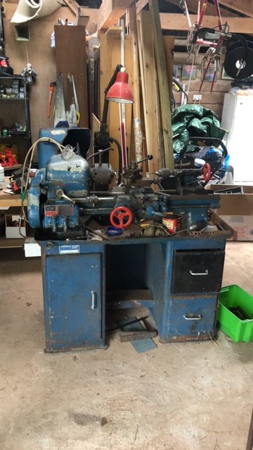

    Hi Mr Mechanical,
    I have just bought the same beast and it needs a lot of work. I'm really keen to hear how you get on - I haven't got much time to spend on it at the moment but hoping to soon.

    Hi Mark, your machine looks good. I with I had a proper base for mine. What does the lever do on the side of the headstock?
    I've started putting mine back together finally! Gearbox is back together now. Next video is uploaded on youtube. Should get the spindle back together and fitted this weekend.

  9. #6
    May 2019
    Stockholm, Sweden...
    634
    417
    Thanked 806 Times in 319 Posts
    DIYSwede's Tools
    Quote Originally Posted by Mr Mechanical View Post
    -Isn't it just the intricate "Forward/ Reverse" switch described in the text at:
    Smart & Brown "S", "SAB", "Sabel" & 918 lathes ?
    Paragraph starting with "As two examples of wonderful attention to detail..."

    I will have to have a look at that in detail. The lever was missing from mine when I got it.

    Quote Originally Posted by mejdavidson View Post
    Hi Mr Mechanical,
    BW
    MarkClick image for larger version.
    Mark!
    Do you have many accessories for your lathe? The manual I have includes details for such things as taper attachments. However I've been struggling to locate any for sale.
    I've also struggled to find back plates to fit the 1.75" 8tpi thread on the spindle. I may have to make one / modify the one I have to accept a 4 bolt / 4 jaw chuck.
