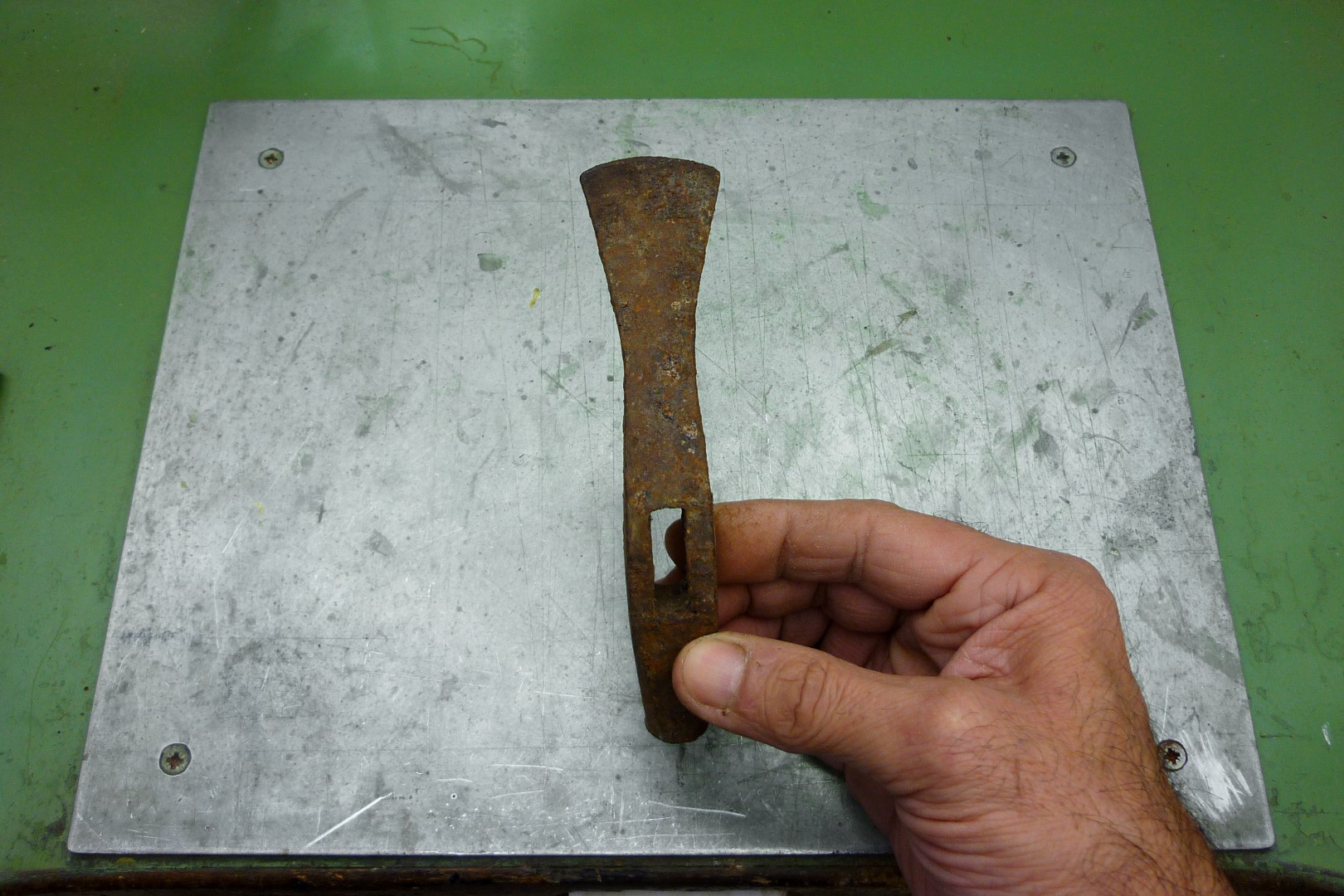

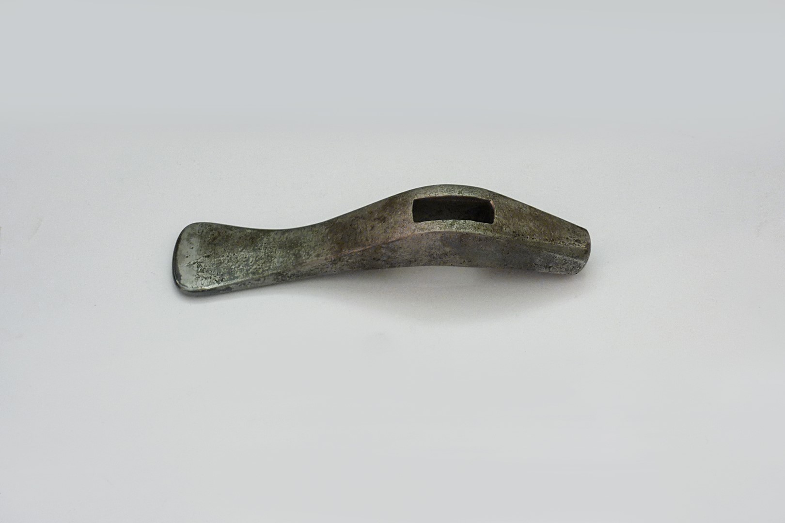

    Hello,
    This is a shoemaker’s hammer I found long time ago. I had almost forgotten it in my toolbox; I decided that was time to do something with it and was the best candidate for a texturing hammer!

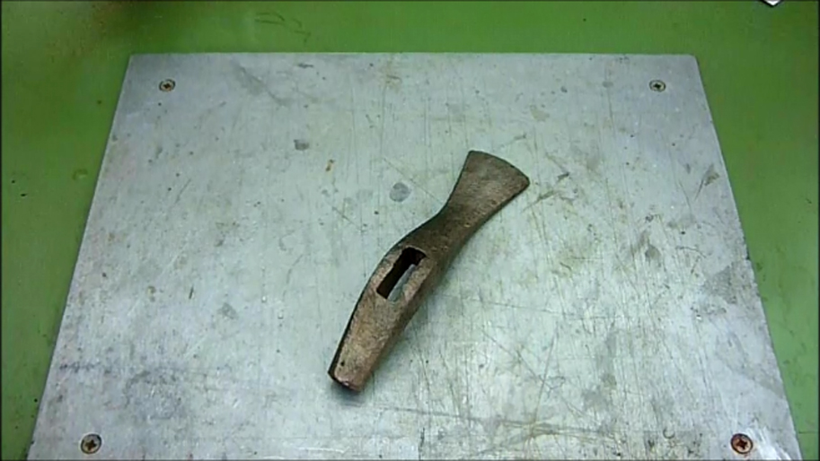

    Restoring and repurposing an old shoemaker's hammer-p1120437-large-.jpg Restoring and repurposing an old shoemaker's hammer-1245.jpg

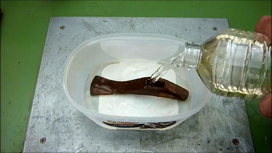

    I left it to soak in vinegar
    Restoring and repurposing an old shoemaker's hammer-1246.jpg Restoring and repurposing an old shoemaker's hammer-p1120791-large-.jpg
    3 days later

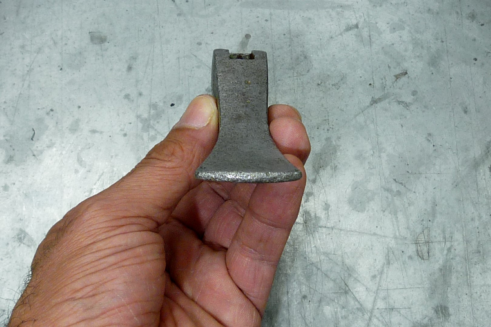

    With a bit of filing and sanding the job was done

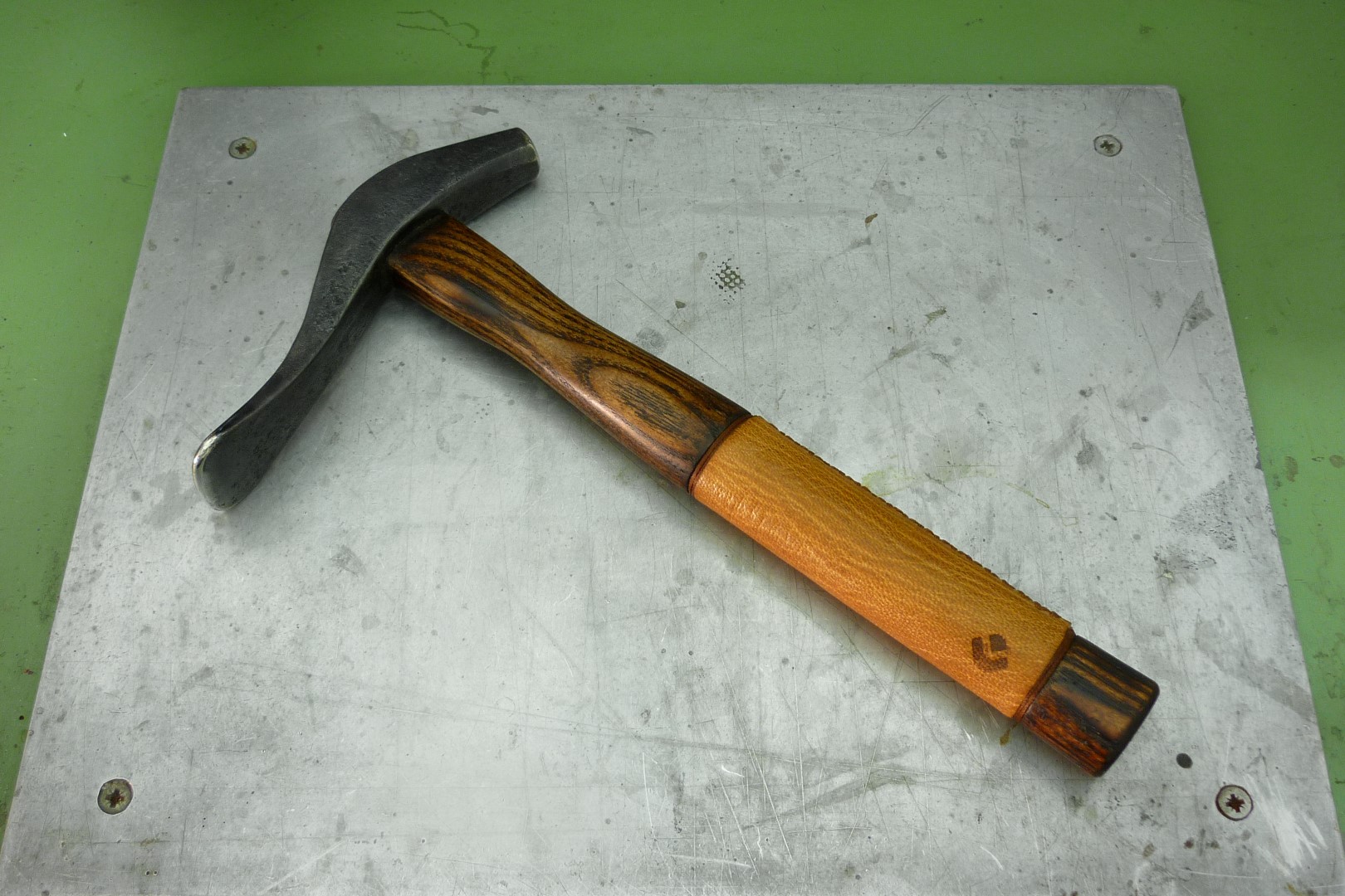

    After the hardening
    Restoring and repurposing an old shoemaker's hammer-p1130104-large-.jpg Restoring and repurposing an old shoemaker's hammer-p1130105-large-.jpg Restoring and repurposing an old shoemaker's hammer-p1130106-large-.jpg

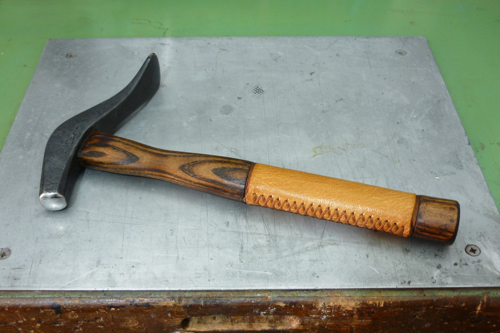

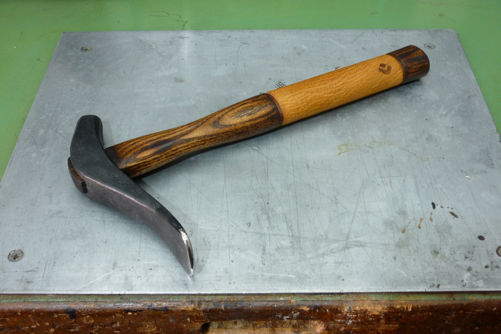

    As it looks now
    Here is a short video if like to watch. Now, in one of the comments a viewer said that the process of wrapping and stitching the leather on the handle was short to see; he asked me if I could make a video showing the process in more detail, so I made one.
    I thought you may find it usefull, so I post it too.
    All the best
    Dimitris
