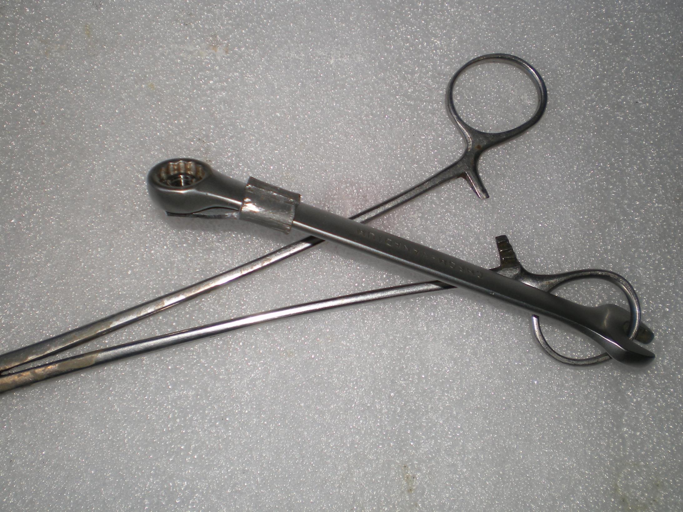

    It could but my favorite tools for that are hemostats. I have them in sizes ranging from three to twelve inches long.
    The only problem with hemostats is that they're, of course, electrically conductive. Not what you want for retrieving stuff from spots near energized circuits. I keep a pair of chopsticks in each of my tool boxes and bags. The tips can be carved into any convenient shape on the job site and they're dead cheap to replace when mangled. If you're not comfortable using chopsticks get one of the plastic hinges used to make chopsticks easier to use for children...

    Good point about the chop sticks Marv and really enjoy the creativity of your inside bore slot mic. I keep a pair of the long Wok Chop sticks as well as standard ones around the shop too, but haven't needed a rubber band or kiddy hinge since the early 70's. Made a few for the grand kids though. Perhaps rubber coating hemostats completely might help with live situations? I have a set of plastic ones I got from somewhere medical that are longer than normal but haven't got much spizeringtom but for a light pick they'll do.

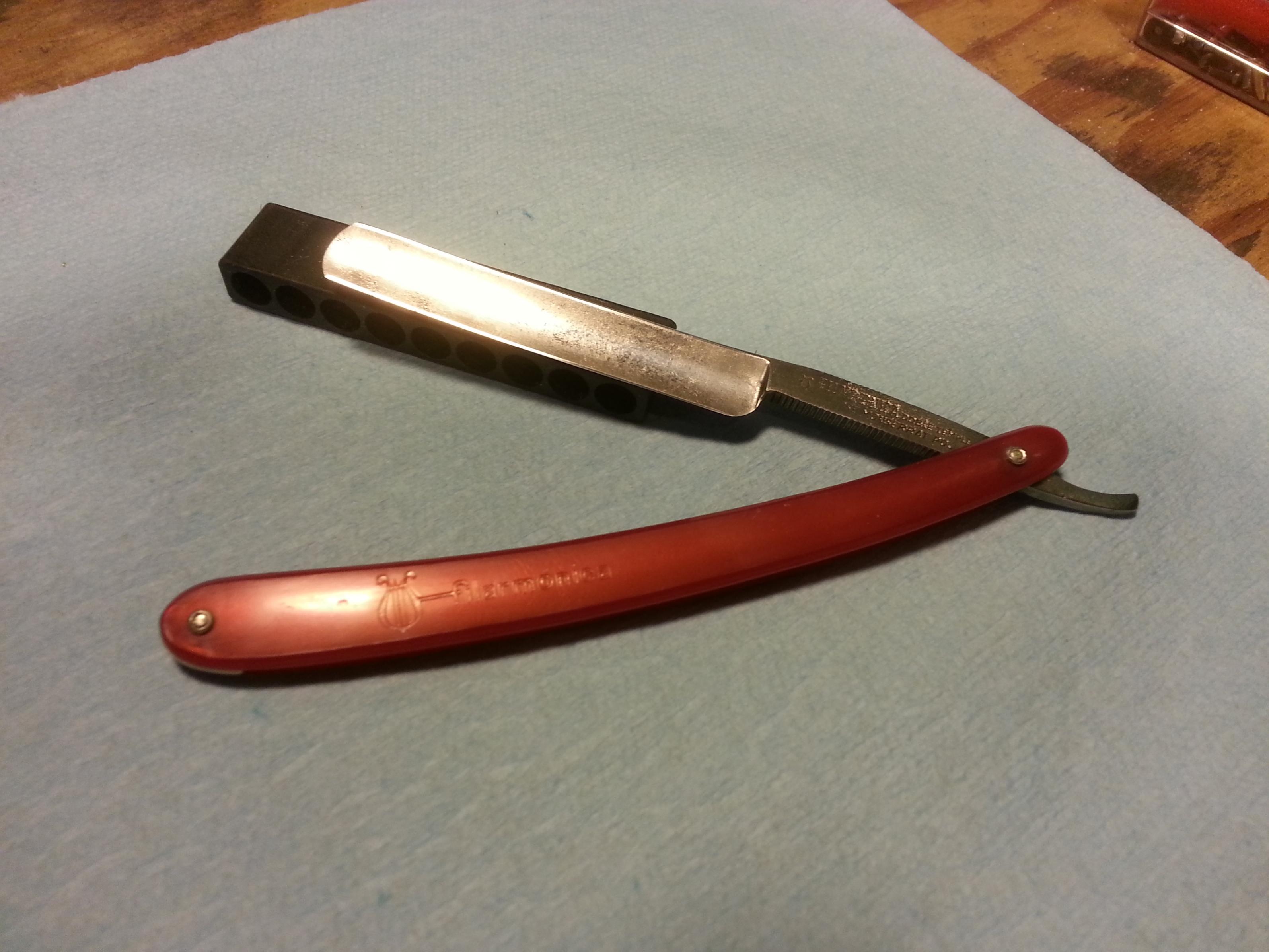

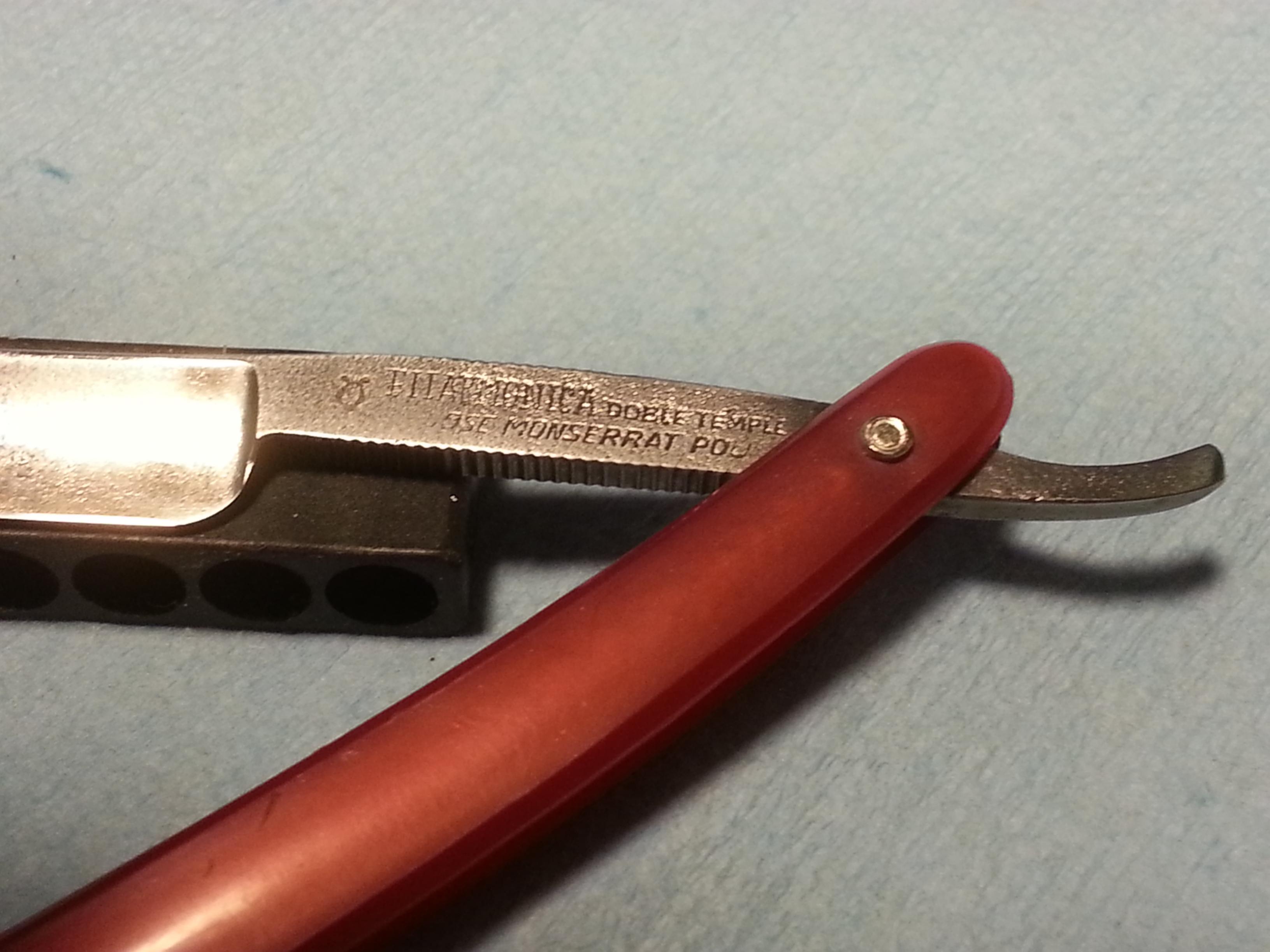

    CRS is a never ending rag anymore it seems. I found an old straight razor in my tool box (back of one of the "Odds and Sods" small drawers) a while back and turned out it would have been valuable if I hadn't let it go so long. It's a Spanish "Filarmonica" by Jose Monserratt Pou back in the mid to late 60's. I restored it best I could anyway for me but if I had the box and good shape...it was worth some duckets. Need t0 scrounge around back in those places some more....
