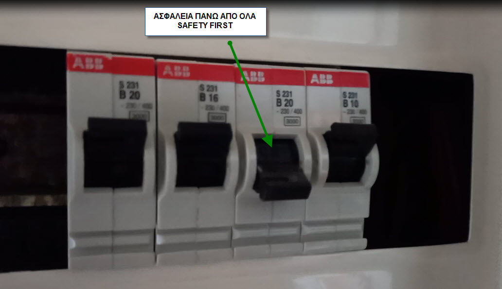

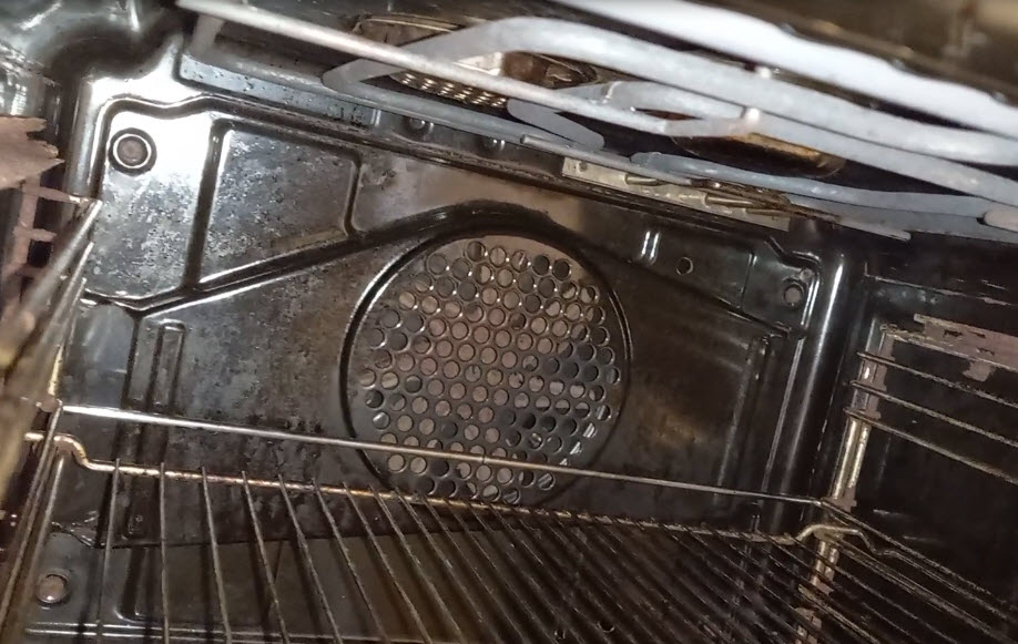

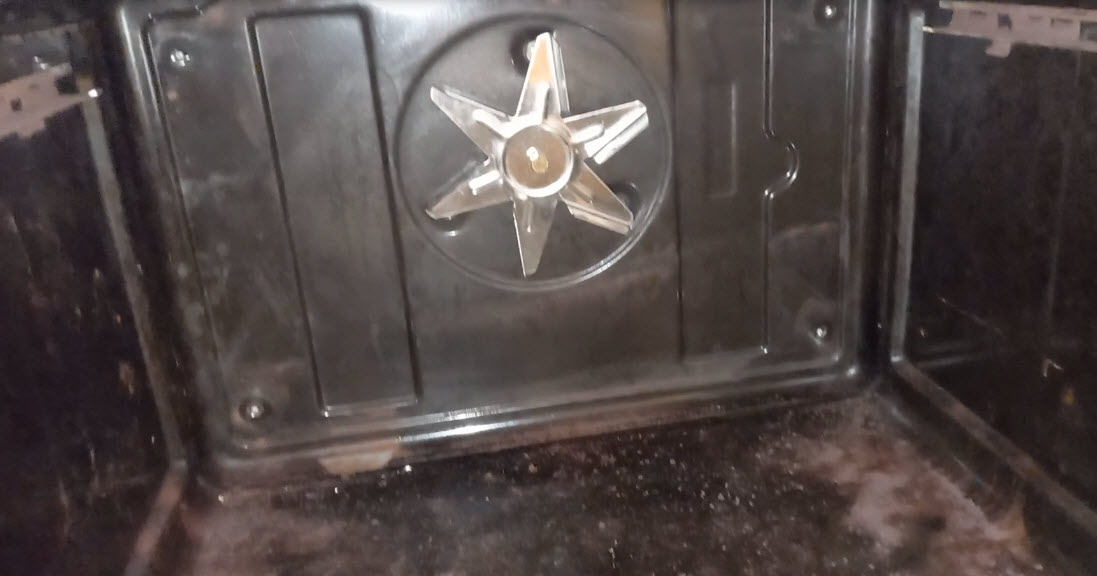

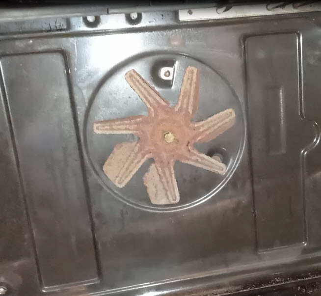

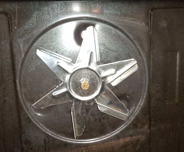

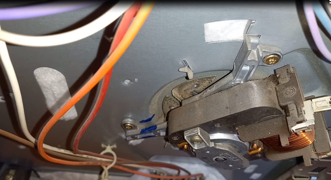

    A common damage to the kitchen oven is the wear of its fan. With the timely change, we prevent future damage to his motor. Here we see how to replace this fan with simple tools.
