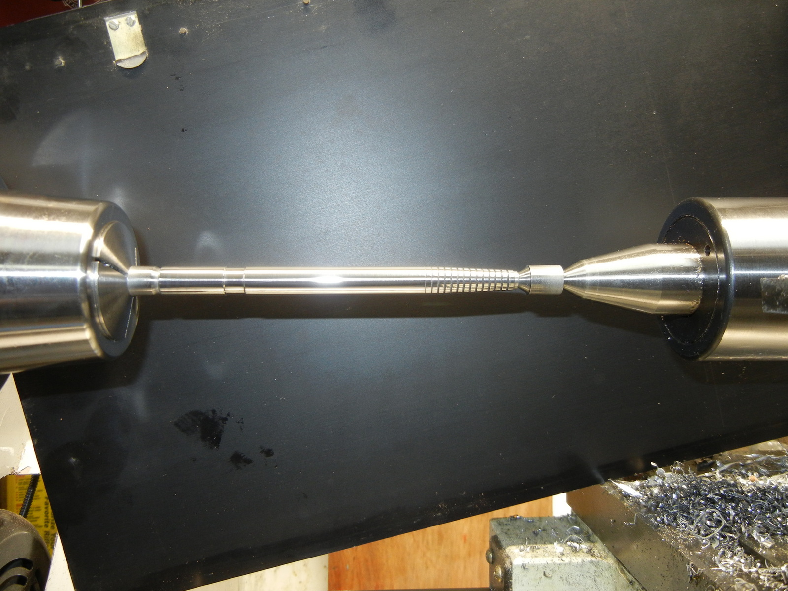

    I also made a mandrel to hold the sleeve while machining the surface. This speeds the operation and achieves better accuracy.

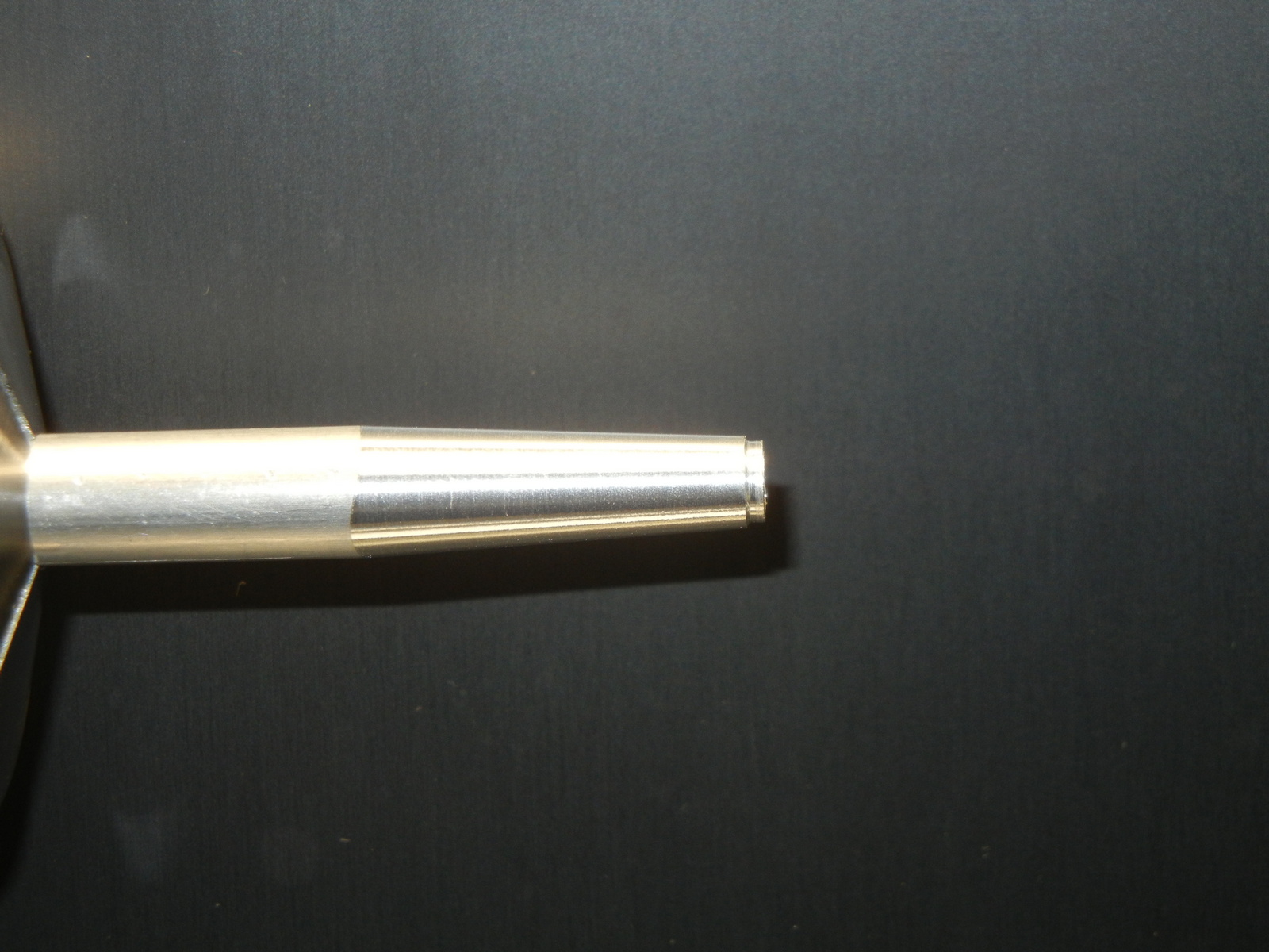

    Starting with 3/8" aluminum stock, turn the end 0.236 x 0.052
    Drill a #21 bit 1" deep. Turn approx. 2 1/2 degree taper.

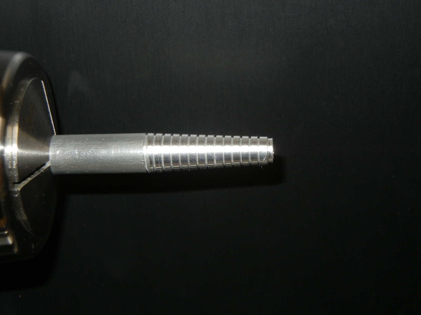

    Cut grooves for a better grip or just for looks. I used a 60 degree threading tool spaced every 0.080" x 0.020" deep.

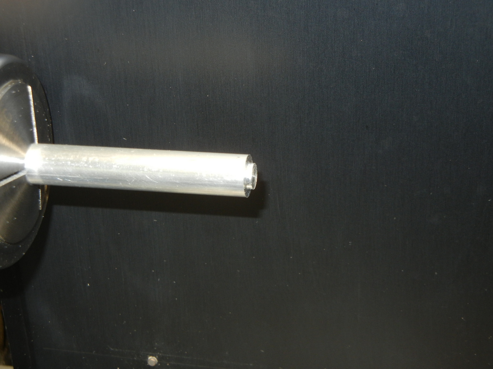

    Reverse the sleeve and trim to length (4.440"). Drill 1/4" x 3.75", then drill #15 x 4.27" and finish with a 17/64" x 0.8" deep.

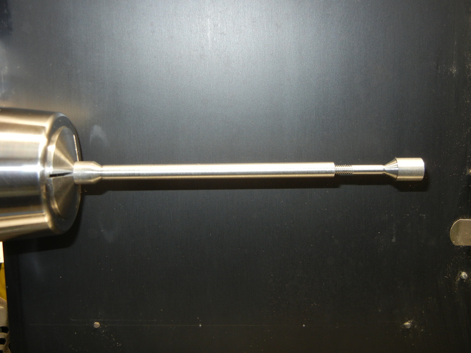

    Mandrel I built from 12L14 to hold pencil sleeve while finishing the outside.

    Turn down sleeve surface to 0.361 to eliminate imperfections in the surface. Turn pocket clip recess 0.80" from end, 0.015 deep by 1/4" long.

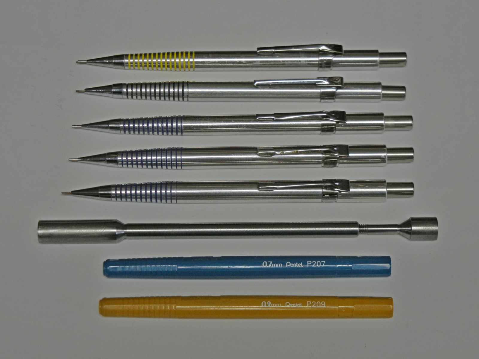

    The top yellow pencil survived building a house, the bottom two blues ones are brand new. I build them now to give as gifts.
