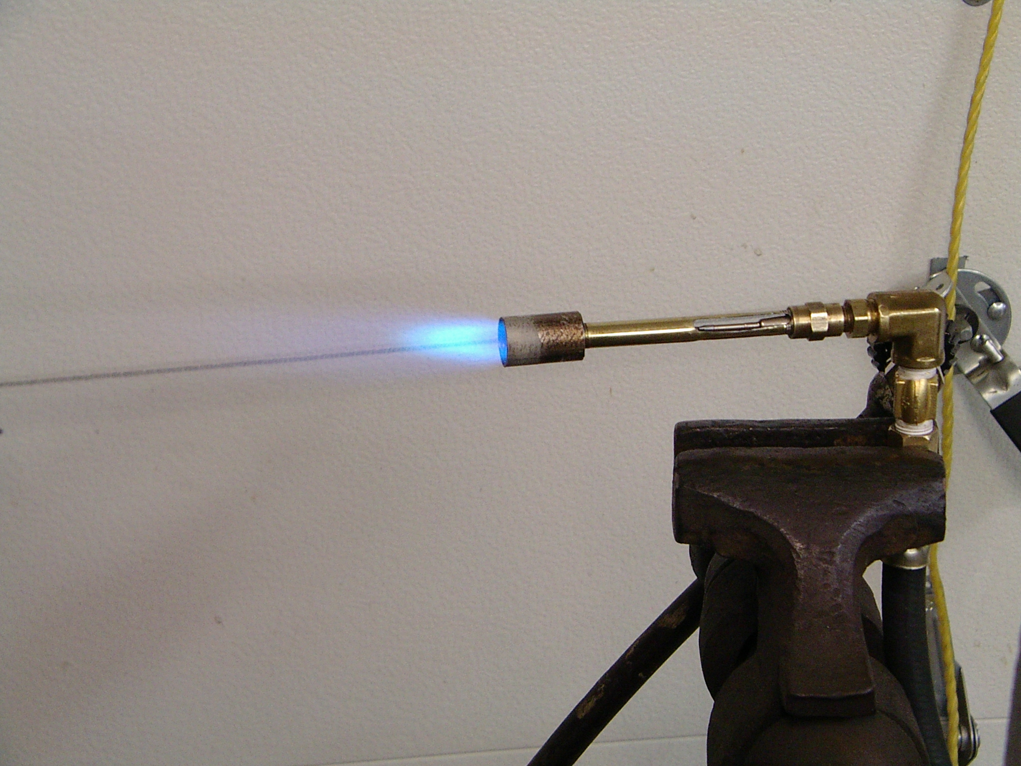

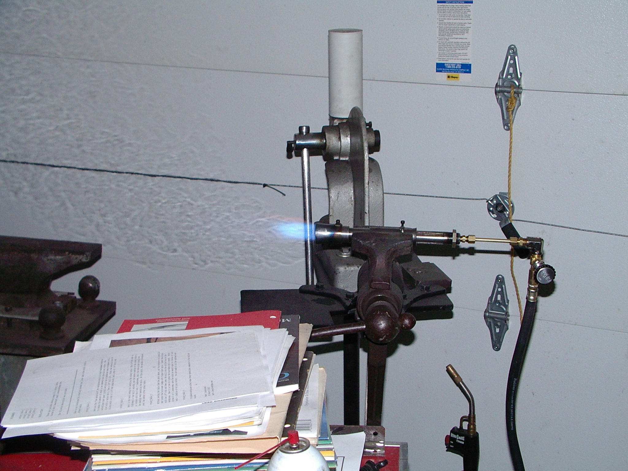

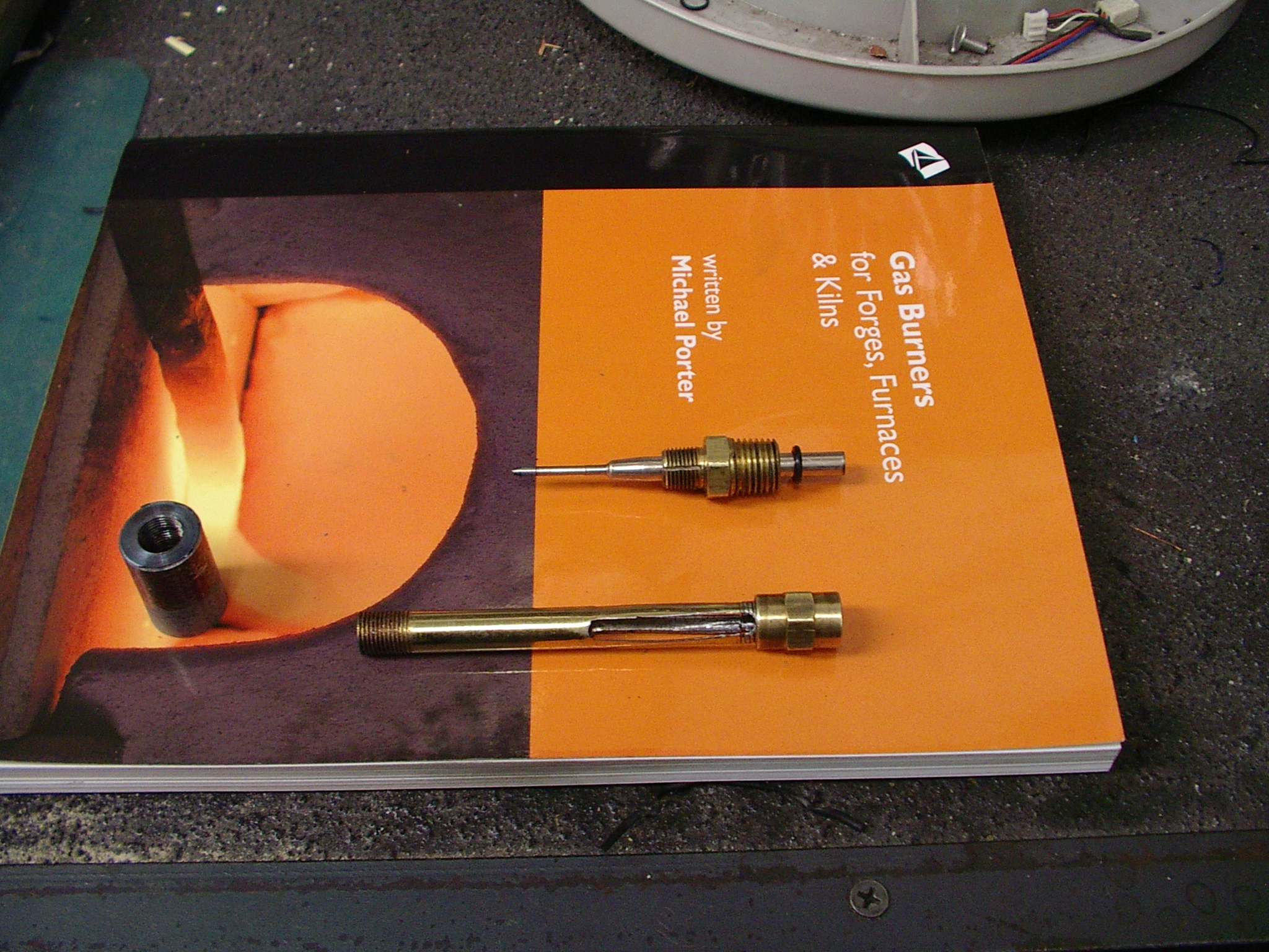

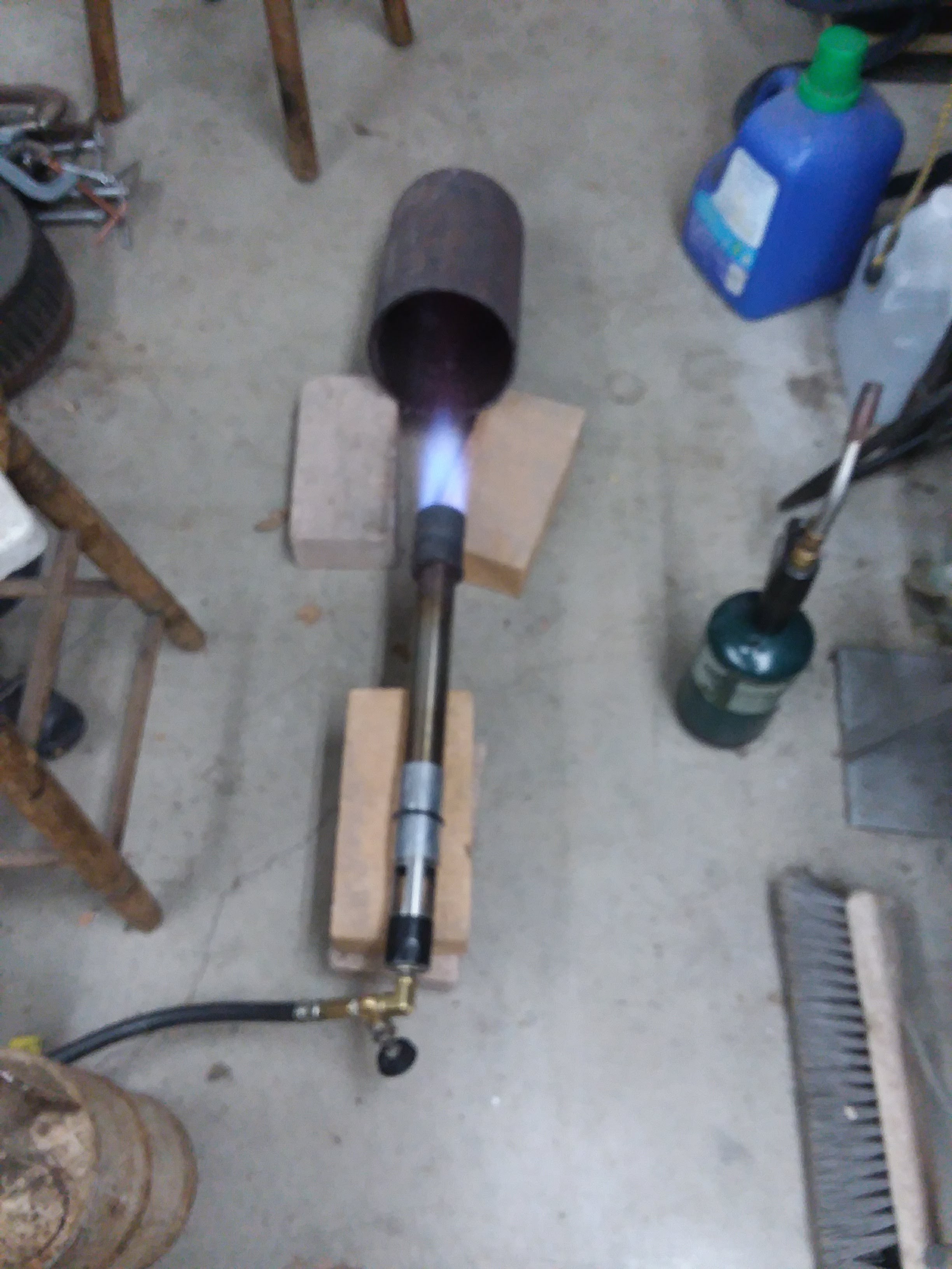

    I built some Mikey burners a few years ago. Back then the book was only $20.00 so I bought it. I also have a pdf copy on my phone for quick reference.
    Repairing a 1-Ton Arbor Press-imgp2634.jpg Repairing a 1-Ton Arbor Press-imgp2633.jpg Repairing a 1-Ton Arbor Press-imgp2606.jpg Repairing a 1-Ton Arbor Press-20171210_173148.jpg They go from the smallest made from a ballpoint pen for the nozzle to the large ones using mig nozzles and parts turned on the lathe. The big one is blowing into the end of a fire extinguisher and melting glass inside. It also heats the shop to 90° in just a few minutes from near freezing. With a stack of fire brick, it gets steel up to forging temperature.

    All these and more were done to see if Mikey's numbers were scalable. They scale nicely from very small flames to over 2" pipes. The first 2 have long tubes so I could play with injector depth. The last one I turned a piece to direct flow better and I go a very nice laminar flow. I only used electrical tape to hold it together. It actually gets fairly cold where the tape is. It has been about 12 years since I built these so edits came to mind after the fact.
