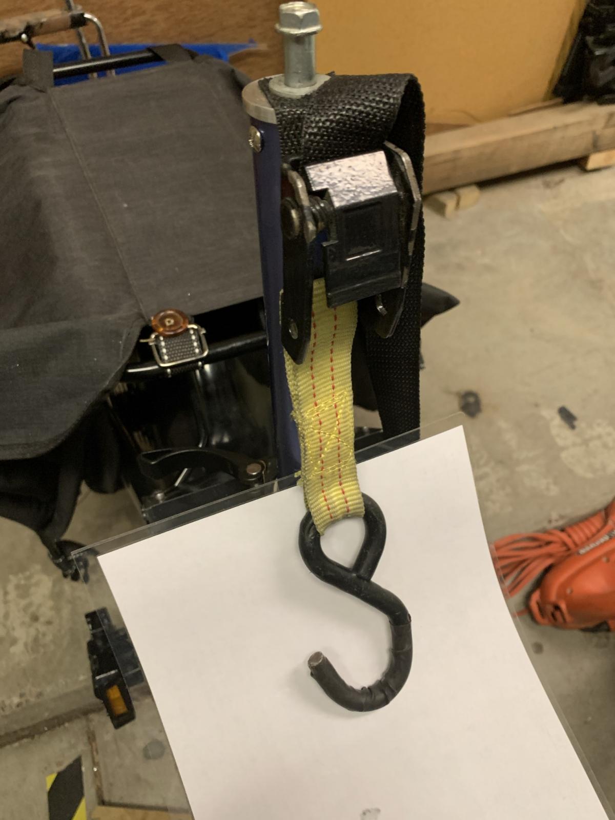

    The design continues to evolve. I added a strap clamp which makes adjusting the height much easier.
