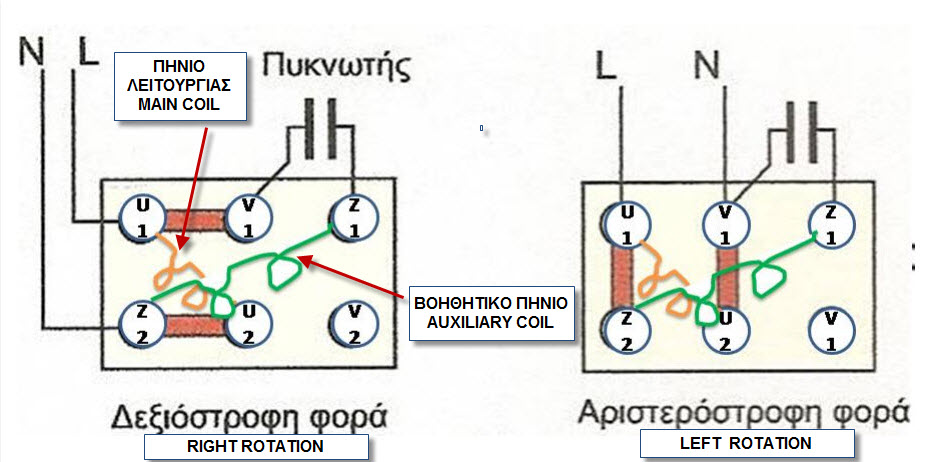

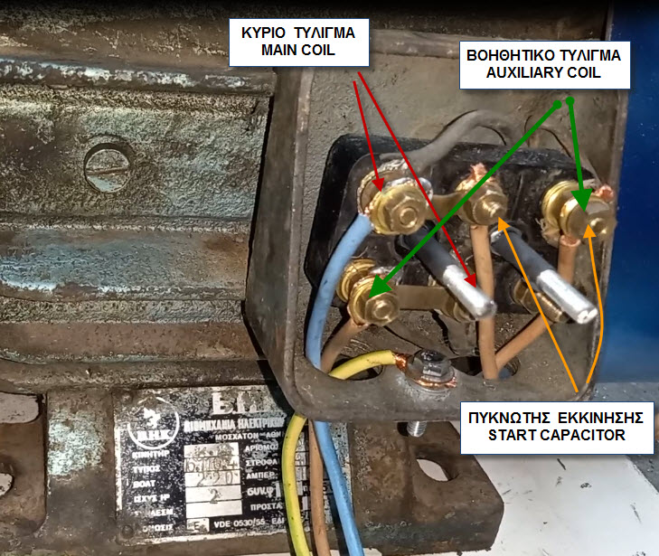

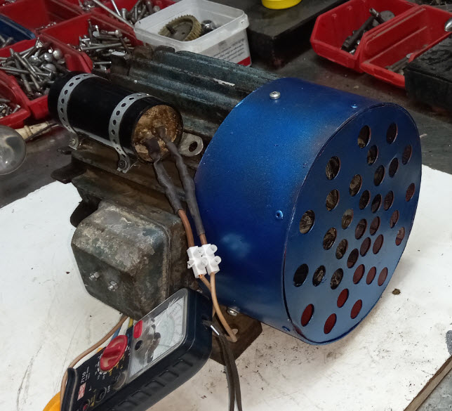

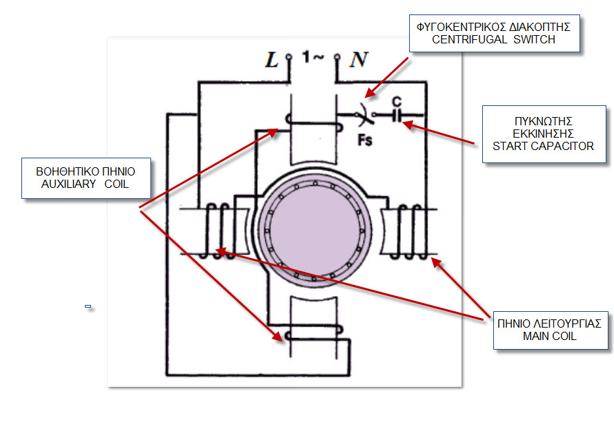

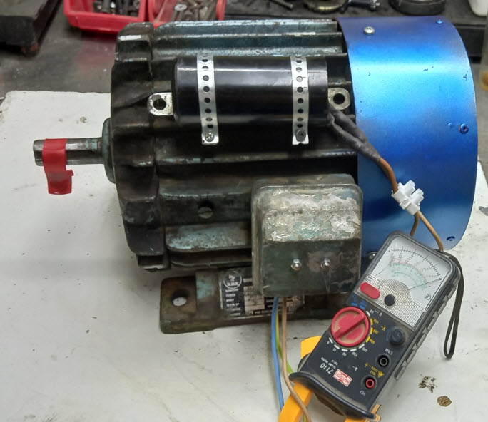

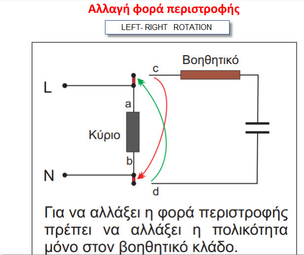

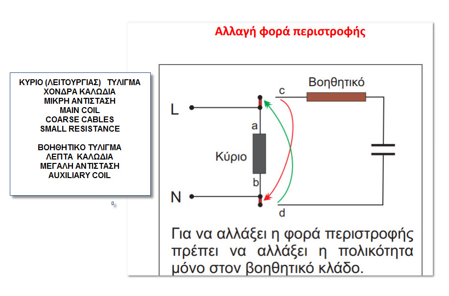

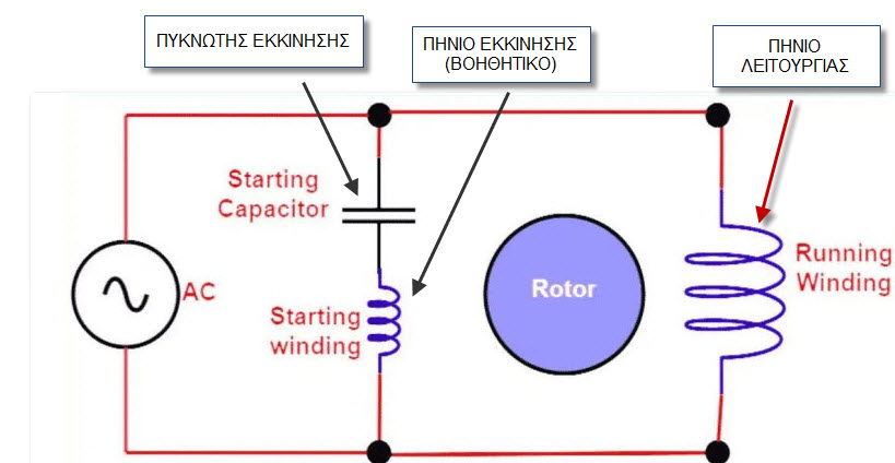

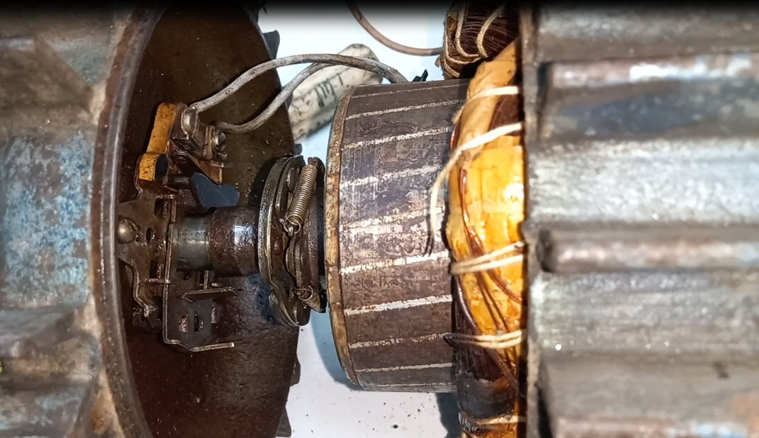

    REPAIR - MAINTENANCE OF SINGLE PHASE ELECTRIC MOTOR
    In this video we see the parts that make up a classic asynchronous single-phase electric motor. We also learn how to do a simple maintenance and repair on this motor, as well as its wiring for normal and reverse direction of rotation.
