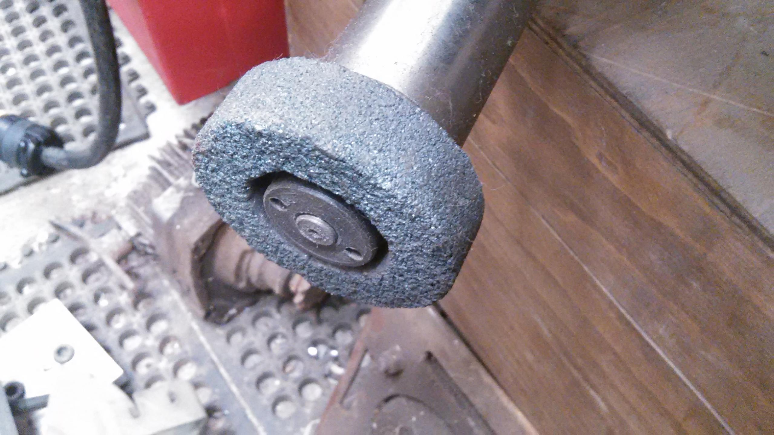

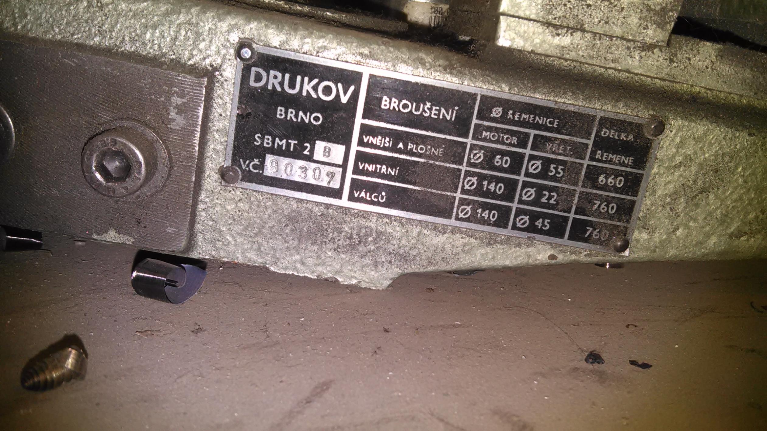

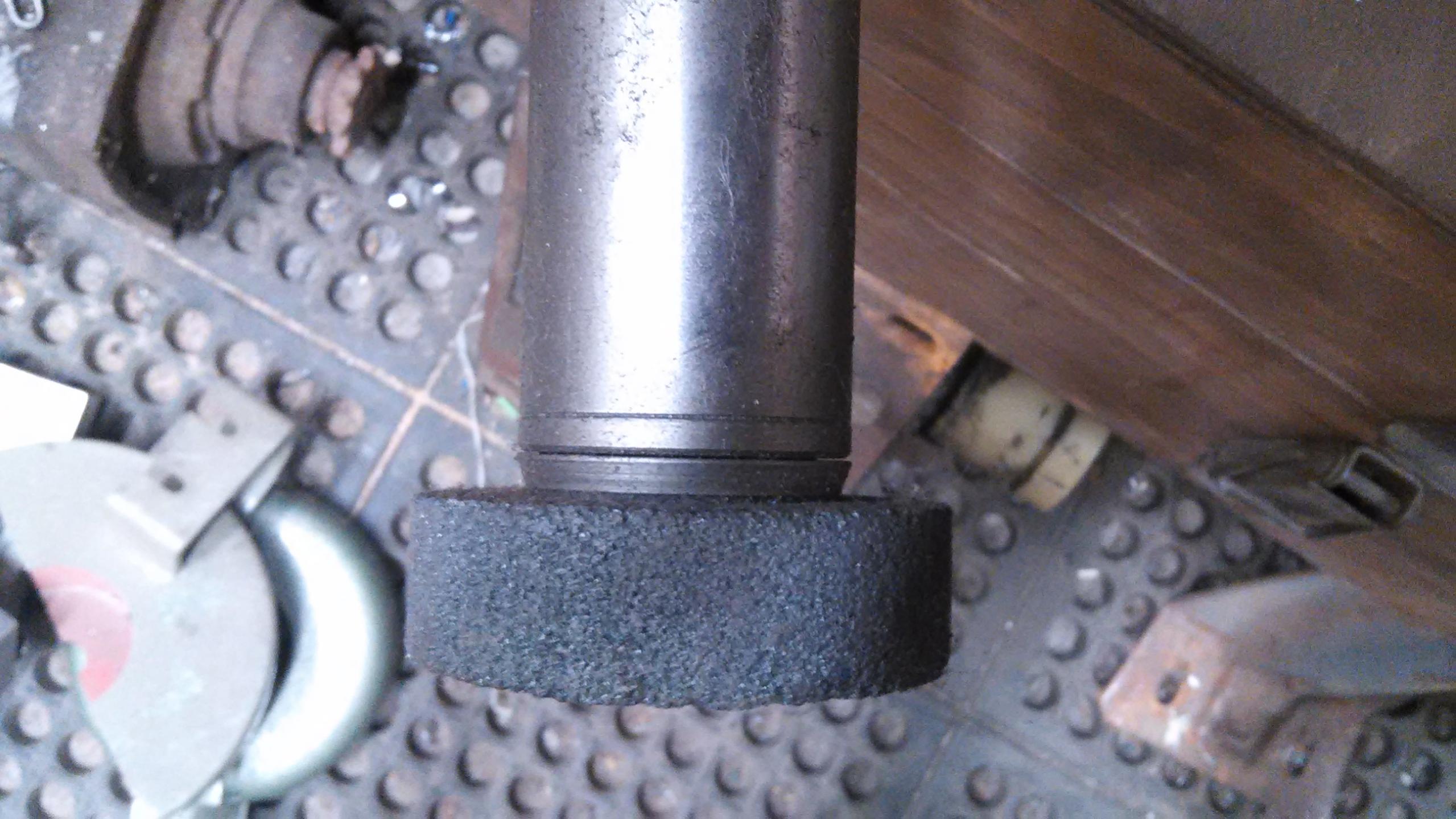

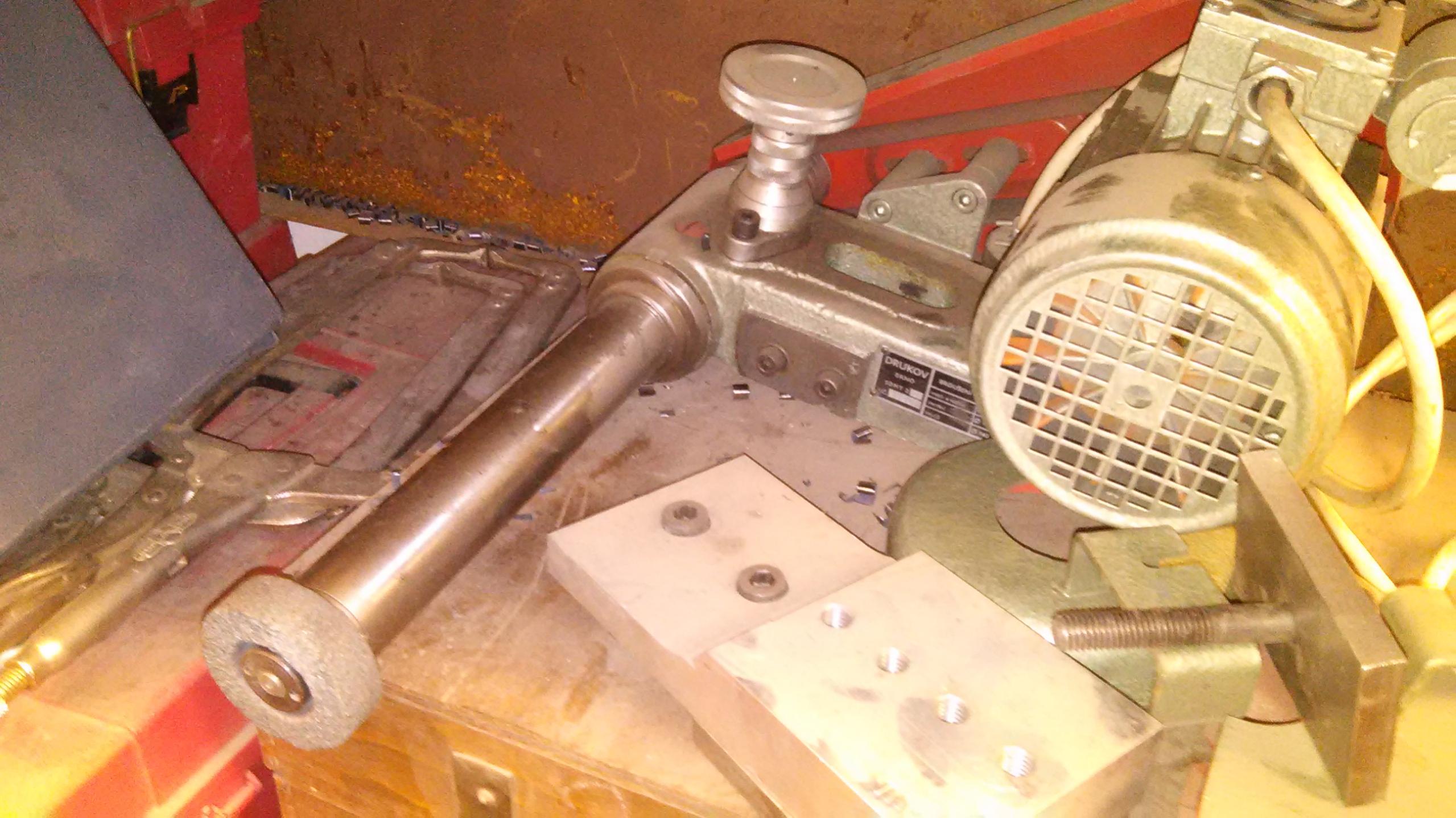

    A photo or 2 of the TPG I have:
    Repair guy-2017-03-17-bench-center-tpg-photos-013.jpgRepair guy-2017-03-17-bench-center-tpg-photos-006.jpgRepair guy-2017-03-17-bench-center-tpg-photos-008.jpgRepair guy-2017-03-17-bench-center-tpg-photos-009.jpg
    So the recessed wheel for this size hub and shaft, should be fun to find. Unless you've seen these before. At least the internet search recognized Drukov as a tool post grinder.

    Interesting brand as I've not seen one of those before. Mine is a Dumore and has 2 HS internal spindles.

    Thank you Stan,
    Ya, all the internet had was 3 for sale, all in the past. One site said it was made in Taiwan (not true), that might be easier to find wheels for.
    So I just took some measurements of the spindle. The spindle shaft is 10mm, with a bushing for the stone mounted of 20mm OD and 9mm thick. The lock nut is 28mm OD. So any wheel will need to have a recess mounting thickness of 10mm with a ~35mm minimum recess opening for the nut (current wheel dimension). Any shaft hole size probably from 10mm to 22mm, as I can make a bushing, limit is the nut and backing flange diameter of the drive shaft. The 10mm mounting thickness probably can be a few mm more just so there's enough threads caught to not strip them off the end of the shaft or nut.
    That said I can make a much larger backing washer, and special nut that has a flange with and extension (that will also serve as the centering bushing for the wheel). Just what I want, kill more alligators to drain the original swamp problem. I guess this site is all about making tools, at least this would have future use.
    The existing wheel is very coarse, and as the spindle bore needs to be mirror smooth, I'm pretty sure I need a finer grit and softer stone after the rough in.
    I'm looking on eBay now. Problem is there is not enough dimensions in any of the adds. So will need to see if the original vendors web site for the brand of interest has dimension drawings.
    I had better luck finding grinding stones for my antique Black and Decker valve seat grinder.
    So is there a procedure to remachine a grinding wheel using a 3 jaw on the lathe and diamond stone? Just in case I need to make a larger diameter deeper recess opening. Big RPM difference between a grinding spindle and lathe spindle. Just wanting some ideas of how this can be done with some precision to maintain balance, big problem making the square inside corner with a diamond dresser. The grit in every part of the lathe jaws is not what I want, but.....
