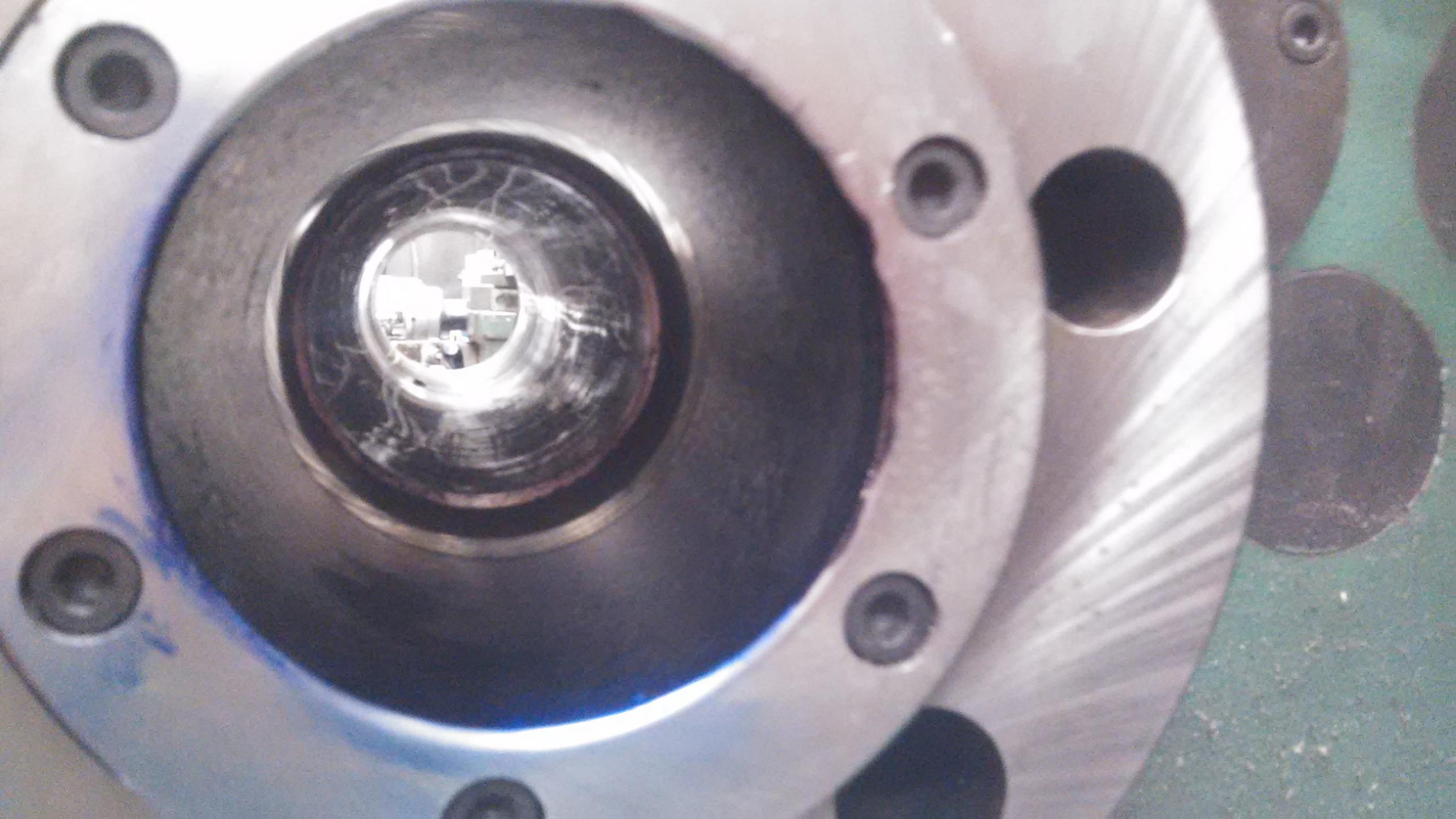

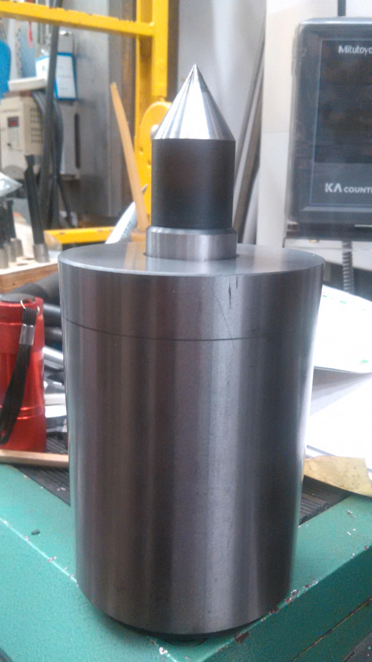

    Repair headstock spindle morse taper sleeve adapter
    Current project is to fix a Grizzly G3621 (16X40) headstock spindle taper. All the documentation says it is a #6 Morse taper, but with a 80mm (3.125) through hole, it's bigger then 6MT (it is also bigger then 7MT). So I now believe it is a 90mm gage line, metric taper 1:20 ratio (would like to know where tooling for this can be found, but $ for custom, drives me to make my own). The sleeve that came with the lathe that adapts a 4MT center to this spindle taper, is sloppy where the taper bottoms out, and leaves the end protruding from the spindle with .0045 runout. I can rock it back and forth with a brass hammer, but this is unacceptable.
    So I need to see if the sleeve is wrong, or the spindle.
    I'm looking for tooling ideas to both measure this, and do the correct repair. I assume the sleeve and spindle are hardened.

    Photos of lathe spindle hole and center adapter sleeve
    The lathe does have a taper attachment, but it needs some gib and other adjustments to work smoothly.
    The existing sleeve that adapts the 4MT center to the lathe spindle

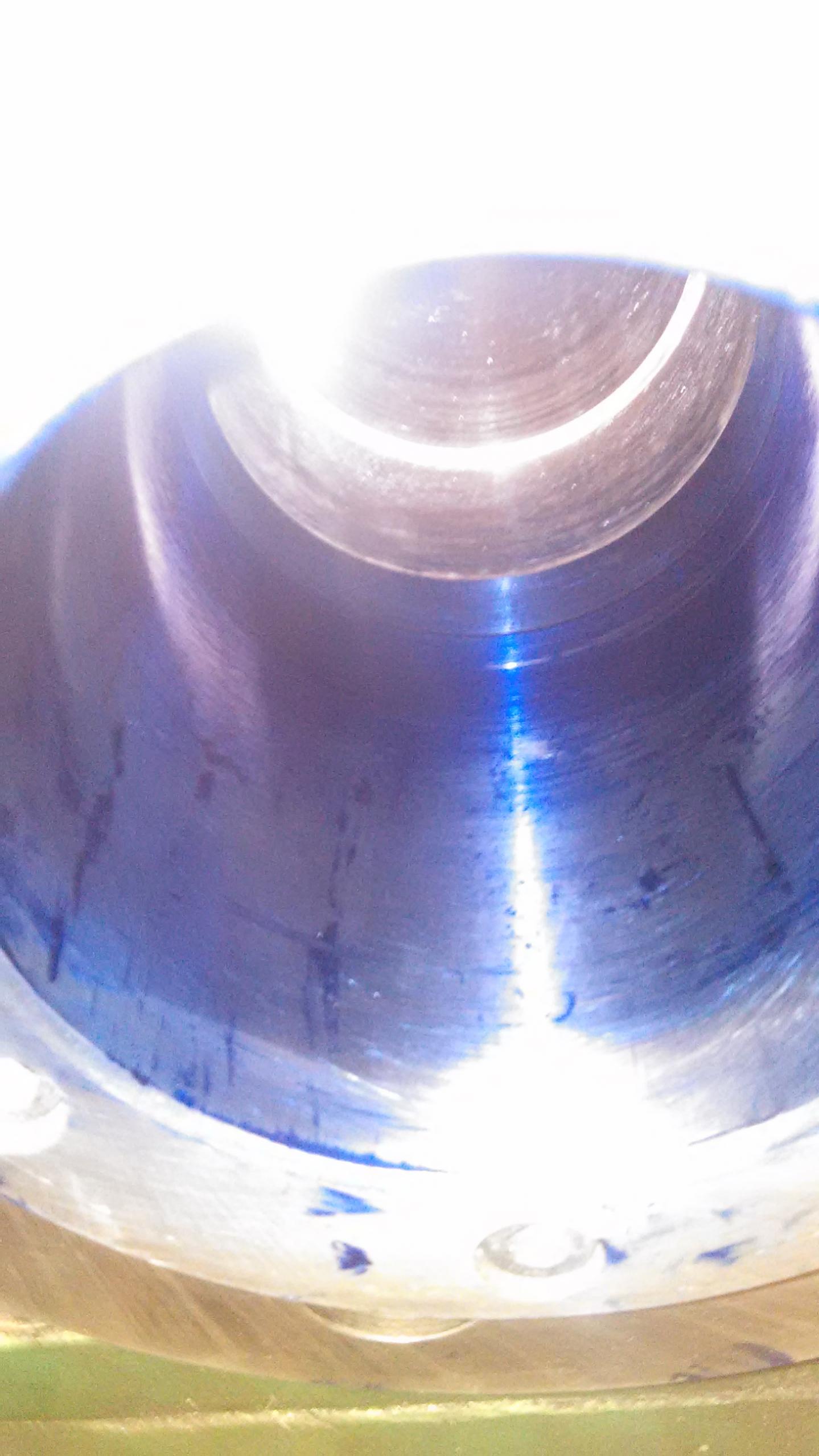

    This spindle is a D1-8 chuck mount.
    I over applied the Dykem Hi-spot, but the sleeve was only contacting at the bottom of the taper.

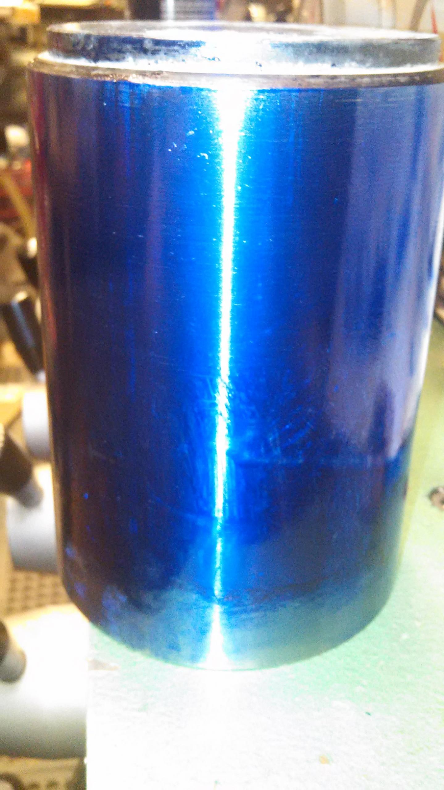

    The sleeve. I did over apply the hi-spot, to where it acted like a grease and prevented the taper from locking.

    That may be a 7 Morse taper. You can look up the specs in Machinery's Handbook. If you find the spindle is worn or not at the correct angle, you can recut it with a carbide insert boring bar. You can use the taper attachment, or swing the compound slide around to the correct angle. I like to use the compound for short angles.

    I hope I am reading the problem right.
    My initial thought is, to clock the internal taper of the spindle to work out exactly what the taper is - decimal or inch - i.e, x fractional inch taper per y inch linear - or metric equivalent. Then, see if there is some way to set up the adapter by some means - mandrel of some sort and get it running true via a 4-jaw chuck... this is the awkward bit! Not sure yet quite what I'd do without the adapter actually in hand!
    If that can work then the adapter can be clocked to see what the taper discrepancy is exactly, then set up for the correct taper and grind externally or even cut with a carbide insert even if hardened. Now, if this could improve things the next step could be to lap the adapter and spindle gradually together until the fit is correct - which would mean then having to always use that spindle taper/adapter combination for good. A good 1/10s indicator would be useful.
    One other thought - if internal taper of spindle could be measured well enough - use that info to turn a new dummy adapter out of ordinary CRS and try and get that right for fit. If that worked then drill and ream for end to take a Morse dead center. It could serve even if not hardened.

    Do you have any runout when using the chucks? I'd mount the sleeve on an arbor mount a center and center it in a four jaw chuck and using a dog to drive I'd set up a grinding fixture on the tool post . Indicate the compound to the taper and then using a seperate indicator on the bottom of the compound. Then I'd take a test grind full length of the taper. If it cleans up all the blue dye I'd loosen and tap the compound about .002 at the tailstock end. Recut the grind measure the large end if it matches the taper in the head I'd stop and recheck the fit in the spindle. Easy to save your zero by just taking the arbor and part out from the centers. Remove the chuck and Ck the fit with blue dye. It may take awhile but you can fit it a few thousandth at a time. If the spindles out you'll need to recut the bore. Hopefully it's just the sleeve.

    Morse tapers are approx 5/8" per foot, but if you look them up in Machinery's you'll soon discover they vary a little by taper size. I would determine exactly which taper you have then build a bronze lap with the appropriate taper. Charge it with diamond dressing compound and lap the spindle. I recommend this as you want to clean up the spindle and remove as little metal as possible. BTW if you use the compound remember you'll be traveling on the hypotenuse instead of parallel to the axis when setting up the taper. It should be measured/set parallel to the axis.
    I realize a piece of bronze that size is going to be expensive, but there is a work around. Make a steel lap around .050" on the diameter smaller than the finish size then build it up with brazing rod. If you have access to a spray metal unit that would be just about perfect.

    Unless your will to spend $ on a set of quality dials it is nearly impossible to get a true reading. I have found that with a mag mount tool holder and a simple contractor's line laser l and a sheet of graph paperyou can get readings equal to or better than any set of dials.
    Simply graph outline of your part place outline directly under, set up the line laser so that the beam is just blocked by part, the slowly rotate marking on paper and part each time lasers visible on paper. Sounds complicated on paper but is rather easy to set up and read/measure
    For internal taper I've used "alumilite"and " quick cast" casting compounds to make +castings center a rod into the taper bore pour casting compound. Make sure and use a good releasing agent, and before removal of the cast make indexing marks on cast and adapter. And measure same way.Done correctly youll have an accurate wear pattern and or out of round measurements. From there you can decide the proper solution. I hope this makes some sense, not good at describing things better at hands on.
