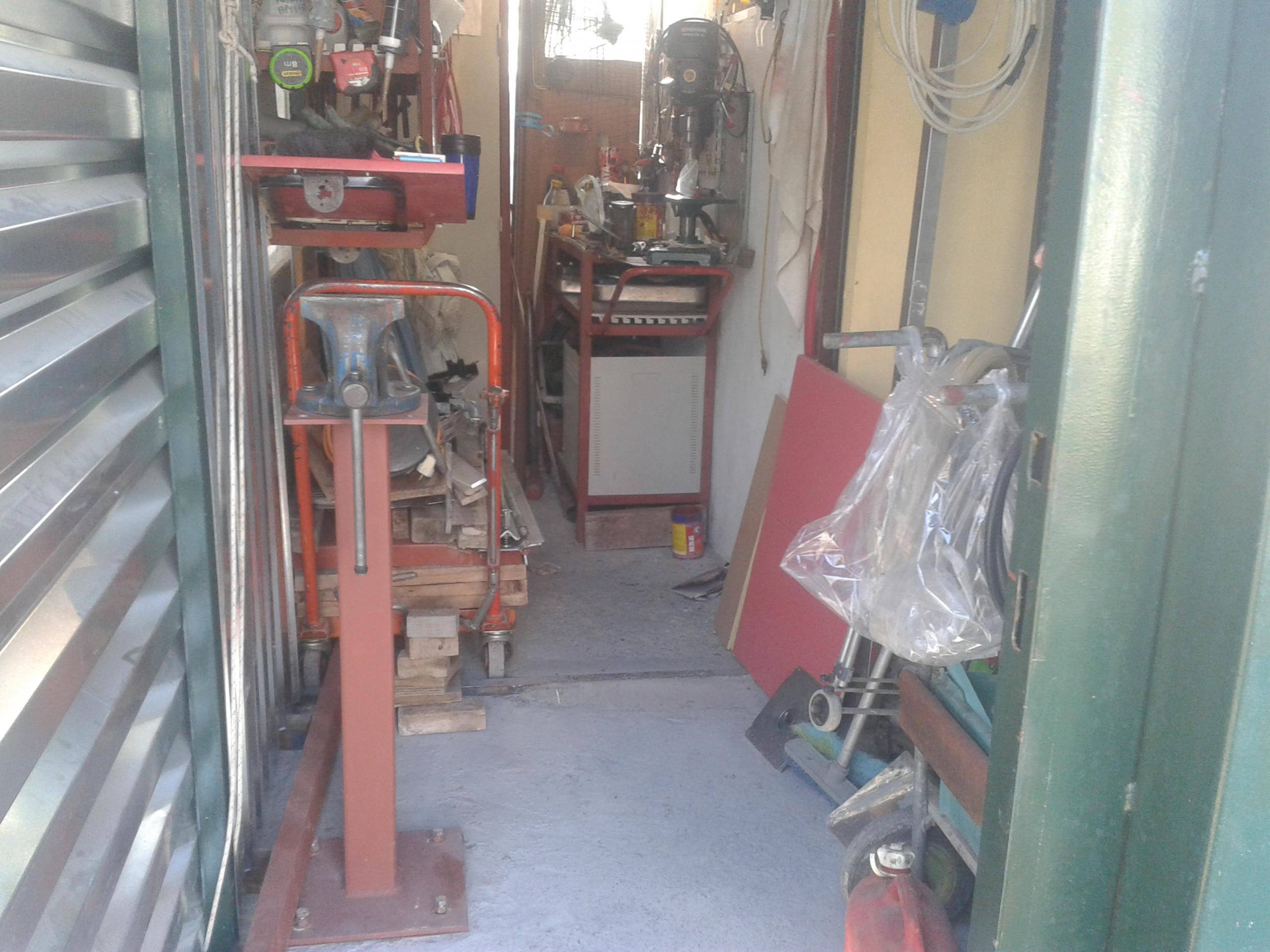

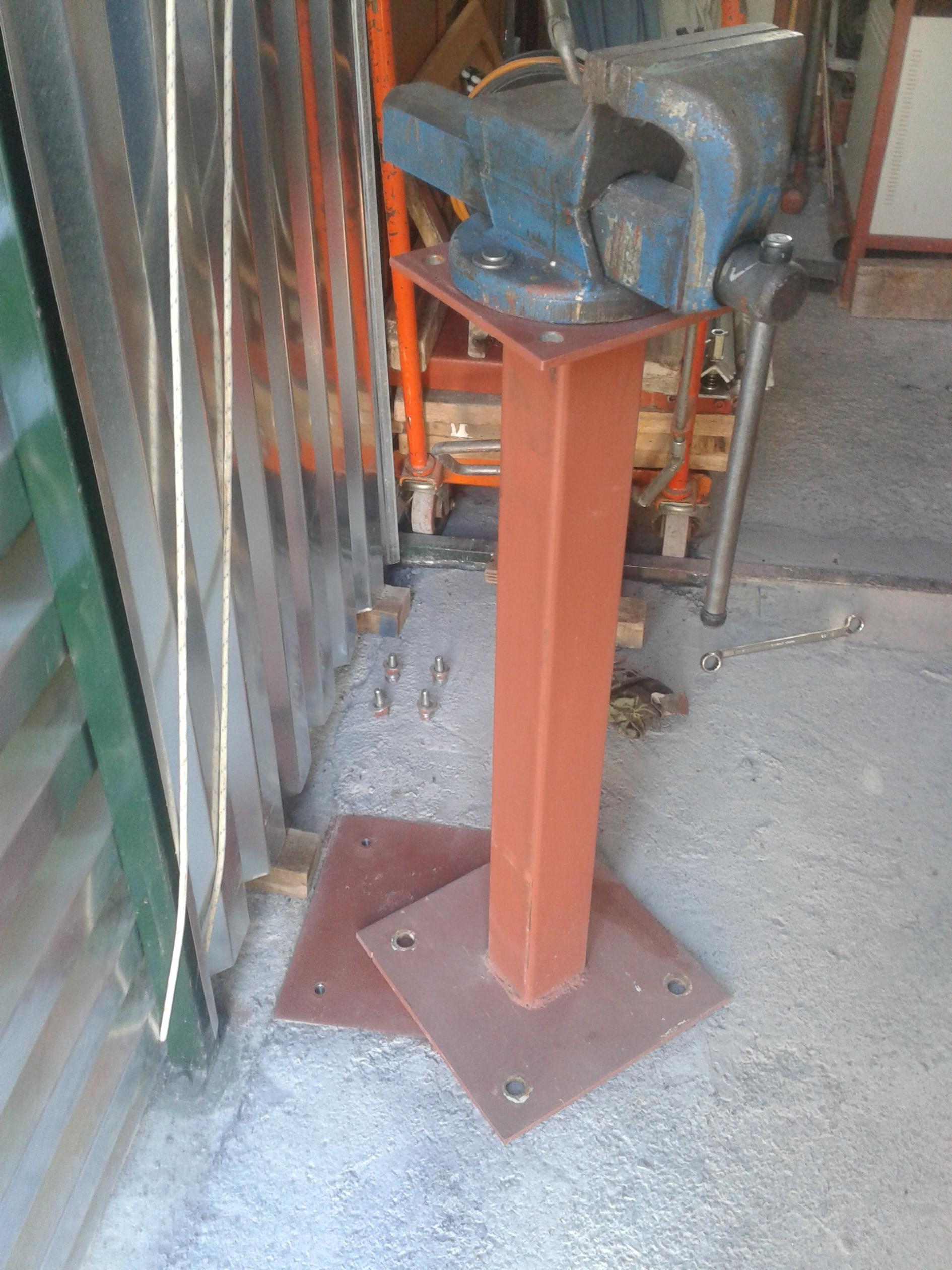

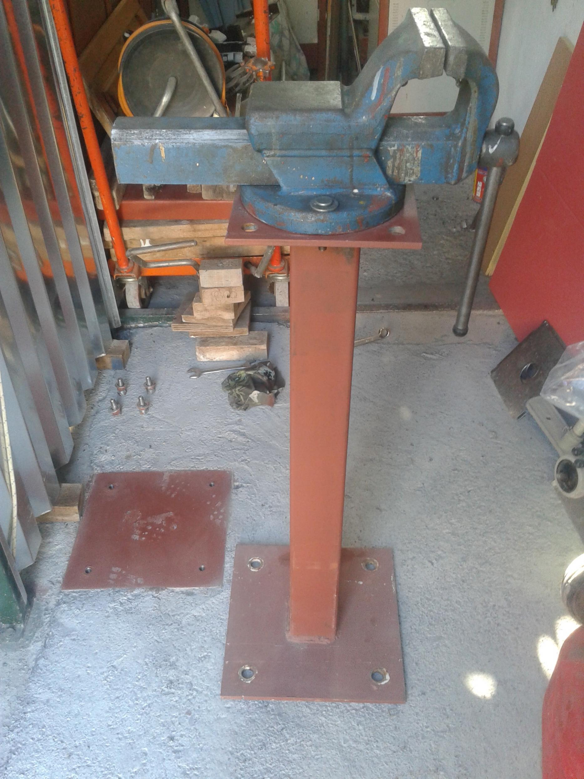

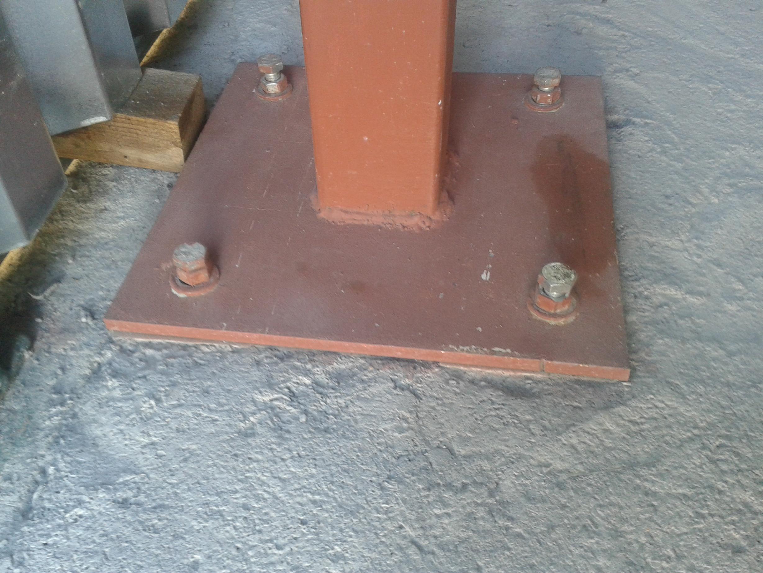

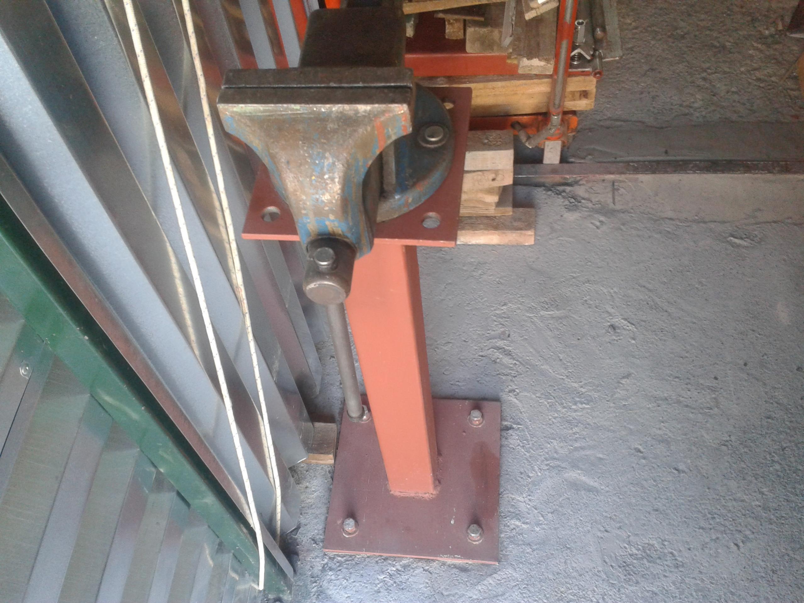

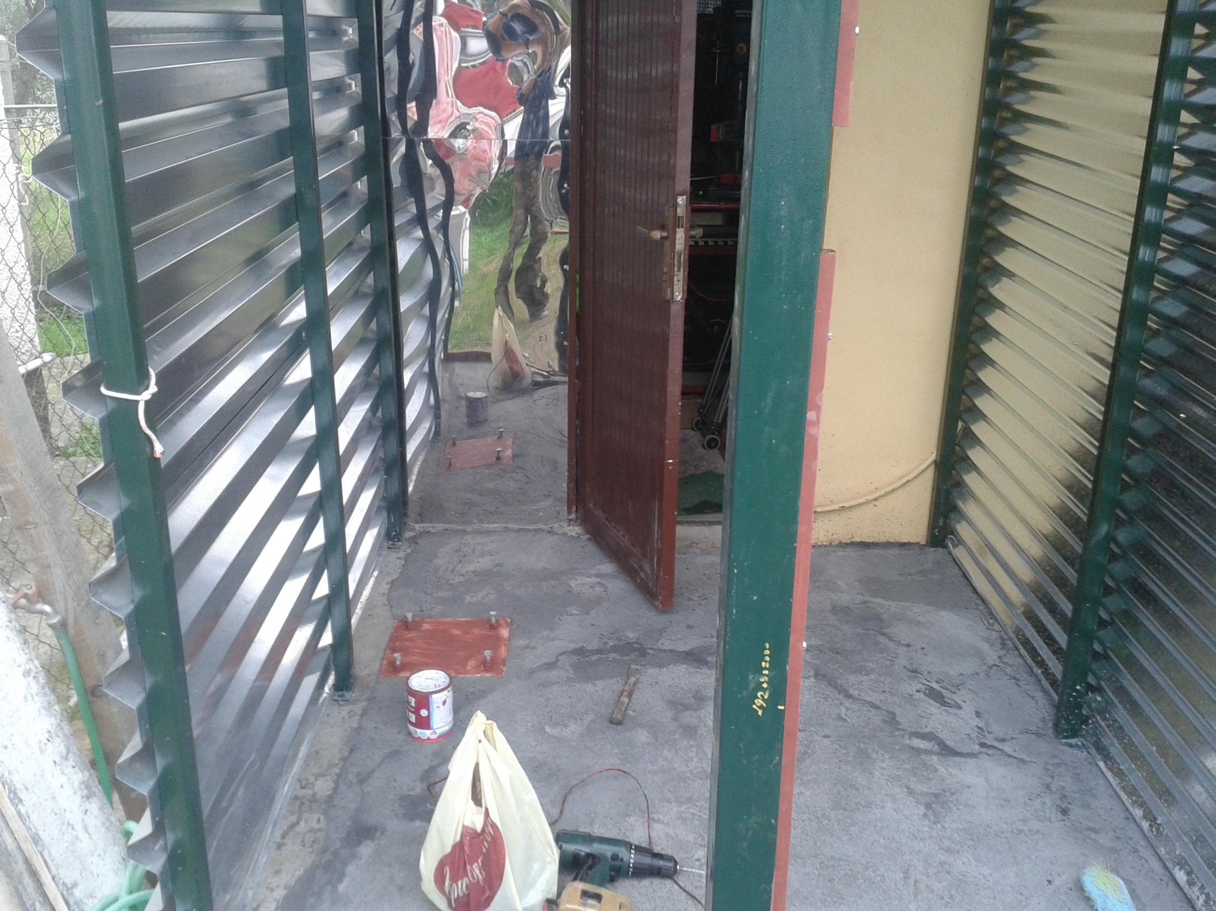

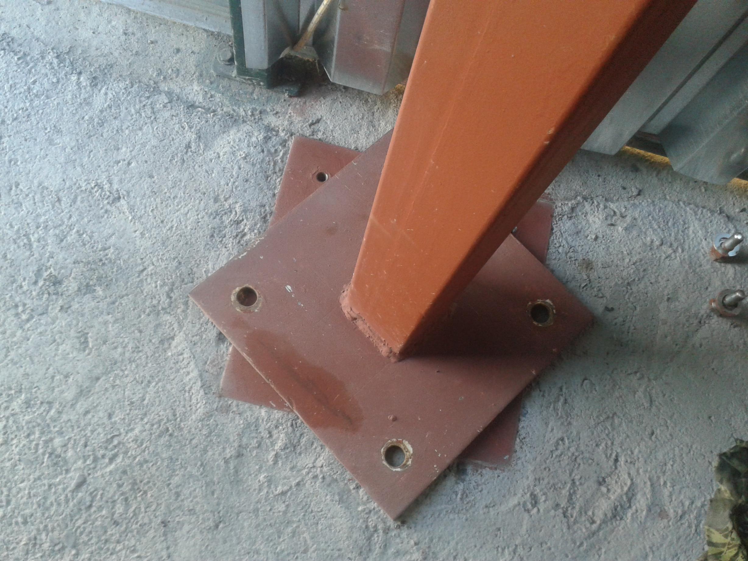

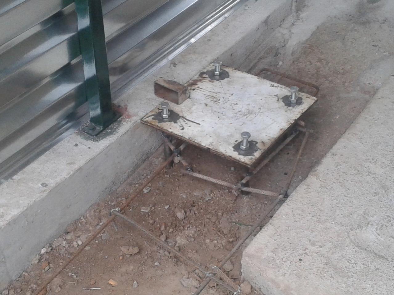

    Removable pole stands vise base made it from steel plates, round bar & tube
    Also can be mount at three pos left/right/front.
    Materials
    steel plates:.2pcs 300x300x10mm 1pcs 200x200x8mm
    round bar ø18mm : 4pcs 150mm
    bolts/nuts M12 4pcs
    tube 80x80x3 mm 800mm

    Looks like you could also use the base for a bench grinder and power buffering wheels.

    Hi Paul,
    Yes, you guess right.
    My homeshop is too small, and I search for ways to saving space.
    Bill
