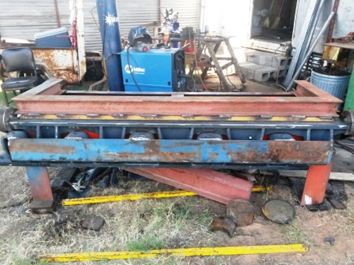

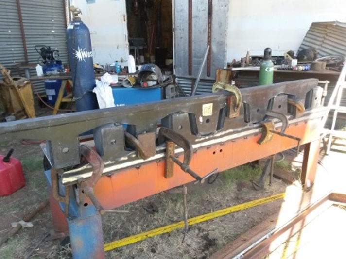

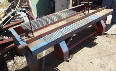

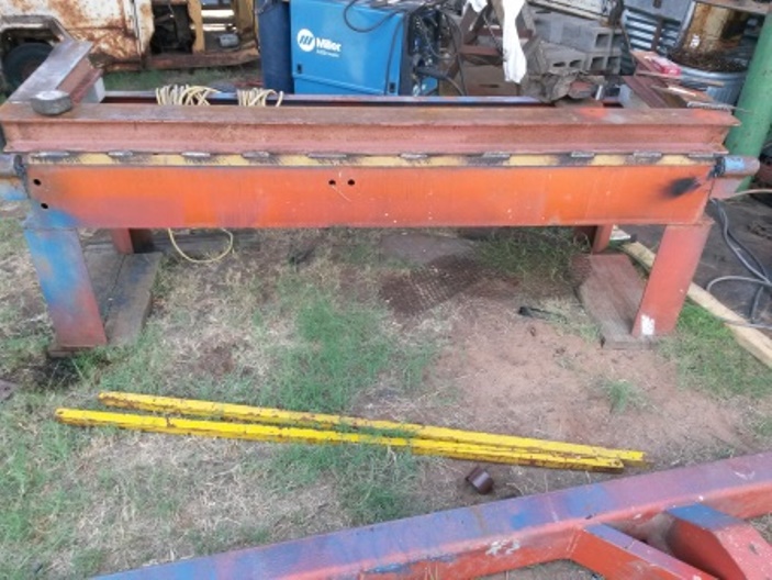

    this is not a new tool but it will hardly resemble the itself.
    I made this about 3 years ago to do 1 little job then after finishing the job it got put on the back burner for completion
    http://www.homemadetools.net/forum/7...0277#post57046

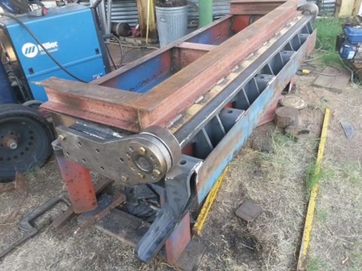

    So for the past month I have been time allowing making tools and parts to finish it up I still might not get it completed as much as I want but at least it is now far enough along to be considered work in progress plus it is right in my way which makes me more inclined to do some work on it .

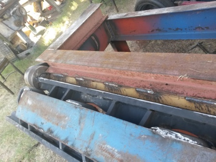

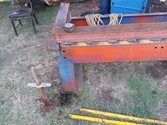

    As you can see it was about as rudimentary of a metal break as possible

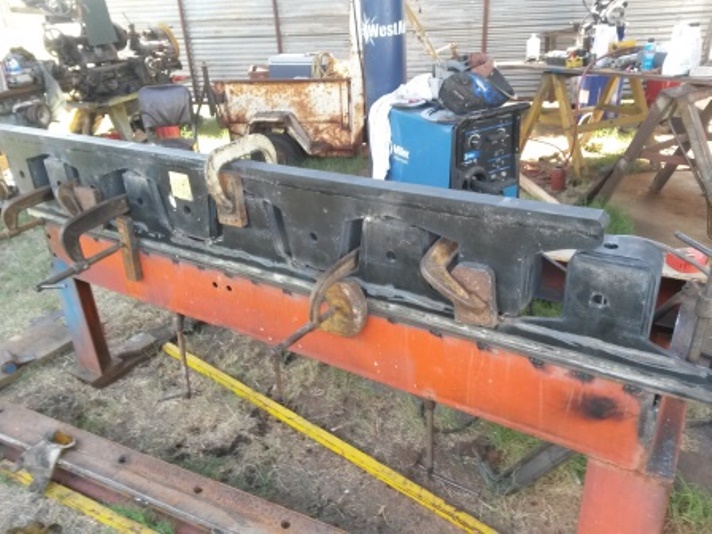

    So first things first the gate or swing beam had to go and a top clamp was needed
    then a new gate had to be made

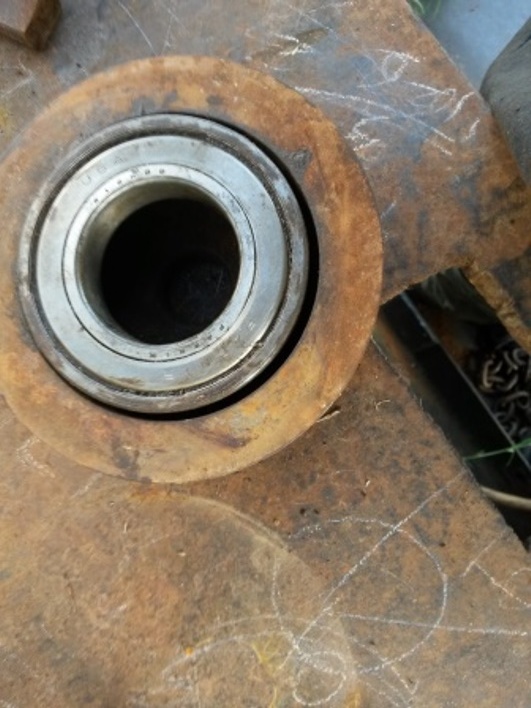

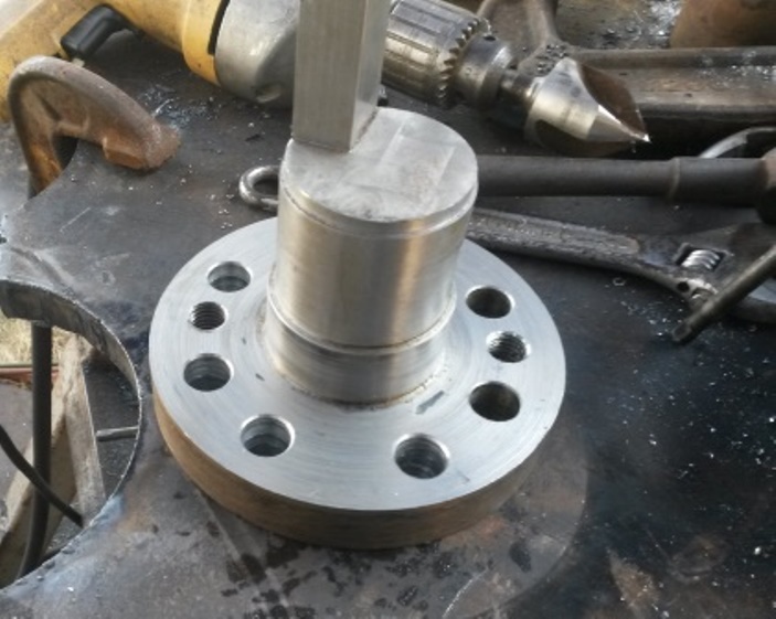

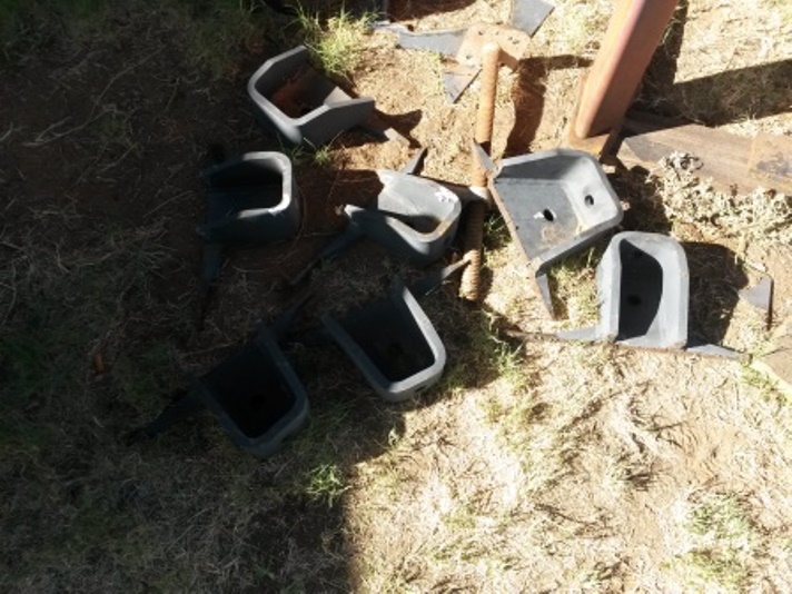

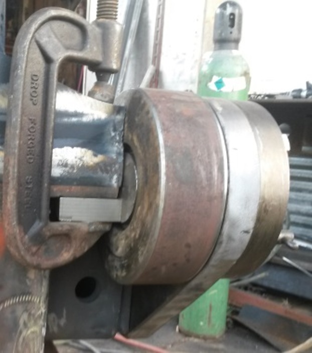

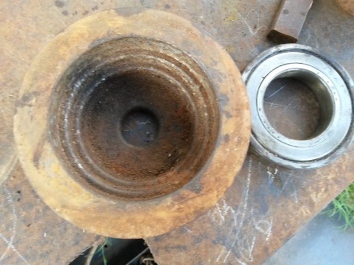

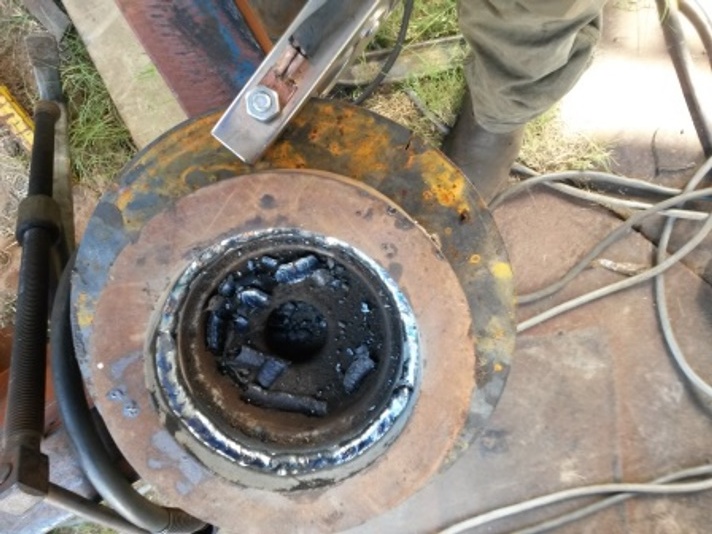

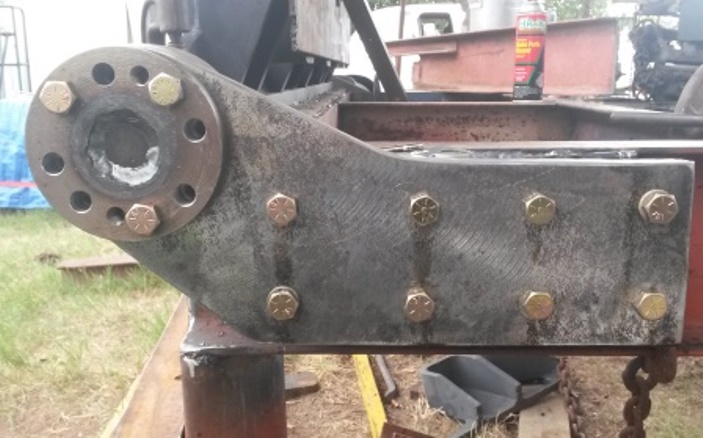

    next the parts for the pivot. I have a large stack of these I think they were once used as casting molds that a guy used to make small train wheels
    the bore was too large for my 6212 bearings so I welded them up then machined them out to the depth of 2 bearings

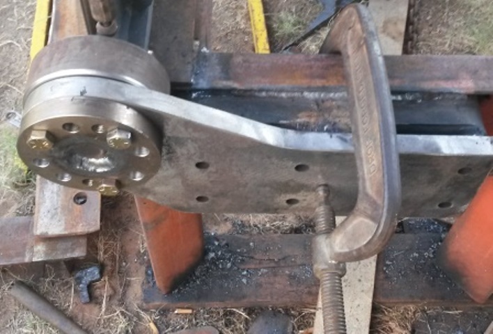

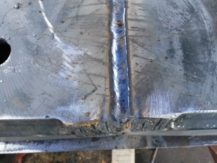

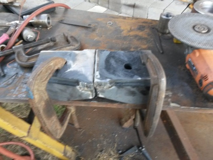

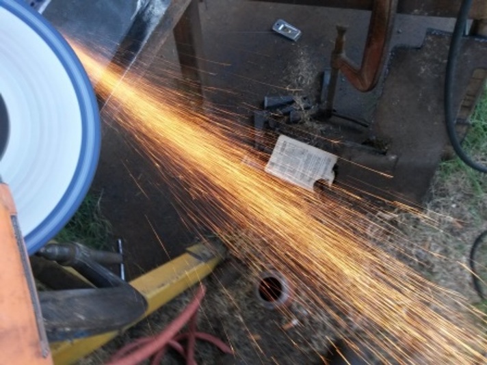

    Some left over cut offs from the Forklift carriage will become the mount base which the gate pivot mounts will bolt to
    you can see how tough Caterpillar metal is by the sparks at least 120,000 PSI tensile

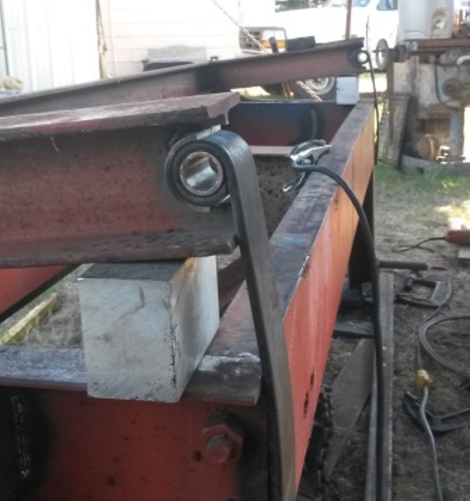

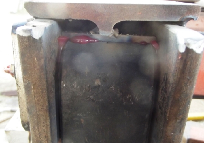

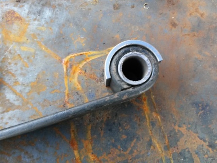

    I will be using the eye end of leaf springs for the top clamp pivot the reasons will be made clear in future posts

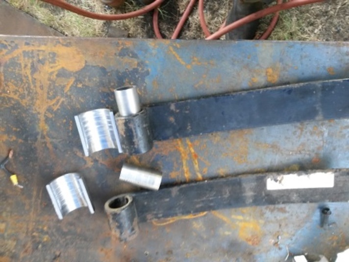

    first off I removed the urethane bushings and replaced them with a pair of hollow piston wrist pins that just happened to be 1/250" OD and 1.000" Id the half round pieces were made from 2 3/8OD oilfield pipe
    this is how they will be fitted together on the machine the half round will be welded in the end or the clamp arms then the arms will be plated with 1" holes for a pin to become the pivot.

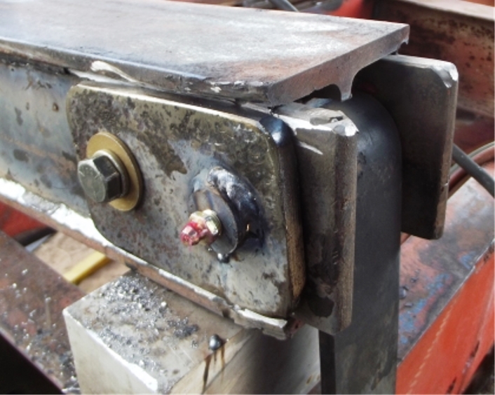

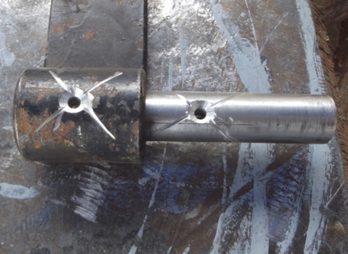

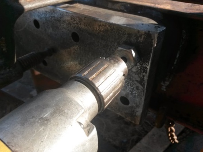

    With many other things to do I don't get to spend as much time working on this machine as I would like

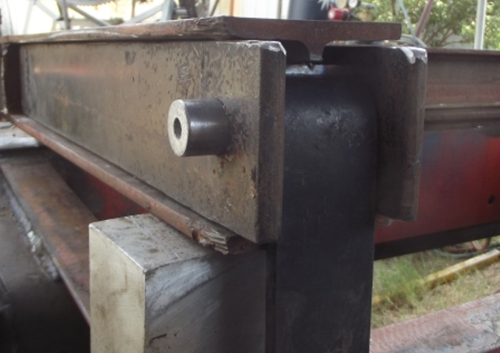

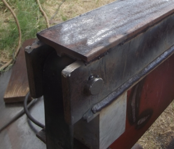

    However today I did manage to spend a little time on it. I now have 1 side of the main hinge for the top clamp complete and the other ready to assemble an dweld.
    I drilled and ground grease pathways in both the spring eye and the pivot shaft. since the shaft is fixed to the top clamp this makes the cup holding the spring eye and the pivot shaft rotate around the spring, which meant I needed grease both inside and outside of the spring eye.
    remake of my 7 ft folding break-dscf7505.jpg remake of my 7 ft folding break-dscf7506.jpg remake of my 7 ft folding break-dscf7507.jpg
    Kind of hard to see but grease was forced out both ends of the eye inside and out

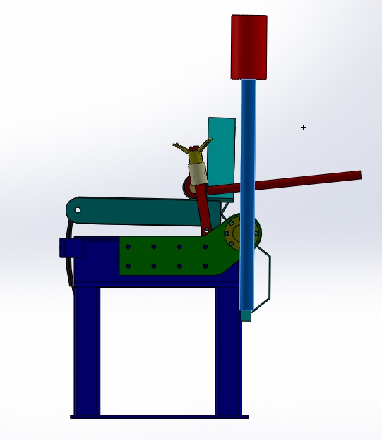

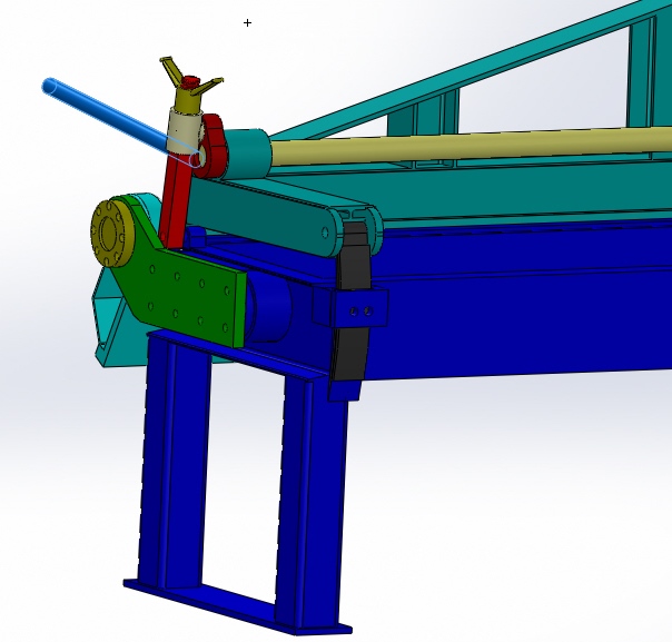

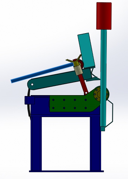

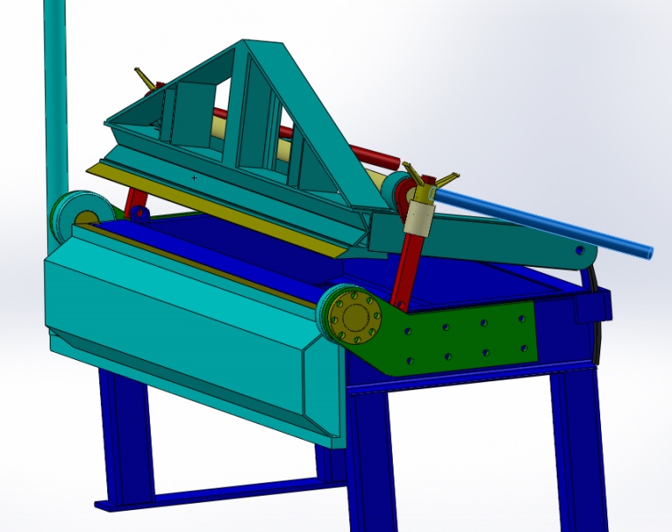

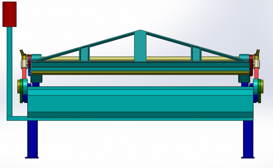

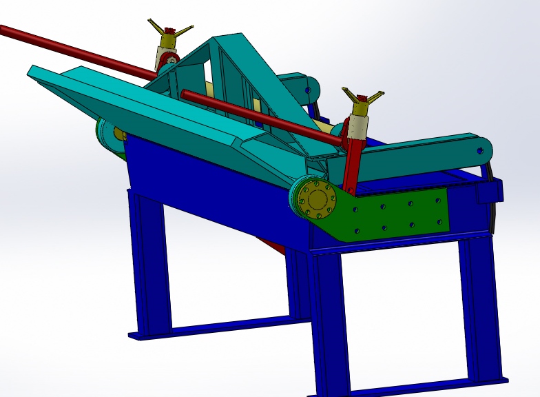

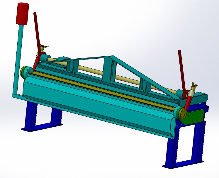

    I have the other side welded up now on to making the cam lock assembly for the top clamp. but I thought I would share some drawing pics of my design This is a close approximation of how it will look when completed
    And later on I may add hydraulics to it

    Looks like it will be a very rugged and useful break. What is the anticipated capacity?

    the target capacity of the machine will be around 10ga for full width but as much as 3/16" for half width or less But I will be happy if I can only form 10ga at 6ft wide sheets.
