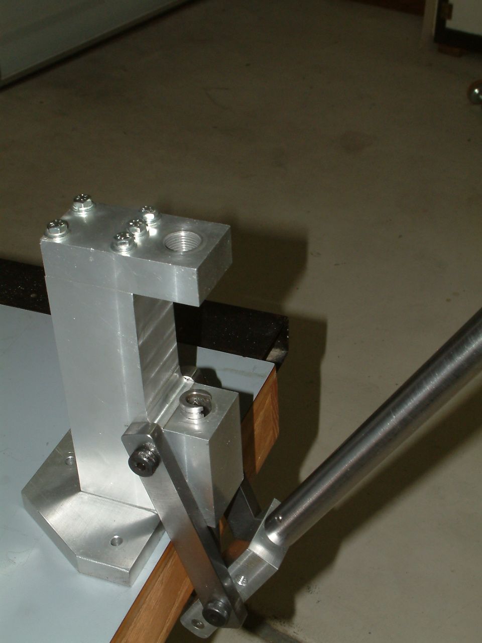

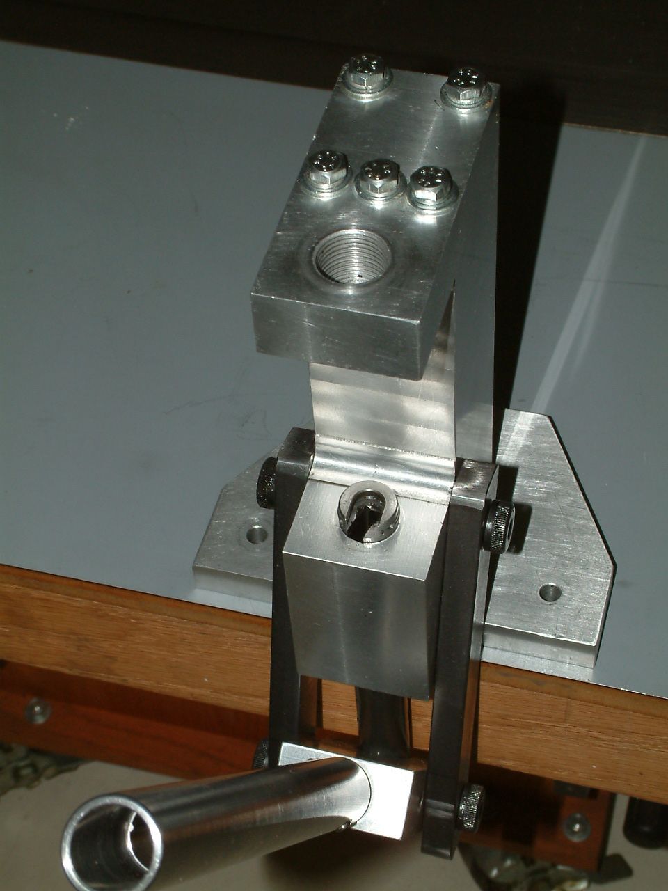

    This is a single stage auxiliary press that I use for reloading. It is rather tough so if I need to swage pockets I will go with this one. If I have to deviate from my reloading plan I can always set up this press and not have to alter my main press. I have also used it a bit to experiment with making some of my own dies. The head is replaceable so I could use dies other than 7/8-14 or even use it for pressing bearings etc.
    Mostly aluminum with two 1018 steel links. The handle was a piece of pipe from the scrap box. The ram was a find on eBay which saved quite a bit of time.
    It is for 7/8-14 dies.
    Cheers, JR

    Nice custom setup JR! Any issues with the AL and steel dies galling?
    Thanks for sharing! ~PJ

    jjr2001's Tools
    No problem so far but I don't leave the dies in the press for extended periods of time. If I do think there is a problem with galling or seizing with the aluminum I apply a bit of Noalox to the threads. I have a 16 ounce bottle that I used 40 years ago for the aluminum wiring connections in my old house. I took every wire nutted joint apart and put a dab of it into every one as well as all of the screw connections in every outlet and circuit breaker. I do not like aluminum wiring in the house. The new house 1992 ( if that is new) has copper wiring. I still have 85% of that bottle of Noalox (made by Ideal) and use a dab every once in a while.

    I'd probably use a light coating of anti-seize compound $6-10 for a lifetime supply, The Noalox works because you have a lifetime supply but it has silicone dioxide in it and not sure how it would react with the hard dies?

    Great idea with the anti-seize. I actually have a small tube of that for my bullet molds. I will try that next time.
