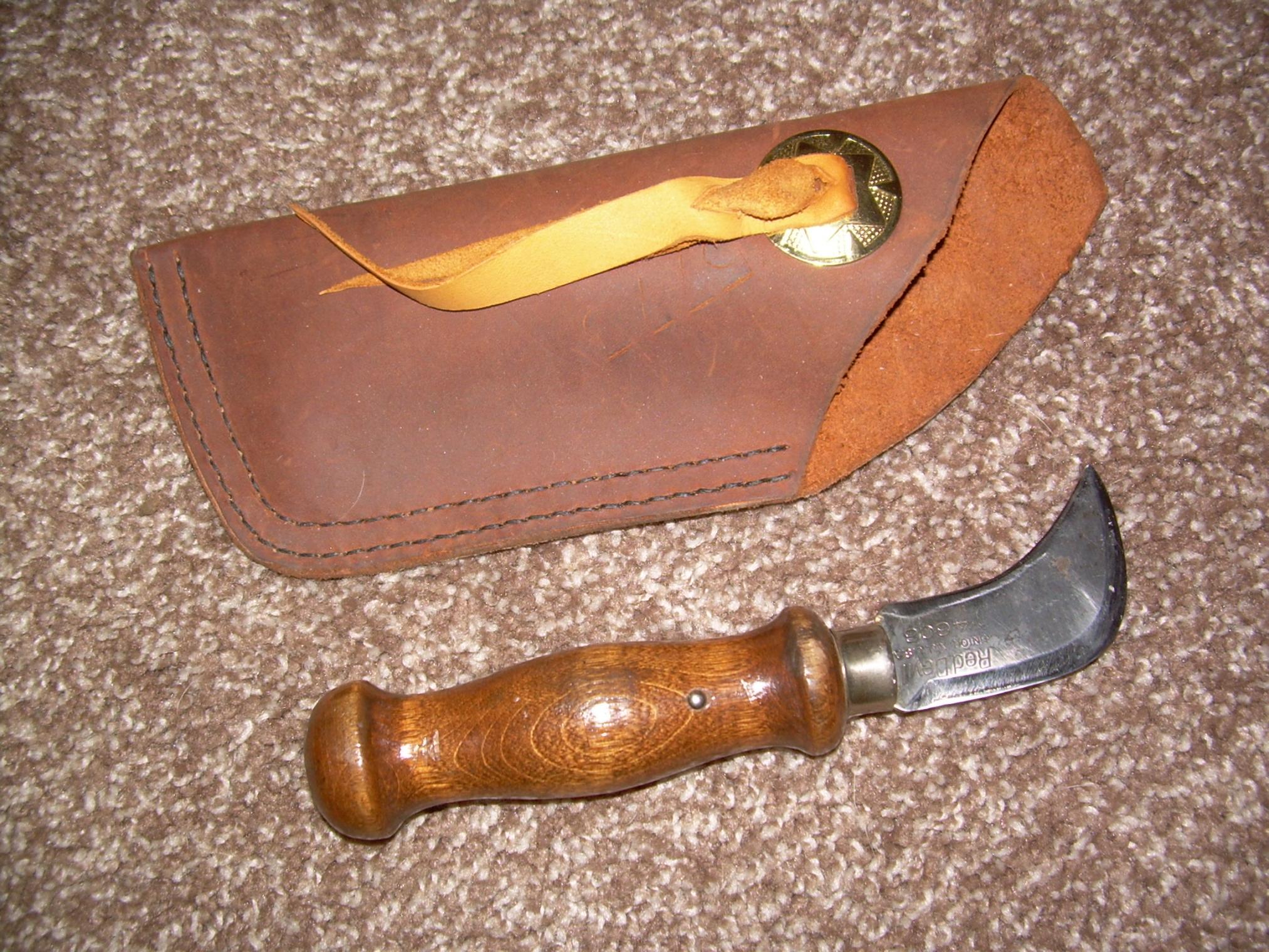

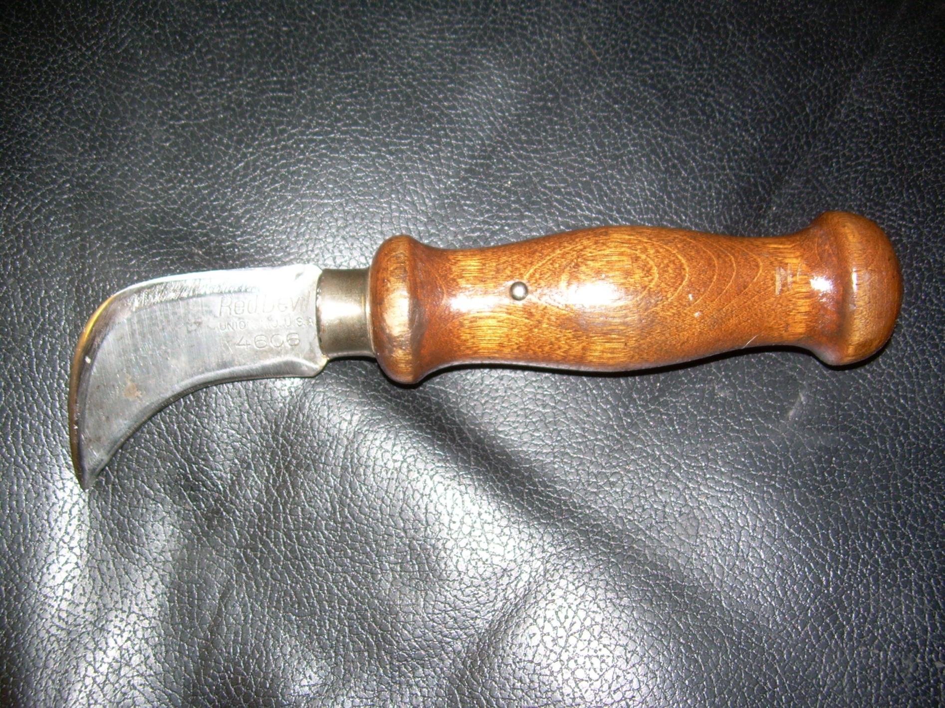

    Red Devil leather cutter
    I was looking at my Red Devil sheet vinyl cutting knife and had a brainstorm. I thought if I sharpened the other side of the cutter I could use it as a leather skiving and cutting knife. Took the tool over to the sander and set a bottle of water for cooling next to the sander and started sanding away the excess metal in order to get a cutting edge on the back side of the knife. Got it sharpened and boy what a cutting tool it is now. Handiest leather knife I have used yet. It woks slicker than a whistle. If you decide to make one yourself be sure and keep the blade cool, you do not want to draw out the temper of the metal and ruin a good knife and be careful, because it is sharp on both sides when you get it sharpened. Red Devil leather cutter-leather-more-018.jpgRed Devil leather cutter-leather-more-017.jpg

    Thanks for this. We seldom have the half-moon skiving knives donated, for us to send to Africa. With your permission, I would like to send this picture to the administrator at the charity, Tools for Self Reliance, since we get plenty of these vinyl knives and it is easy to adapt them as you have done.

    By all means share this with as many folks as you want. Glad to be of help. I have been using this modified tool for leather work and I love it for its versatility.
