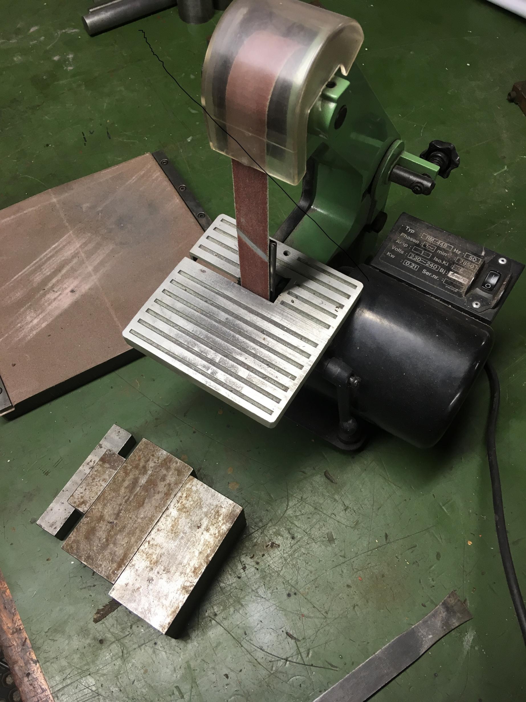

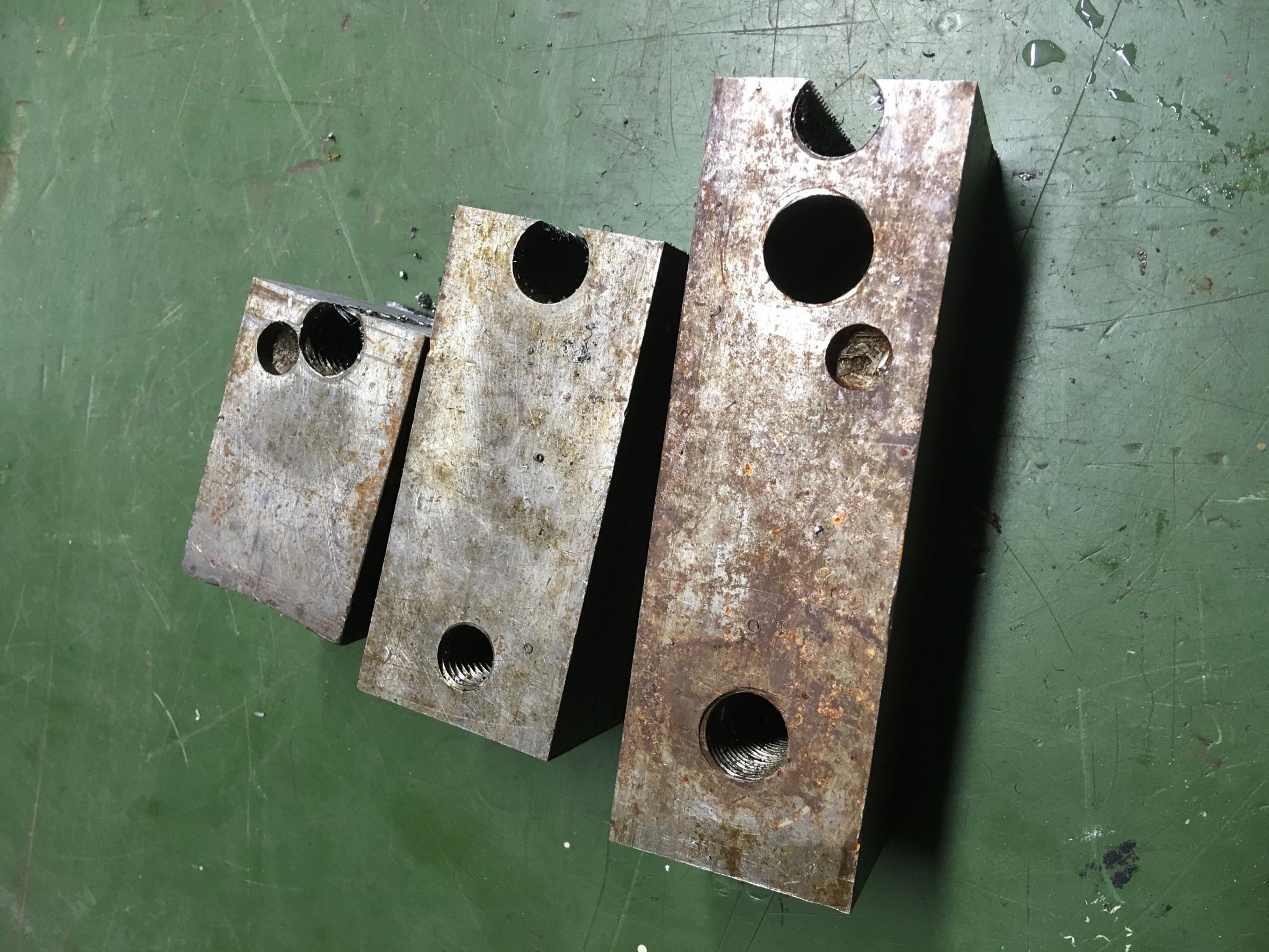

    I called a local material stock holder who is very well priced. Well I had bit of a shock when getting a quote for some mild steel bar, for a project I wanted to start. After checking out prices else were the prices quoted were very competitive but out of my price range. So, after waiting a couple of months a piece of material turned up in a skip the exacact size I required. So, dragged it out (a bit rusty and had quite a few holes drilled in to it) but I was so happy with the find, As can be seen from the photos I was able to cut the pieces require for the project, missing the previously drilled holes in the bar.
    The piece of bar is 50 x 50 by about 600mm long bright mild steel. grade unknown. The price of a new 3m length, I was quoted £200.00 + vat (well I nearly fell of my chair, good job I didn't have my head in a skip I would have fallen in lol, I honestly thought they had made a mistake.) I was expecting a price of £40/60 + vat.

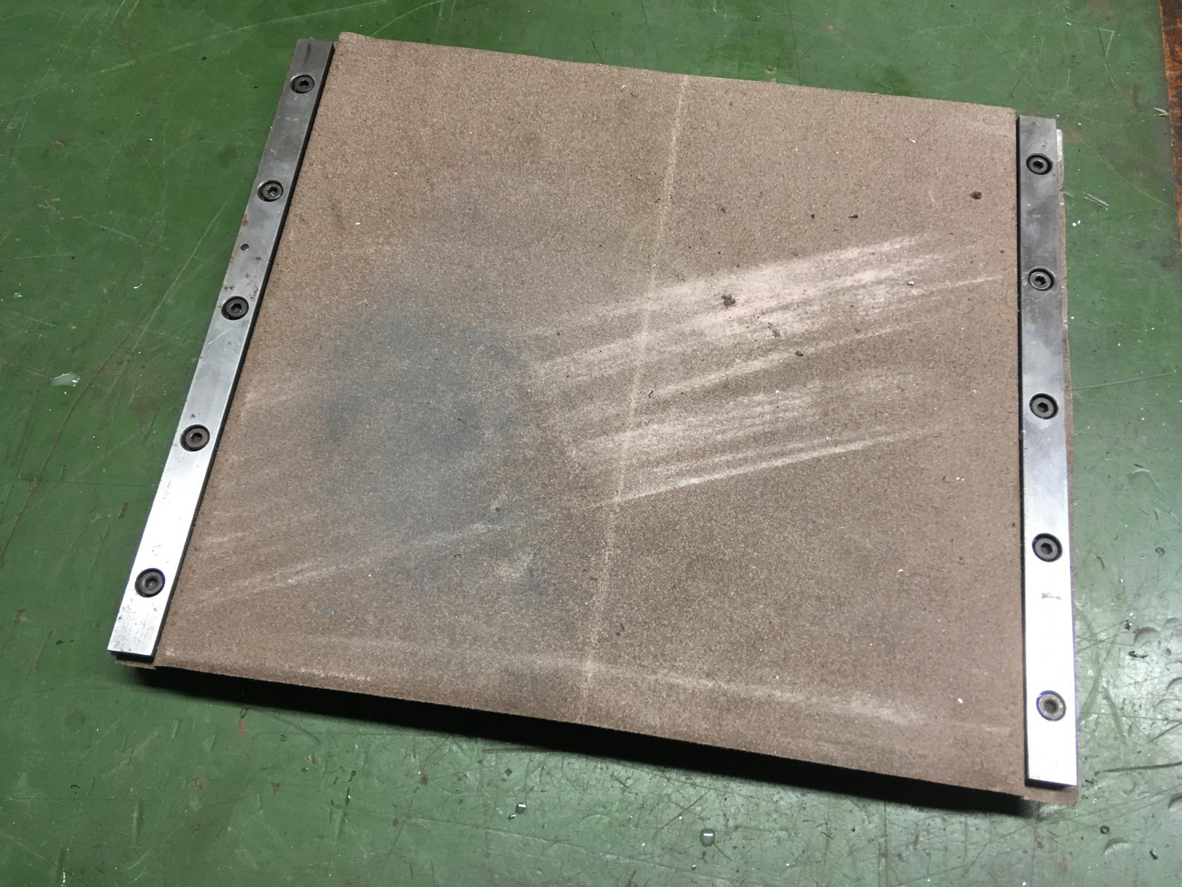

    Here are some photos of the find, and how I cleaned the stock faces up on a home made lapping plate which holds an emery cloth taught on a flat steel plate. The 1” linisher is used to de-burr the sawn ends and the lapping plate removes any dings and dents that might be present on the bar. I do this even to new stock material as you can’t guarantee the bar has not been damaged from the stockist and I dont want to transfer the dents from the material on to the machine vice or machine table.

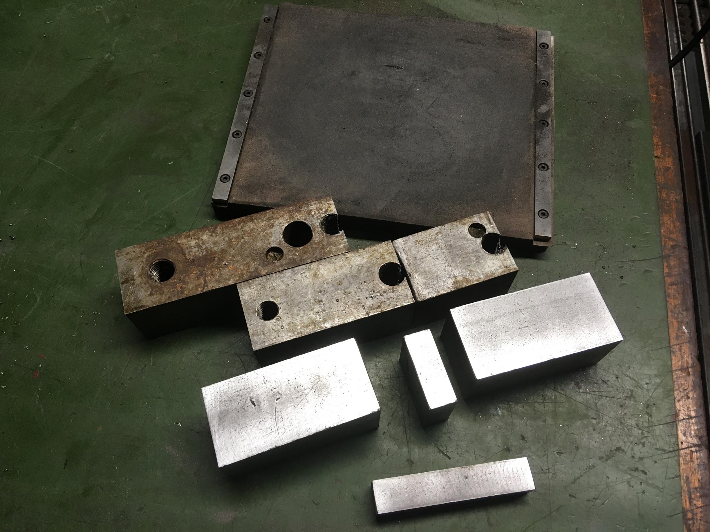

    As can be seen once cleaned up a big money saver and still have a few cut offs left over for other projects.

    Attachment 21796 linisher

    Attachment 21798 Required material cut and de-burred ready to used and the remaining offcuts

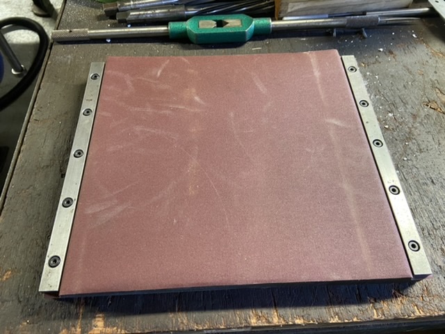

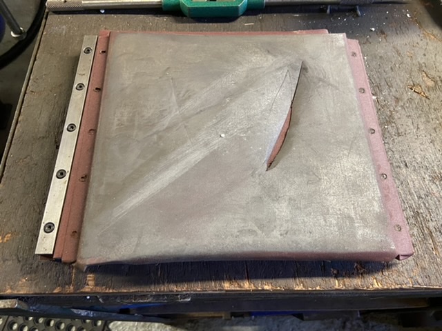

    There is nothing like putting a new sheet of emery cloth on to the lapping plate. It’s like getting in to a bed with fresh bedsheets .
    Recycled steel if you can find any.-42f60d33-57bd-4429-8dff-706f346702eb.jpegOld sheet been removed.
    Recycled steel if you can find any.-006dc855-395d-4edc-b2d1-e628413ebce3.jpegNew sheet ready for action
