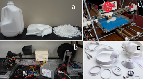

    Recyclebot
    Purpose - A low-cost, open source, self-replicating rapid prototyper (RepRap) has been developed, which greatly expands the potential user base of rapid prototypers. The operating cost of the RepRap can be further reduced using waste polymers as feedstock. Centralized recycling of polymers is often uneconomic and energy intensive due to transportation embodied energy. This paper provides a proof of concept for high-value recycling of waste polymers at distributed creation sites.
    Design/methodology/approach - Previous designs of waste plastic extruders (also known as RecycleBots) were evaluated using a weighted evaluation matrix. An updated design was completed and the description and analysis of the design is presented including component summary, testing procedures, a basic life cycle analysis and extrusion results. The filament was tested for consistency of density and diameter while quantifying electricity consumption.
    Watch video on recycling plastic with 3-D printing:
    For more information on versions and other type of RecycleBots, go to:
    Recyclebot - Appropedia: The sustainability wiki
    To download the paper:
    Distributed Recycling of Waste Polymer into RepRap Feedstock | Joshua Pearce - Academia.edu
