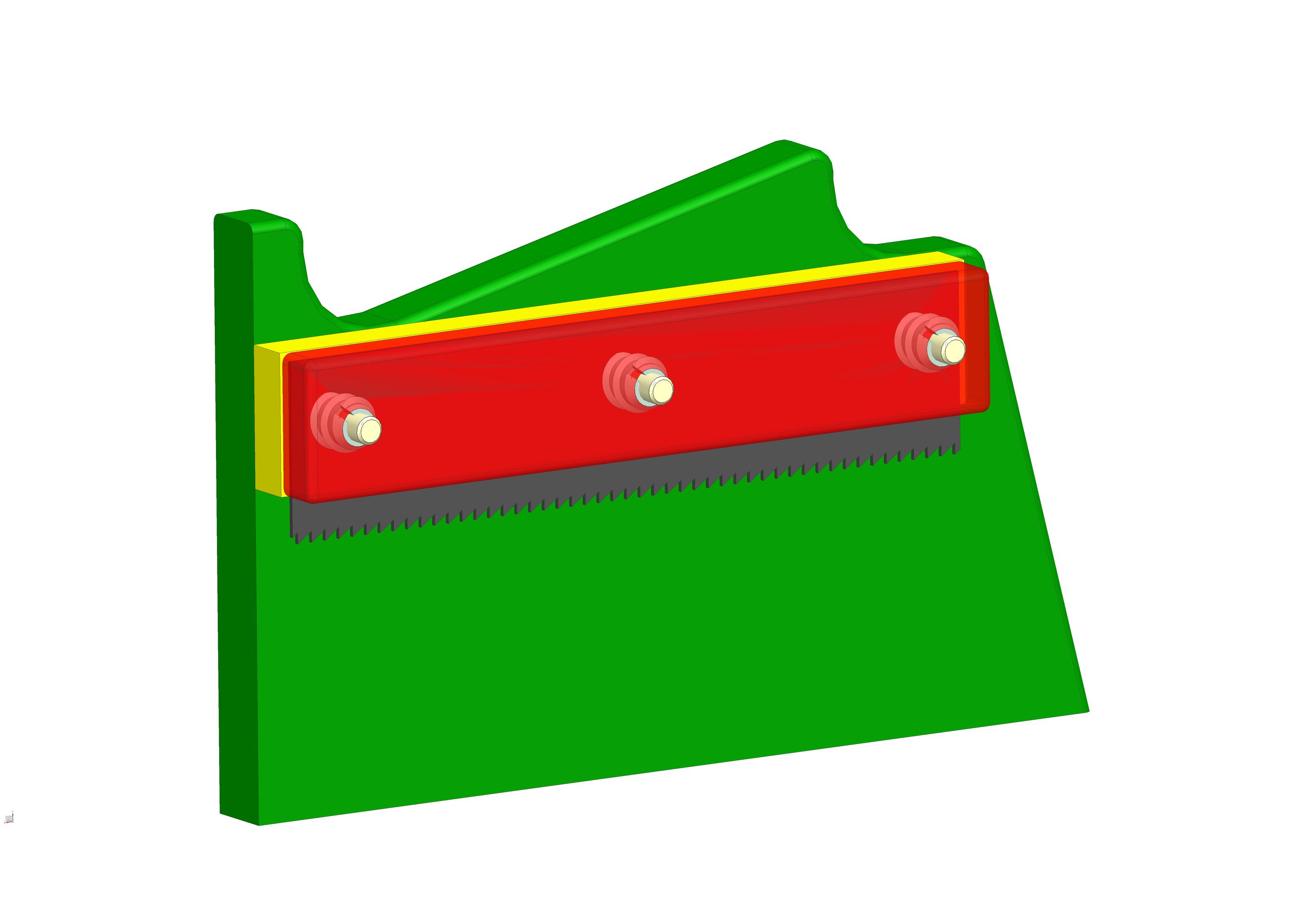

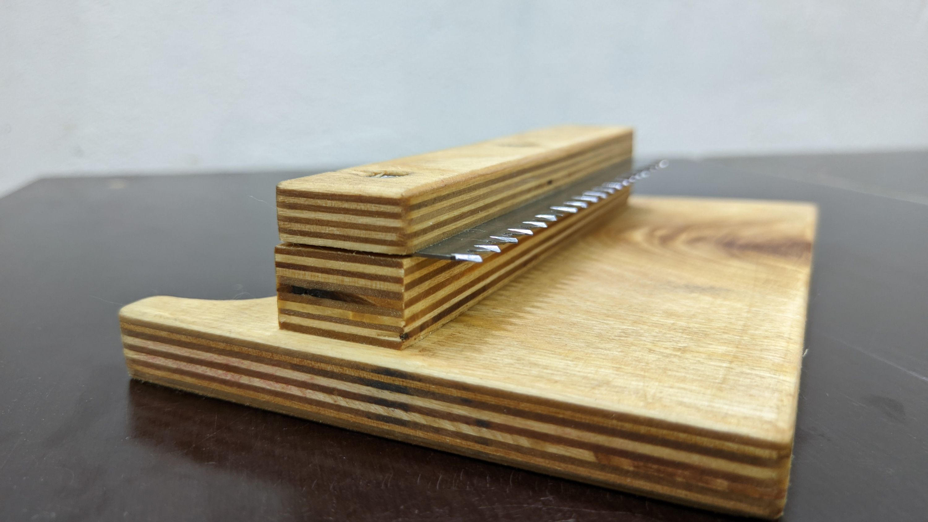

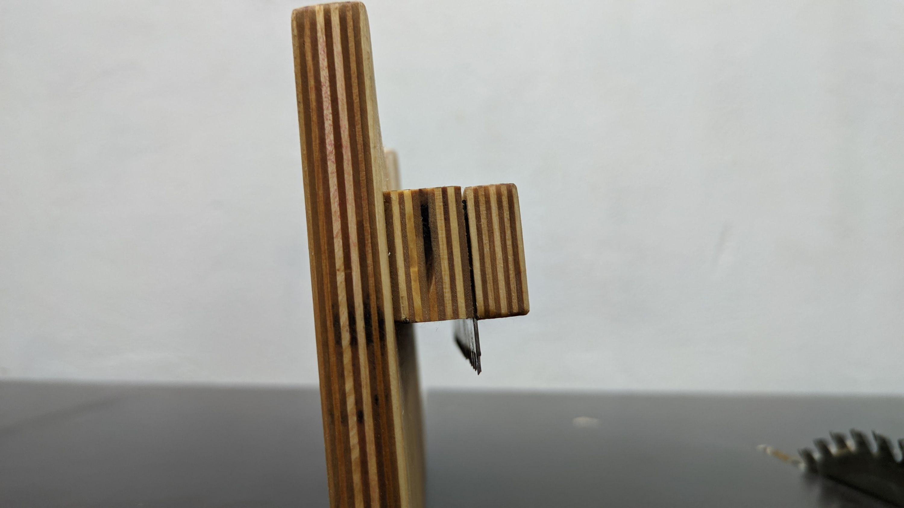

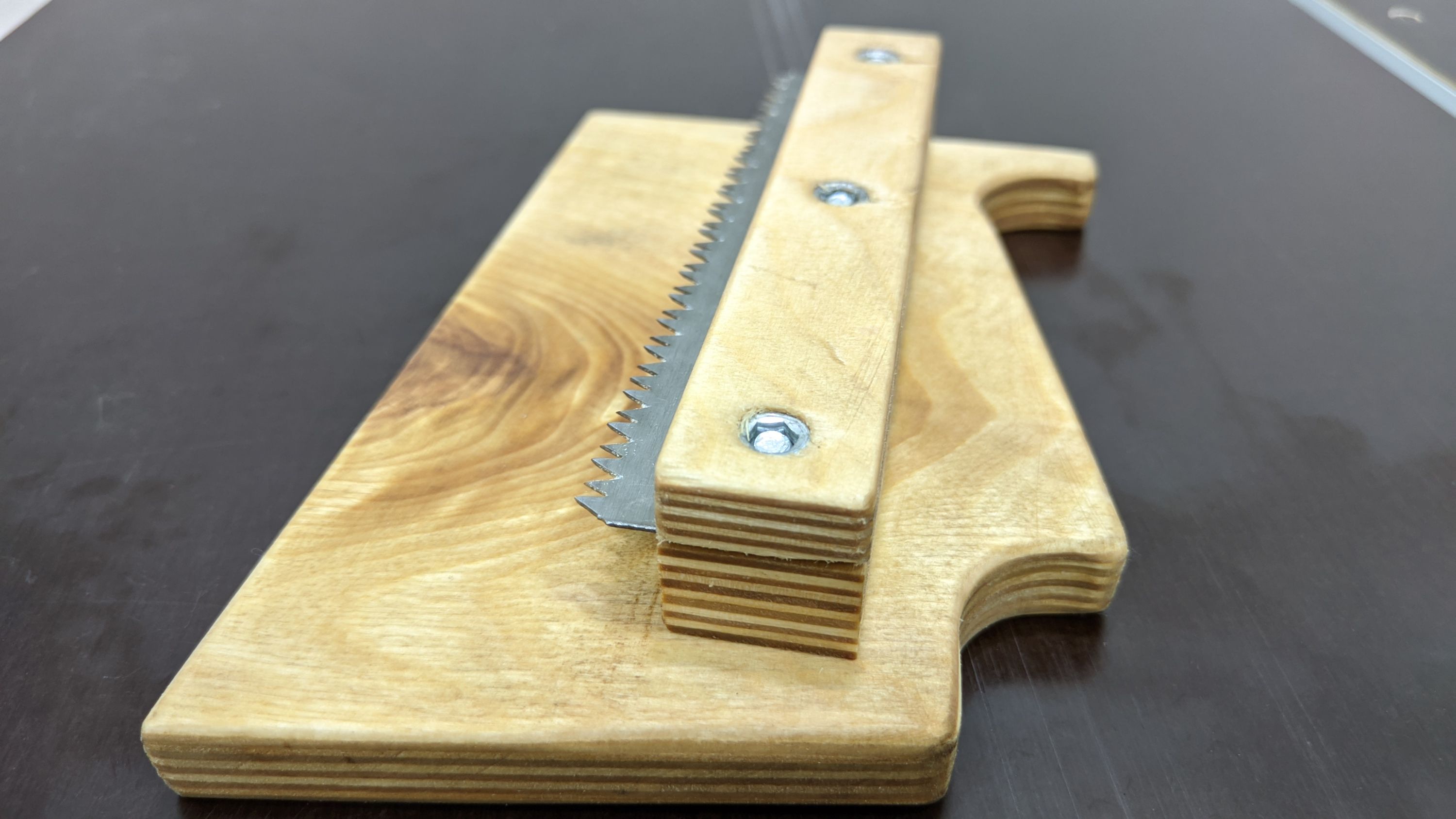

    Rebate Plane for Perfect Resawing wood by Hand

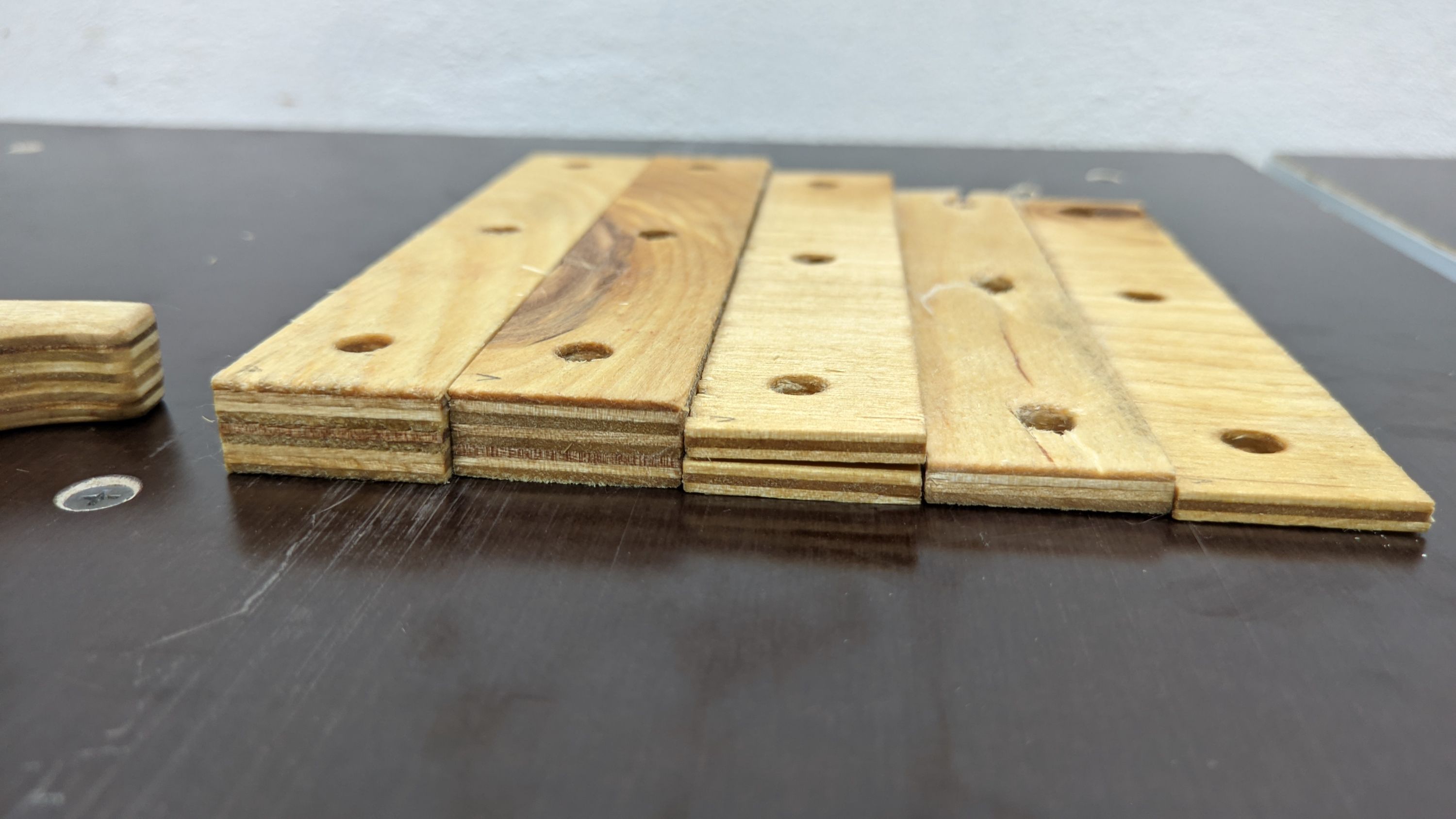

    Planks of different thickness allow you to set the thickness of the cut part

    Plane? NOT!
    Rebating saw? Maybe.
