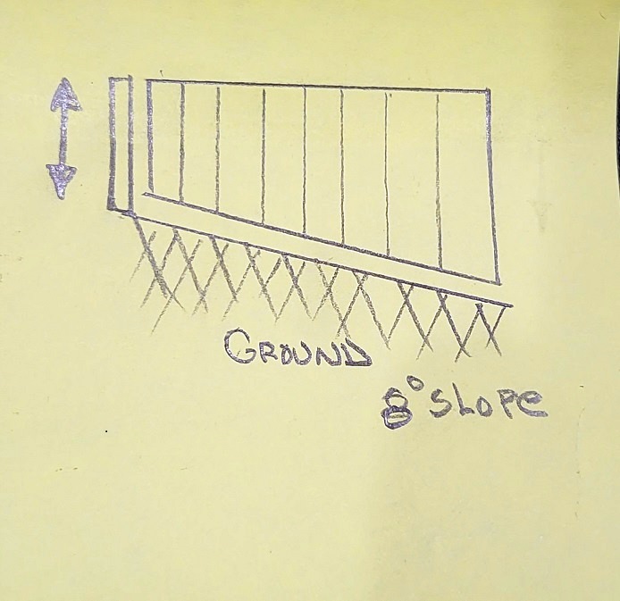

    Thank you Buffalo John for your interest to help, n another words behind the gate it is not level it has an inclination of eight degrees. If you want to open the gate it will not open all the way these hinges are offset to give the inclination the gate needs from the inclination of the floor. i hope that I am making myself understandable.

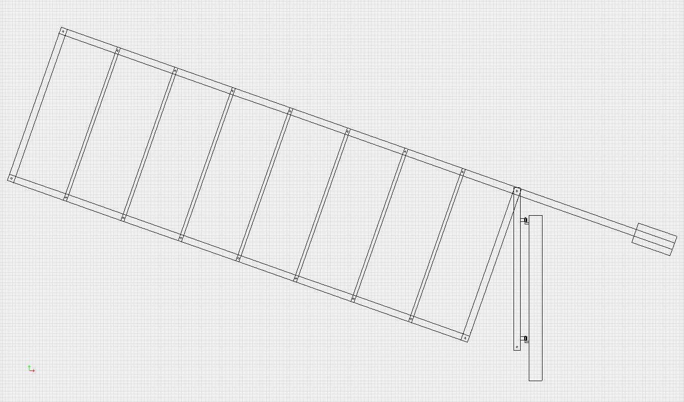

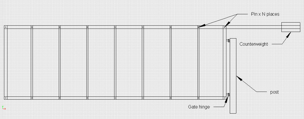

    Here is a fairly simple gate design:

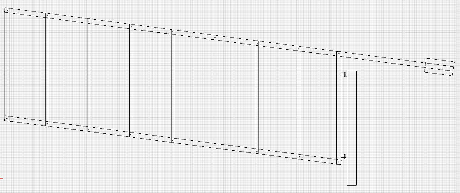

    Then when you push down on the counterweight, it raises like this:
    That angle is 7.5 degrees. There are pins to let the gate swing about the post. You can make the pins be parallel to the opening or at an angle if you want the gate to move more out of the way.
    I did it as a 12' gate 4' high - just to get the perspective correct for the drawing.
    The rest of the solution is left to the student...

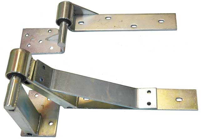

    I've done this before by just offsetting the vertical axis of the pins. Both to make it rise as it opens to clear a slope, and one way I used to make a gate self closing without need for an additional mechanism. If you have a 5* rise, kick the pins 5*, but you'll need a way to hold it open when desired.

    I believe he wants to keep the top level as it rotates. In this scenario the long edge of the gate will hit the ground upon rotation. Perhaps a cam-like (or ramp like) action would lift the gate keeping everything level.
    Baddog, do you mean angle the hinges 8 degrees from the vertical axis?

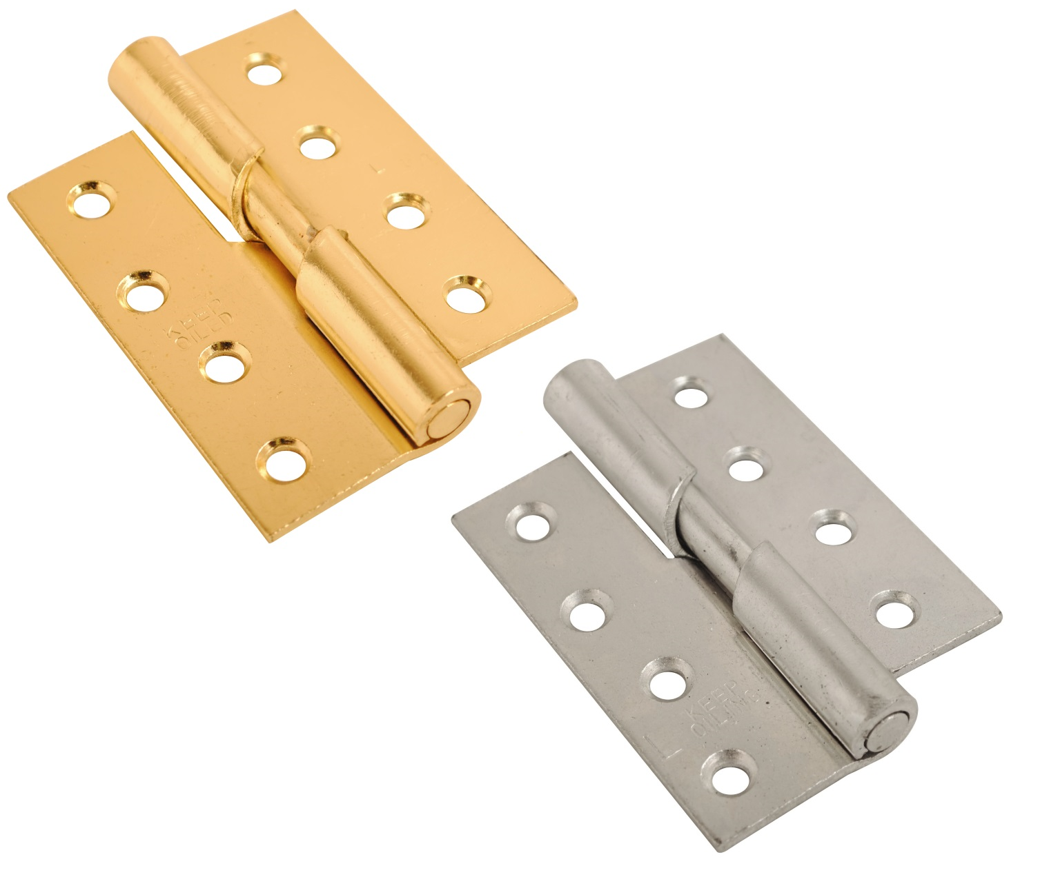

    Edit: I found a couple of pics. The caming action I mentioned and offset pin idea posted by Baddog.

    Those hinges show 2 ways I've achieved that. The first style is only for small amounts of rise, and uses the ramp to encourage closing. But mainly it just allows the door to be closer to the ground when closed, and only works well when clean. More for a door than gate, certainly not a big gate. The one I did that on was a man gate, was much heavier than that, and only the bottom had the ramp.
    The second is what I was talking about. But you have to offset the axis, not just the pins. Both pens remain on the single axis of rotation. The gate is a relatively rigid rectangle, so if you have the hinge axis kicked N degrees as shown, then when the gate is in line with the axis kick out, the bottom of the gate will have N angle to the ground.
    But you may need to put a control system of some sort on the gate. I did one like that at my old house for a pretty heavy steel man gate, and it shut like the gates of hell if released from about 45*, but could be easily parked with minimal restraint at ~90*
