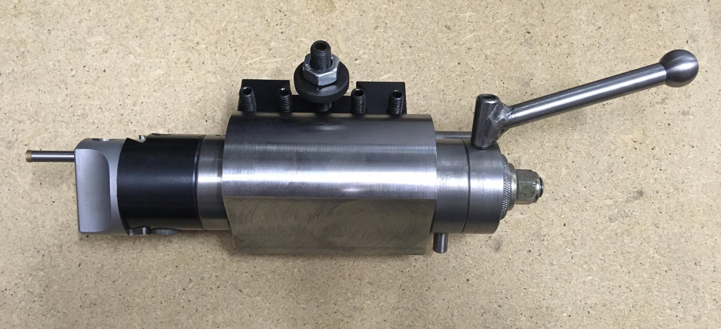

    Here’s a “ball turner” I made that uses a 50mm boring head. The materials used are all off the “That will be good for something.” shelf.
    I’ve used a couple of sealed bearings, and I made the main body fairly heavy which seems to soak up vibrations.The cutting tip is 6mm diameter. The first job it was used for is on the end of the handle.
    Seems to work well so far.Radius machining apparatus.-aeb3a145-c03c-4c26-b5f1-85682809c352.jpg
