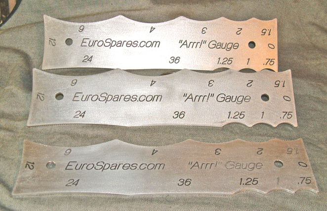

    These radius gauges are sold for use in metal shaping by various people. I think the original gauge may have been done by Fay Butler.
    I wanted one and since I have a CNC mill I decided I'd draw up and make my own. I ended up making a small batch (7 ea) since I had to buy a length of aluminum bar, and they made nice holiday/birthday gifts for some gearhead friends of mine.
    I called them "Arrr!" gauges because who doesn't like to talk like a pirate?
    I don't have any photos of them on the mill. The two 1/2" holes were for hold-down studs during machining, but they could also let the gauge be hung on a nail on the wall.

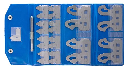

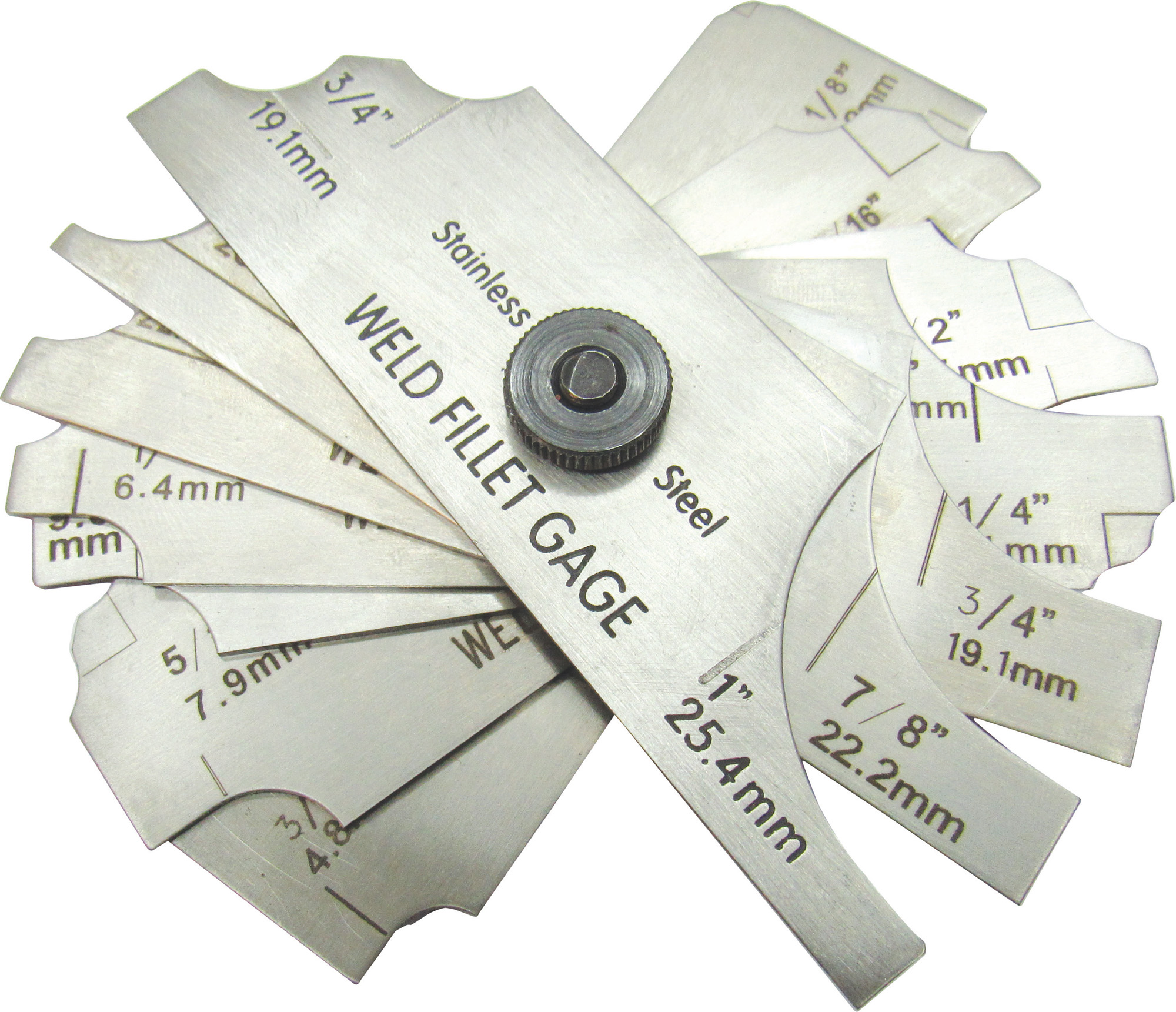

    I used to have a set of radius and fillet gauges which had both concave and convex surfaces for checking weld sizes very handy to settle a dispute over weld size

    Something like this?
    I've got those in both metric and inch versions and they are very handy, but they only cover smaller sizes of radii. I took a length of scrap AL round bar, about 1.75" or so diameter, and made as many different OD discs out of it as I could, with a hole in the middle of them to string them on a piece of soft wire. Those let me do some checking for radii a bit larger than the machinist sets cover.
    The gauges like I made are commonly used for checking a radius on a body panel. If you are extremely serious (or a designer at an auto manufacturer) you might have a set of sweeps like this 85 part set for $3000 from Fay Butler

    Mine were Starret but similar the weld gauges looked like this

    Here's a PDF of the basic gauge. It is 16" long by 3.8" tall and I think the PDF should be to scale. All I did to create it was to make a number of circles and fit them to three sides of a rectangle, and then trimmed everything and put a radius on the sharp corners. That should give you an example to help you to lay out a metric version.
    I hope that is of some assistance to you.
