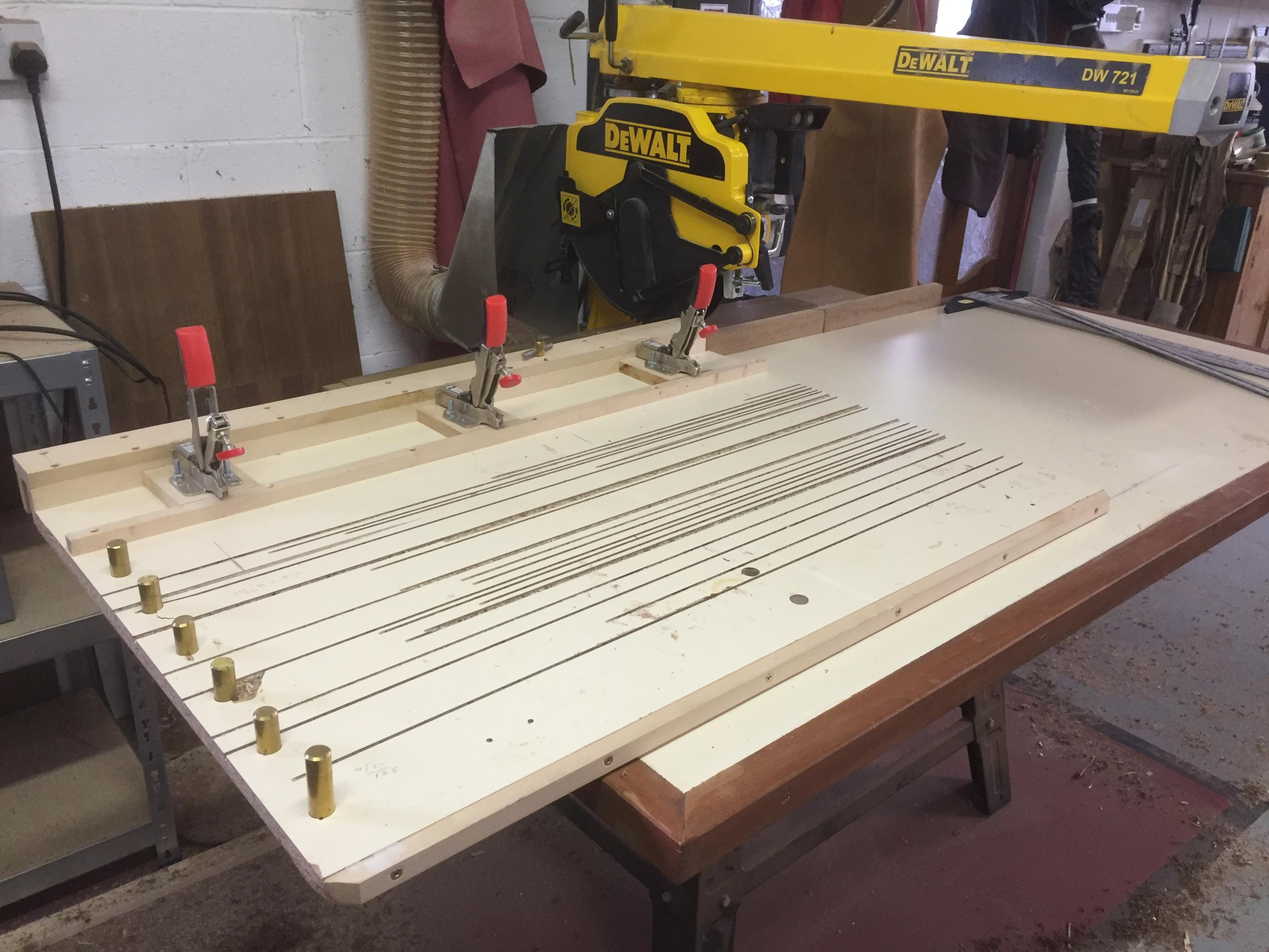

    The debate on Radial Arm Saws seems to go on forever. I'm in the "For" category. To help those who may be 'on the fence' make up their minds and to perhaps, persuade those in the "Against" category to look again, here is a look at my RAS set-up. It was developed primarily with safety in mind but also convenience.

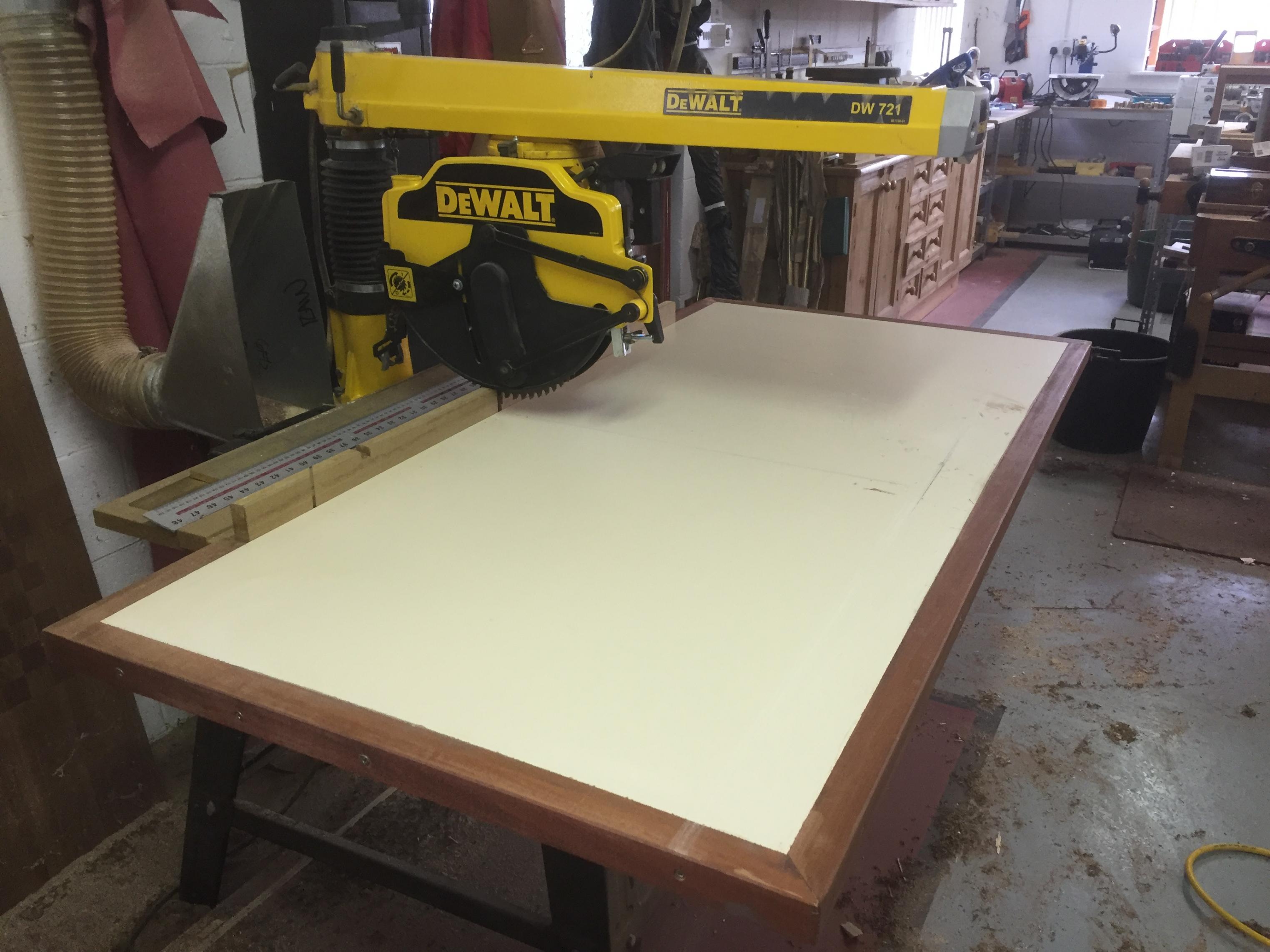

    Firstly, there is the table itself, which in my case, is not sacrificial:
    Radial Arm Saw Table/jig-img_5208%5B1%5D.jpg
    It is made from melamine-faced particleboard; for ease of cleaning and for slipperiness.
    Next comes a sideways sliding table (x direction, that is) made from the same material. This might seem a strange idea with and RAS but, read on. The table is constructed in a way that it hooks over or straddles the rear fence of the original table in a way that prevents slop:
    Radial Arm Saw Table/jig-img_5209%5B1%5D.jpg Radial Arm Saw Table/jig-img_5211%5B1%5D.jpg
    Kerf lines are visible on the auxiliary table in the photo from previous ripping operations; the auxiliary table is sacrificial.
    The back fence of this auxiliary table is designed to be exactly parallel with the original table's fence. Examination of the photographs will show that the are three clamping devices which hold down the work piece firmly when cross cutting or ripping. Another important feature of the auxiliary table is a pin which automatically drops into a corresponding hole in the original table's fence when aligned, thus, locking the auxiliary table into place when cross-cutting for example.

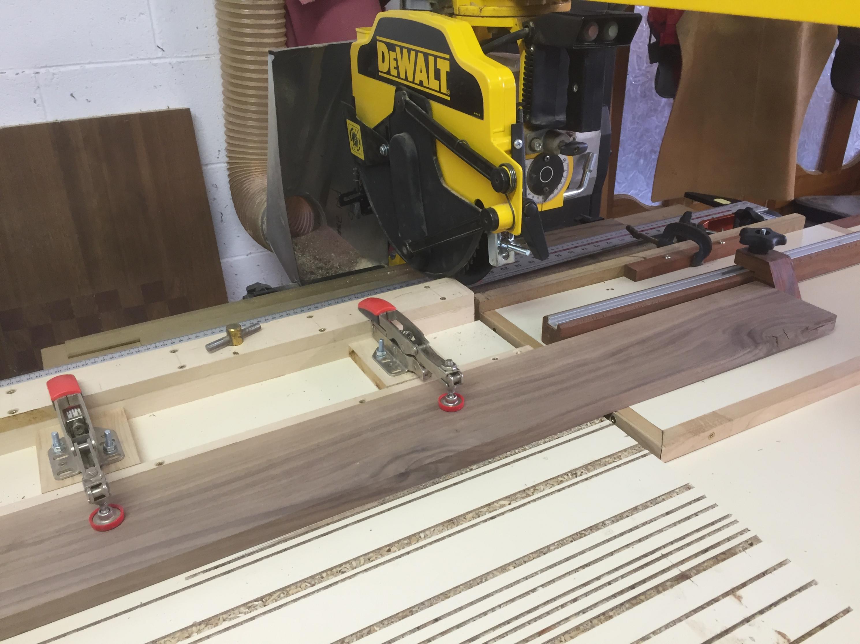

    The following photo shows a board of walnut ready to be cross-cut to length. It is clamped in position. A stop arrangement to the right ensures that repeat cuts will be exactly the same. The auxiliary table's lock pin is in the down position, so everything is solid. The cut can be made safely and cleanly with no hands or thumbs needing to be near the blade. In fact, the cut cut could be made with just one hand operating the saw.

    The set-up described above is also great for cutting medium to small sized sheet materials. The next photo shows a plywood square panel being cut to size. Cutting a panel like this is basically like doing long cross-cuts.
