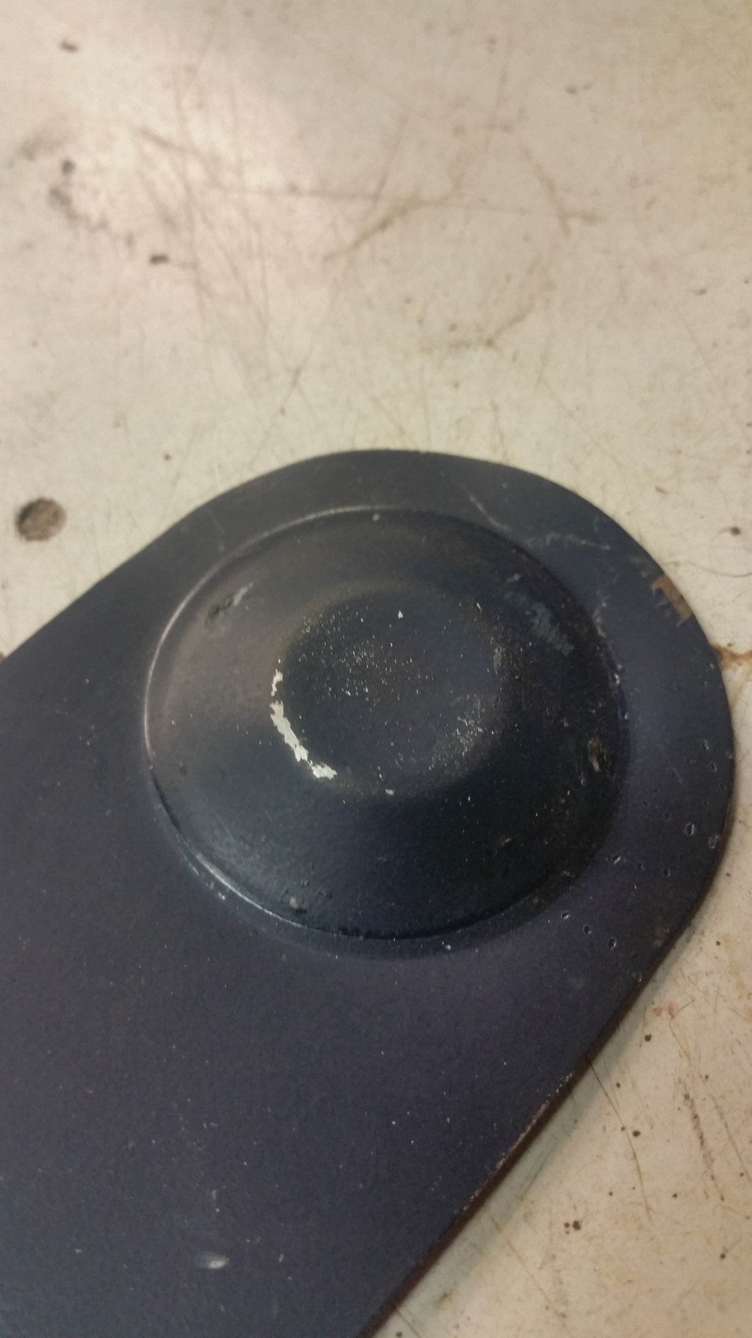

    Hi all, This one came about when i needed to press the bump of a pulley cover out a bit more to clear a new bolt.
    This is what i needed to press out more.

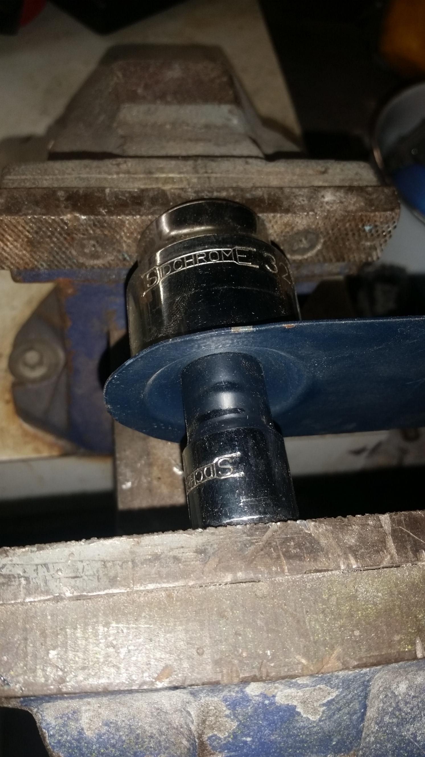

    So I grabbed a couple of sockets of different sizes to suit and set them up in the vice with the piece in between them.
    Gave the vice a good twist or 2 until it had pressed enough

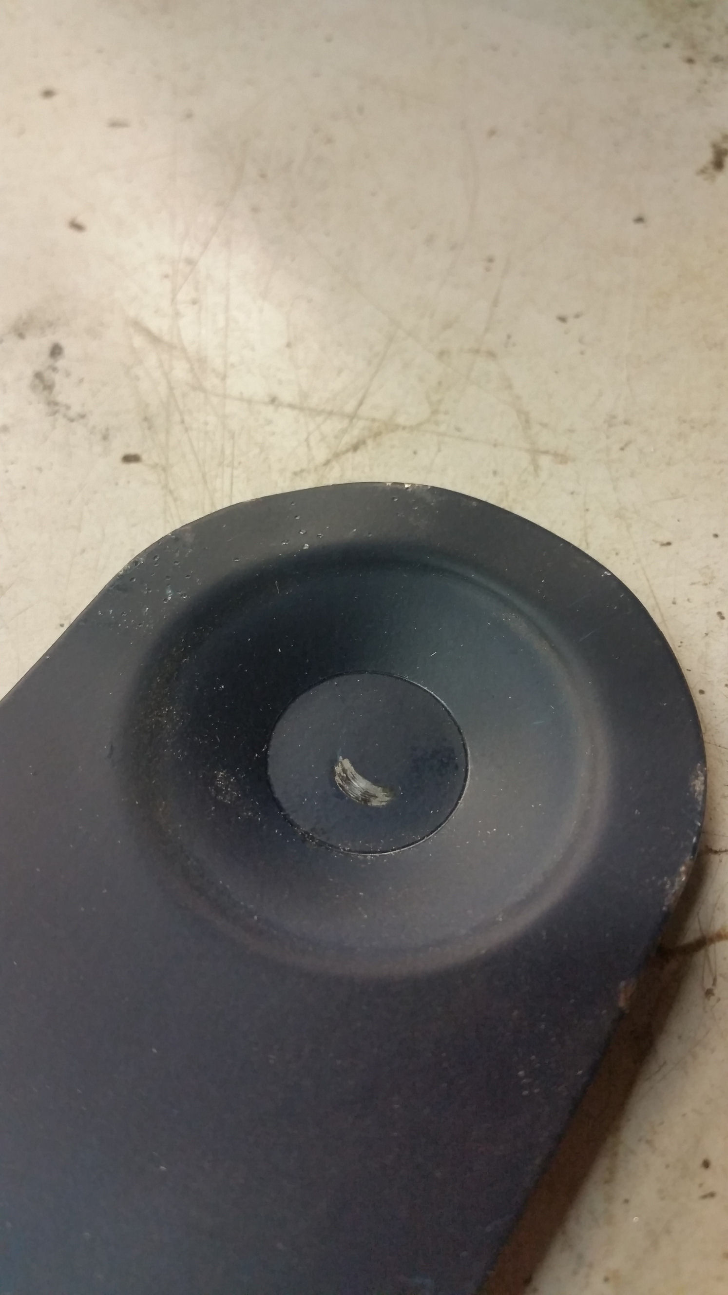

    And this is how it came out

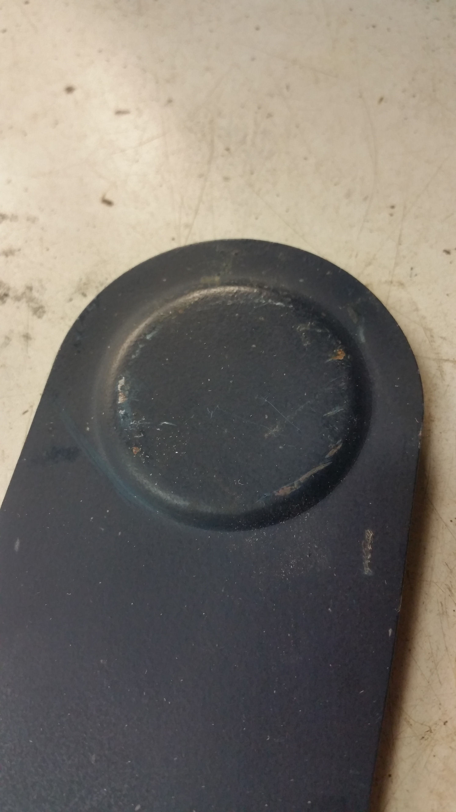

    This one you can see where the bolt head rubbed. Not any more!
