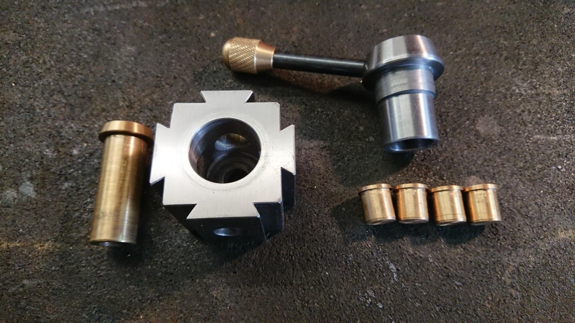

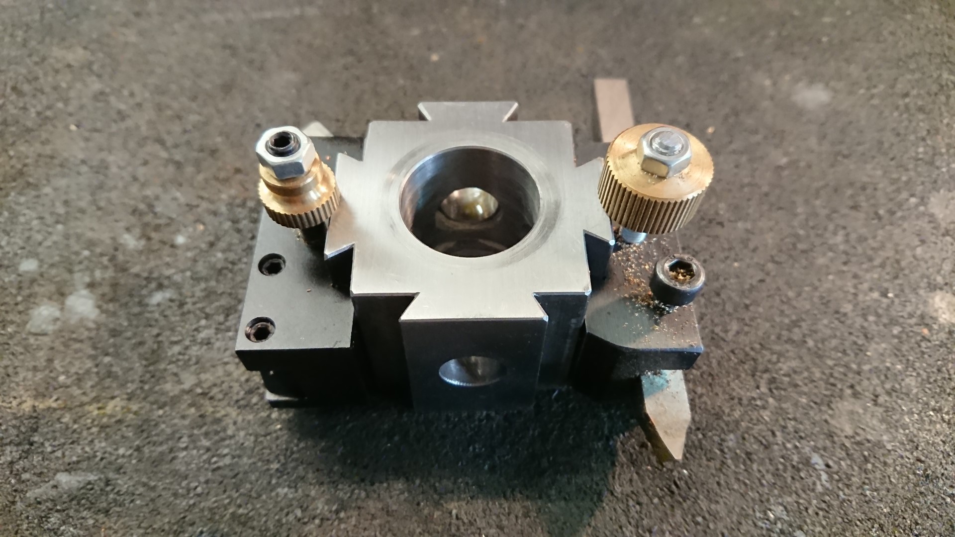

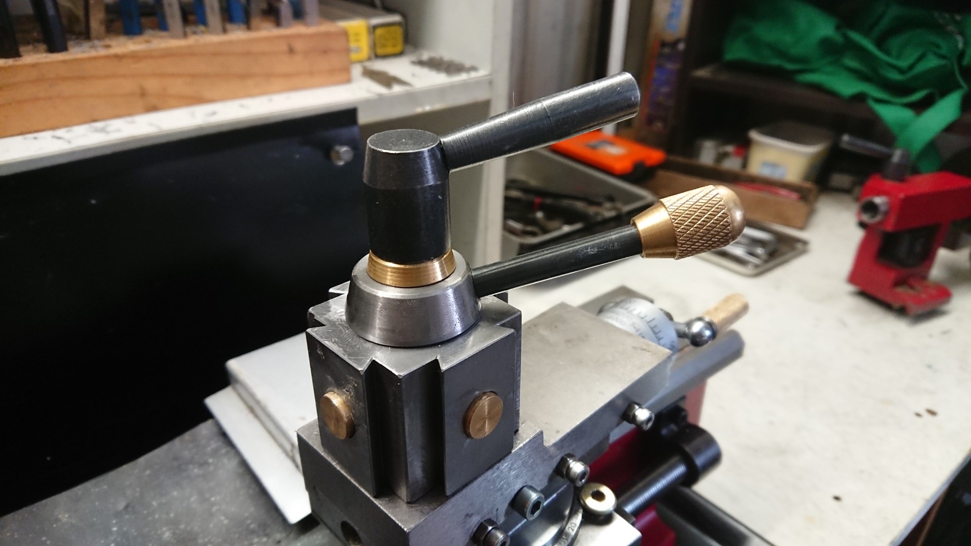

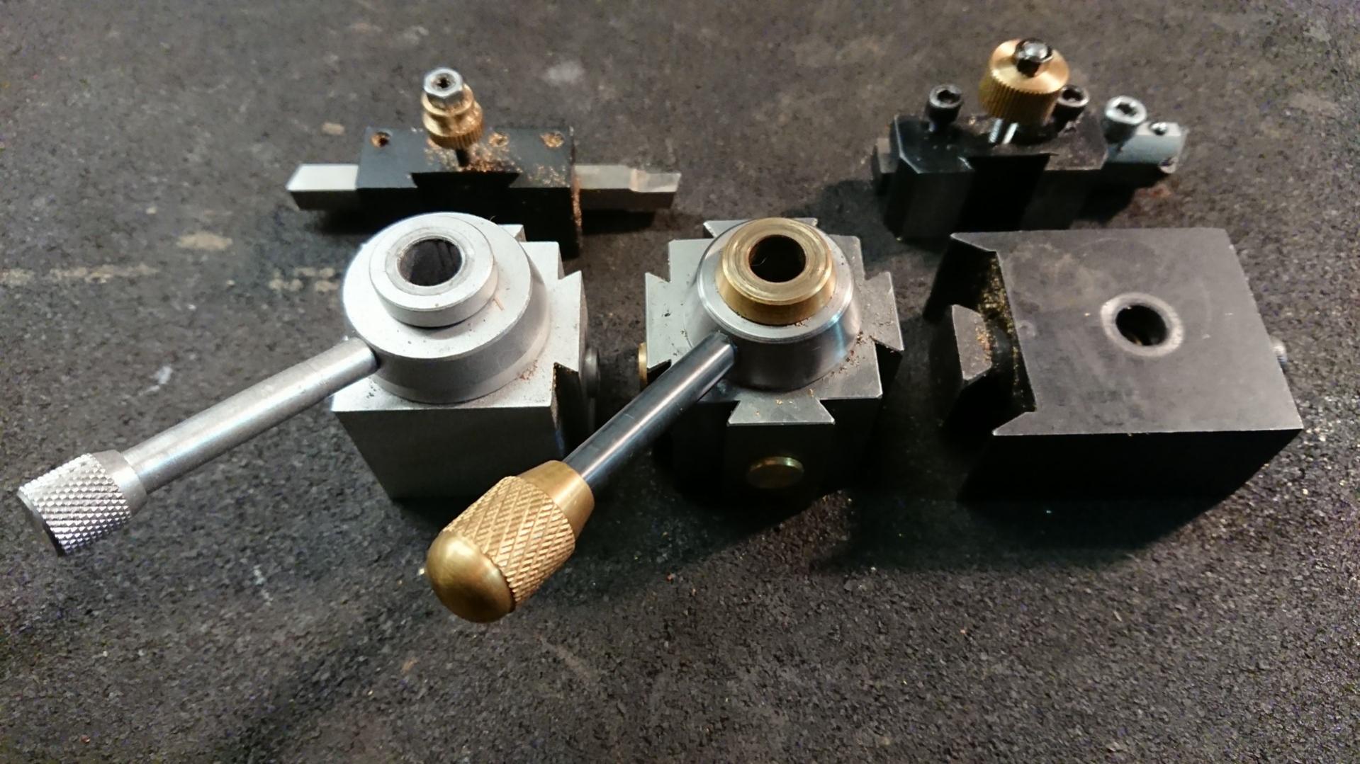

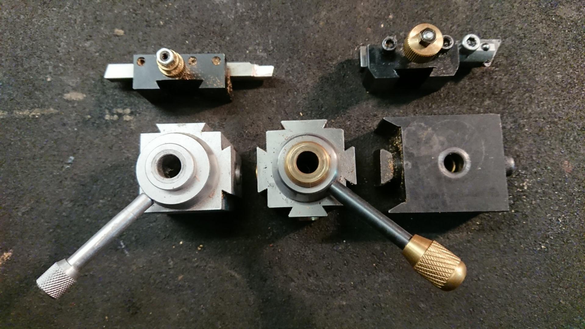

    I struggled with the standard mini lathe tool post for too long until I bought a steel Chinese qctp a while back with 3 inserts but found because of the large overhang chattered, then thought I'd give another one made from aluminum a go and found it was quite defective. The handle consistently came loose and was prone to bending and had a real problem with binding when tightening so alas decided to make one to accommodated both size inserts. Waste not want not.

    The aluminum inserts are actually quite good and lock the tool well, don't know about long term use but so far so good. After using the system can't imagine going back to standard system. My original post has my knurling tool mounted and has been for some time now.

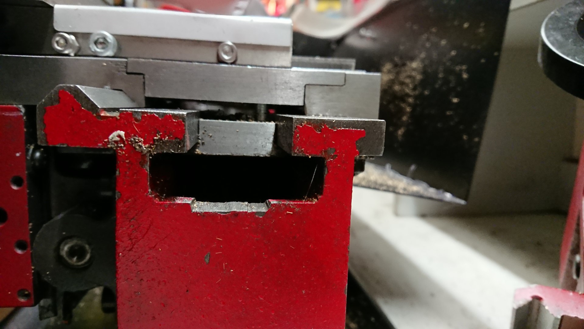

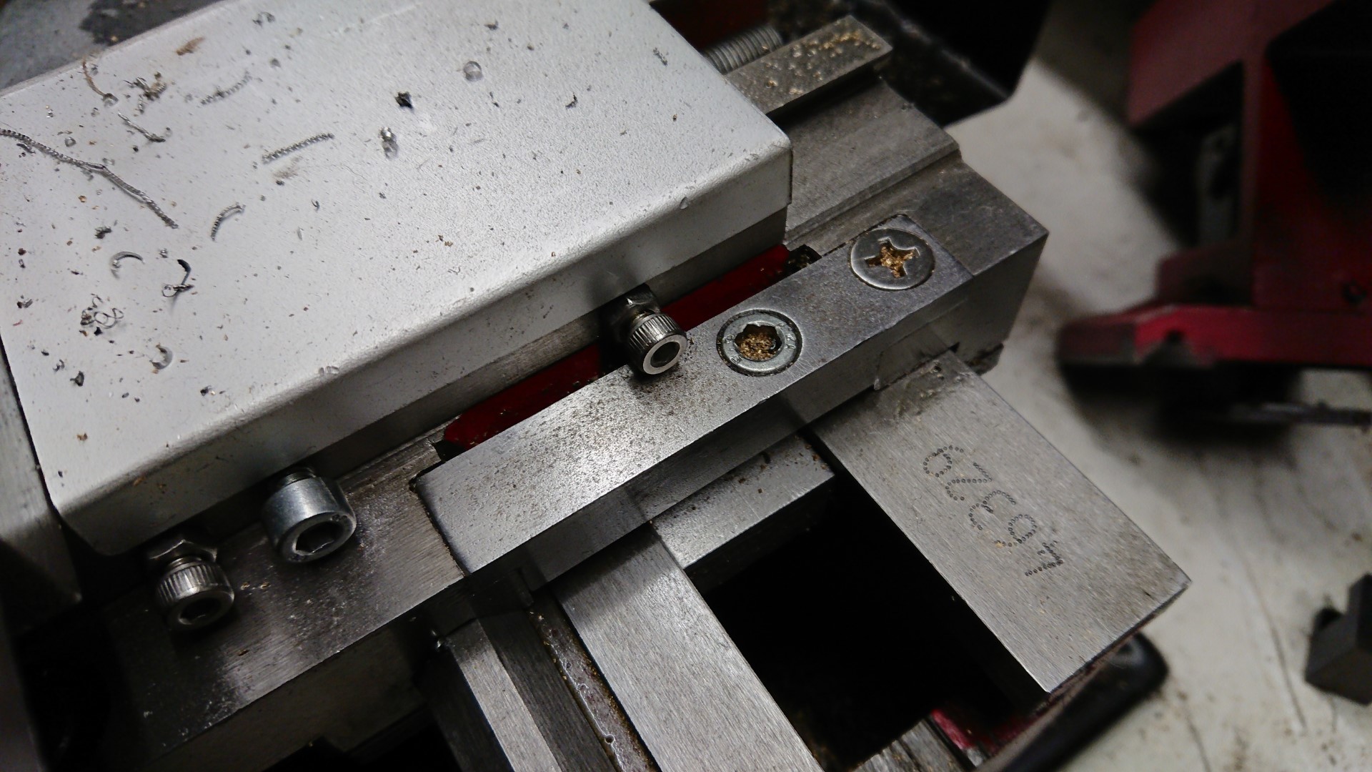

    Beautiful work Stevoh! Always wondered why they didn't make it a 4 way in the first place. The brass locks and barrel seems a nice touch. The thicker knurled knob on the holder is also a good design imho, and love the shape of the knob on the handle. Also noted it looks in the last picture that you added a lock screw on the gib for the cross slide. That has been a problem on mine as well with rocking, especially when parting...may give that a try. Constantly adjusting the gibs especially after working steel or hard material. Thanks for sharing a great idea.

    Thanks pj, yeah these lathes are described in the mini lathe site like a kit you have to rebuild to get them to behave like a real lathe.. Haha, but so true. The first time I used it there was a clicking sound comming from the carriage, one of the hex screws holding the carriage on fell out & was sitting on the big geared wheel. Since then Ive spent considerable time fixing design & manufacturing probs, the gibs werent even flat... Grrr

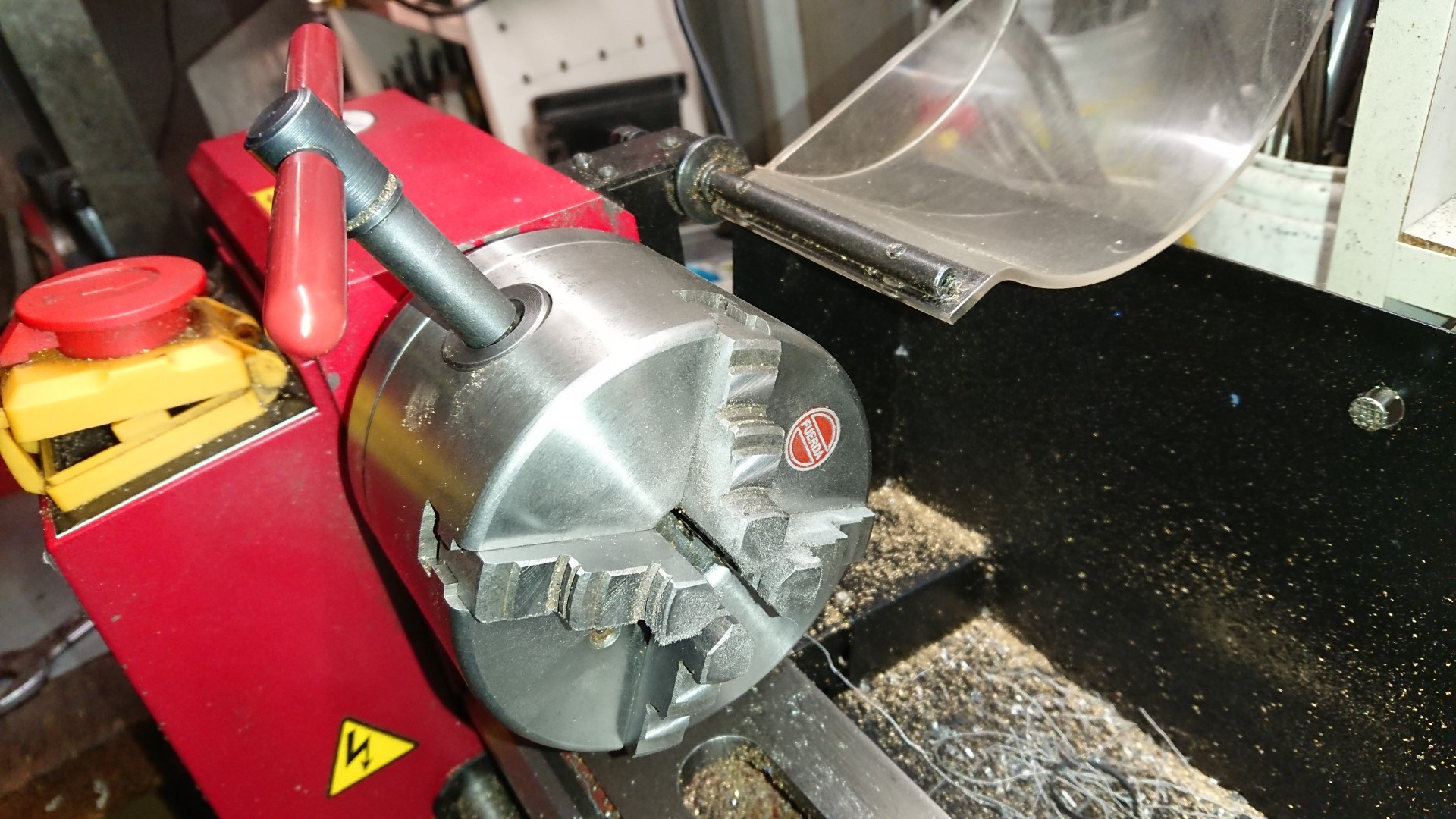

    Hey PJ thanks for the links, my 3 jaw packed up a while back so opted for a self centering 4 jaw, glad I did because found myself doing square stuff a lot.

    Yes, got into habit of leaving chuck handle in because lathe can't start with guard up... naughty!!
    Thought you might be interested in my carriage lock design, when I first got the lathe thought the screws for the travelling steady were for locking carriage, soon learnt by the dents they put in the ways...der!

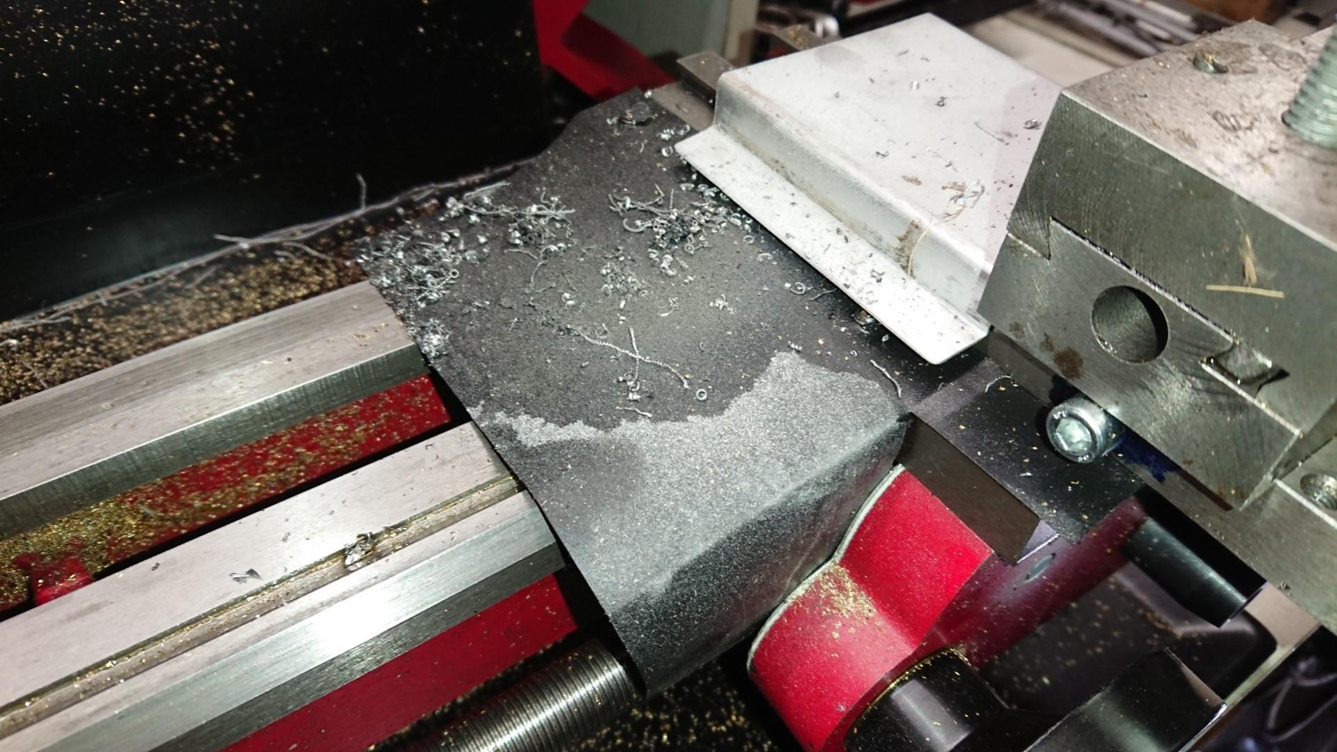

    And here's a pic of my swarth guard made from the plastic bottom from a shopping bag.

    Nice mods Stevoh! Carriage lock has been on the list and yours looks pretty good. Think I'm heading for a low profile lock handle and spring load it like I did on the tail stock slide. I see you have the saddle gear cover also and like the sheet metal cover on the cross slide too. Another thing on the list are felt way wipers.
    Mine didn't come with a flip guard, so I just hang my chuck key kitty corner from in the corner of the chip guard. Learned a long time ago Take the Chuck key Out on dads old radial head DP setup for high rpm, wizzed by my head and stuck in the wall...wheew dodged that bullet. After that it was tied to the head post with parachord, just long enough to reach the chuck plus an inch.

    Hey pj, before doing carriage lock consider handle will hit gib adjustment screws & tailstock housing in some cases, thats why i used socket head screw to lock down.
