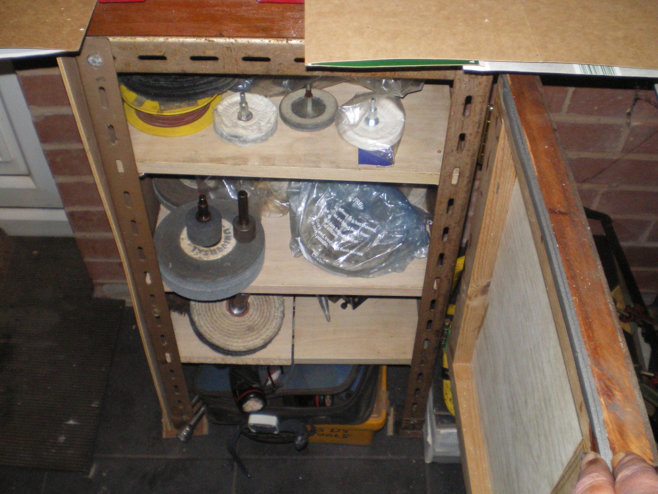

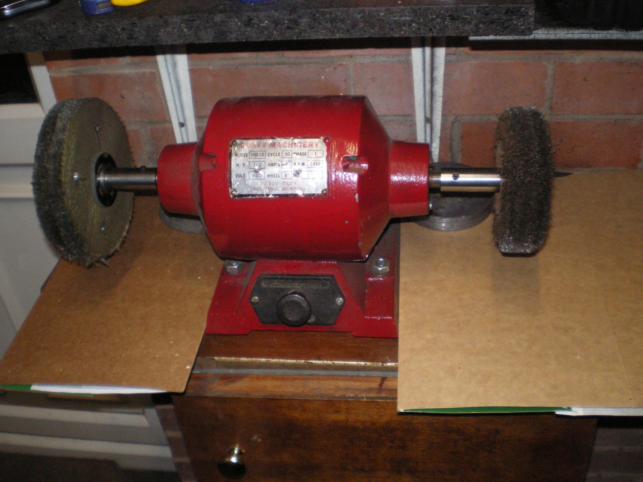

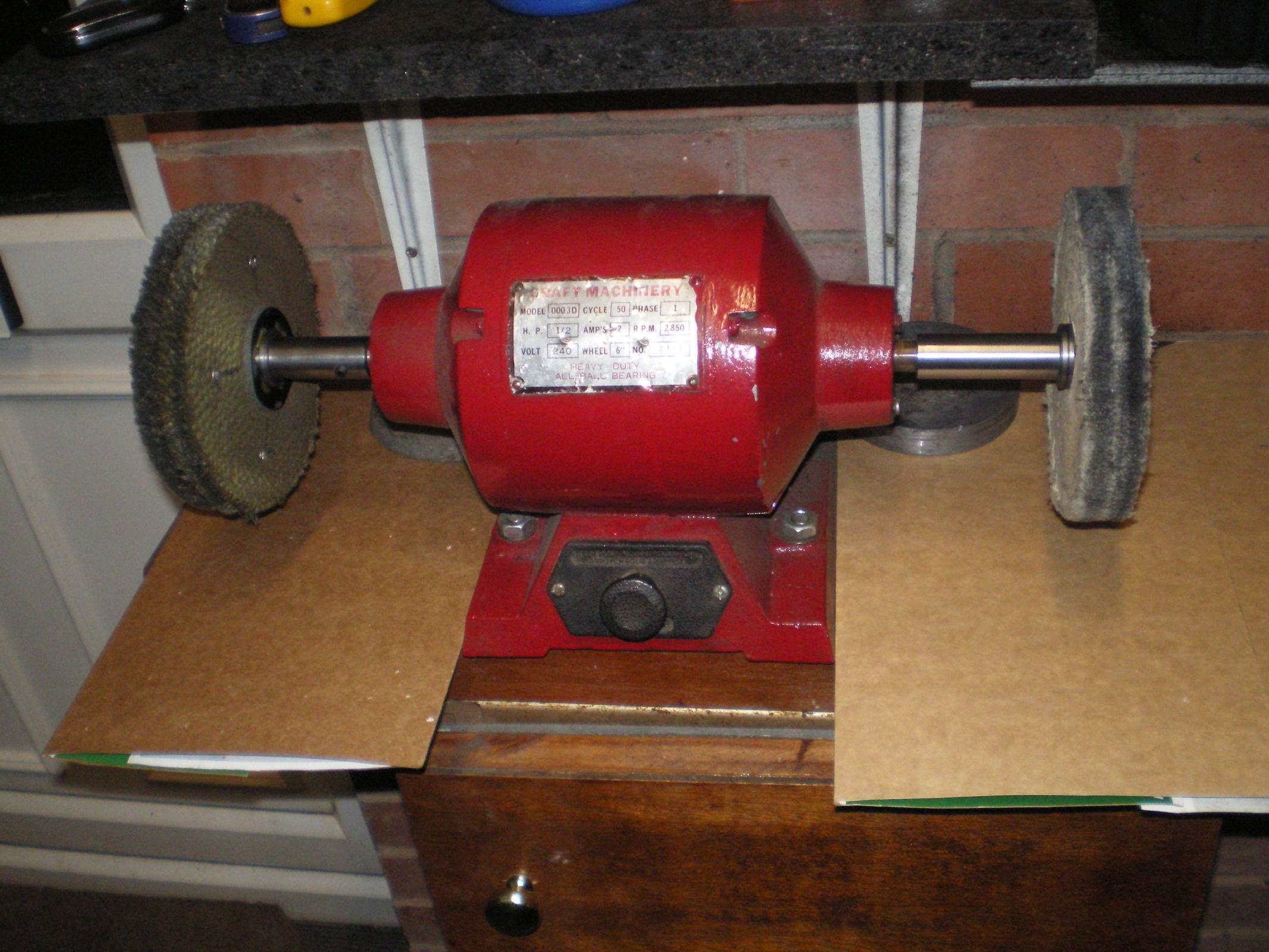

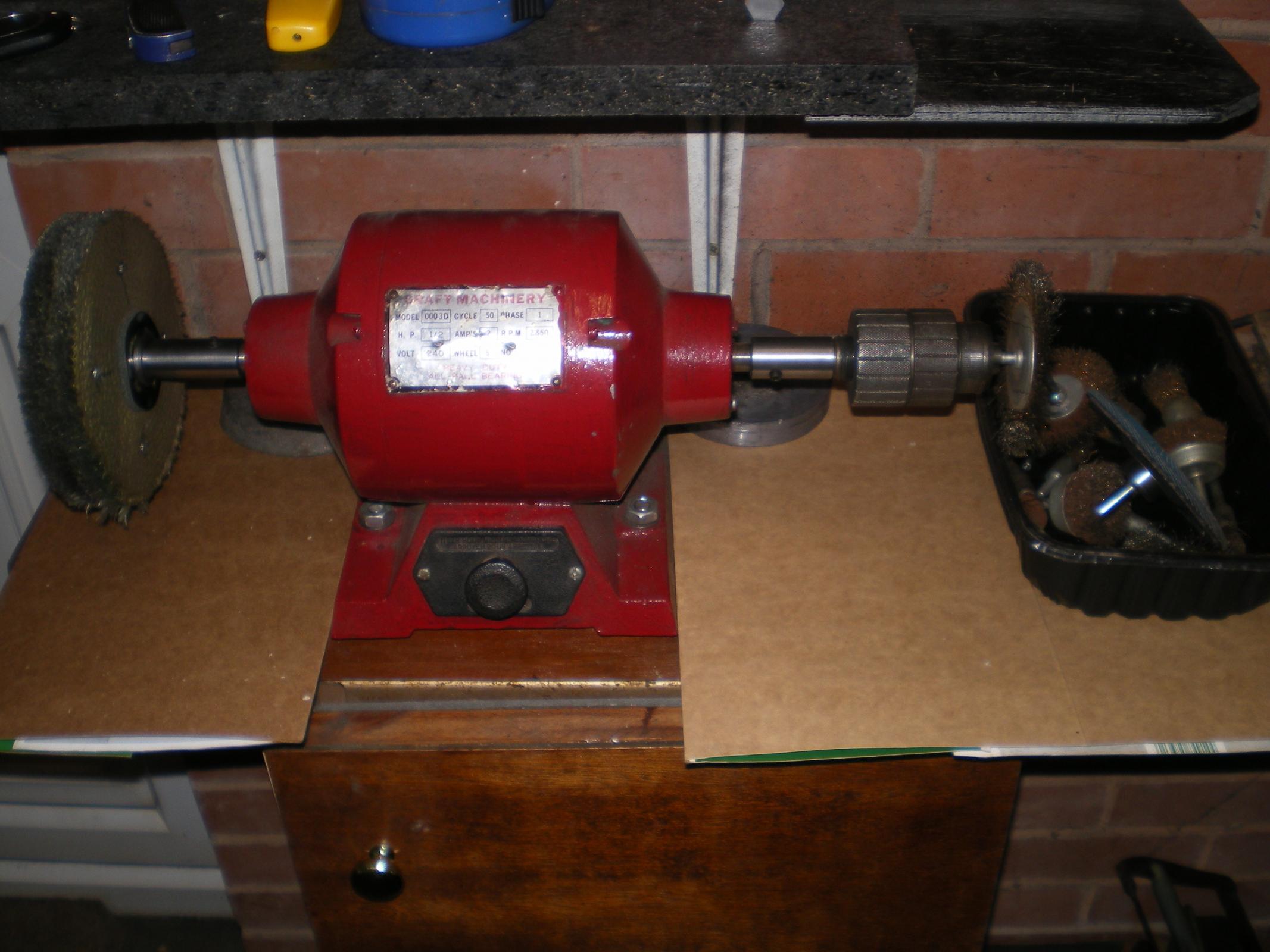

    Quick change buffing wheel arbours.
    I have never been a fan of pig tail mounts for buffing wheels, they never run the same each time they get changed. As I only have one buffing machine and wheel changes are frequent I decided to make dedicated mounts for each wheel. These are easy to make and reamed a nice fit on the grinder shafts and held on with one 6mm grub screw to a flat filed on the shafts, with sturdy support washers wheels now stay true once worn in, I also made one for a keyless Kawasaki drill chuck for using wire brushes, flap wheels etc. This has been a great improvement to getting the most use out of one machine in a small workshop. While at it I made a small under storage cabinet to keep the wheels stored dust free.

    Thanks olderdan! We've added your Quick Change Arbors to our Buffing and Polishing category,

    Thanks olderdan! We've added your Buffing Wheel Storage Cabinet to our Storage and Organization category,

    Great idea! I was looking for a 5/8-11 threaded drill chuck this weekend for my grinder, but all I found were smaller. I’ll make a small batch of these as you suggest and get more use.
    Thanks!
