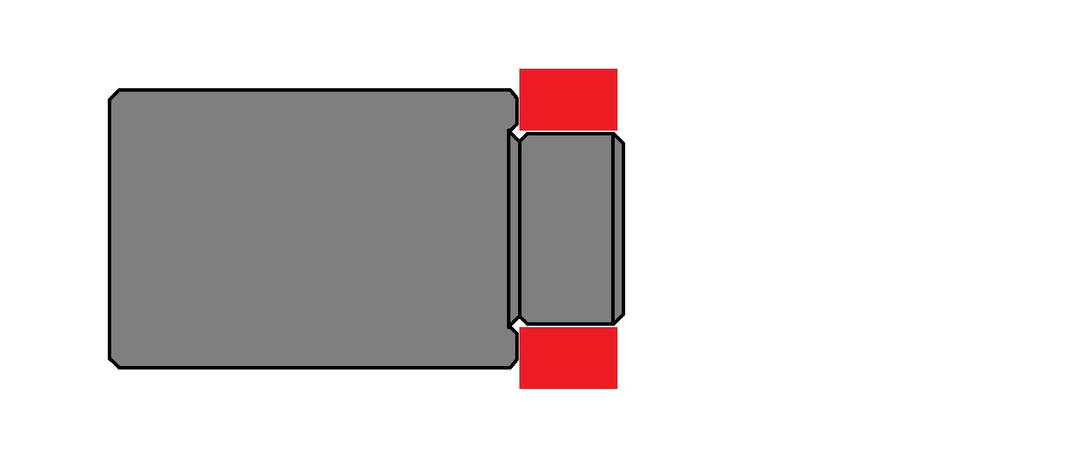

    That sounds like a natural development; anchoring pivot side so tool and holder move together, minimizing unsupported tool.
    Your square-tipped bit is efficient, proven by plunging into solid material. Your tool may or not part well in every case, depending on material, depth and proper grind. It should perform 'necking', which is parting without full penetration. Also, there's a process to relieve inside corners; plunging in a short distance at 45° so perpendicular surfaces accept flush mating parts.
    Such a cutter needs back clearance on each side, eliminating a jam in the narrow groove. A tiny radius will blend surface marks, helping avoid a jam.
    To chamfer open corners, a small radius on each side of bit will reduce [blend] tool marks of hand-fed cutter movement....As only one face is cutting, the extra contact shouldn't generate too much load on the tool.
