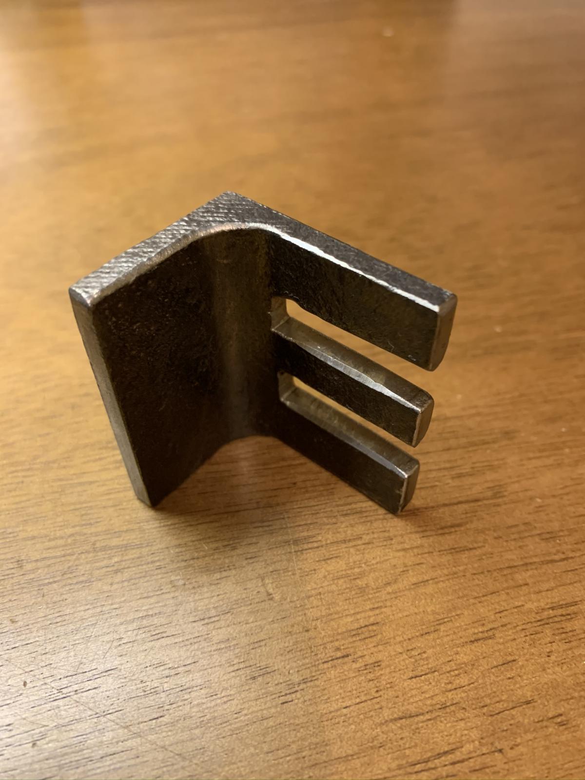

    The design has evolved:
    Now there is only one part. Details are in the article: https://rick.sparber.org/QuickActingBuckle.pdf
