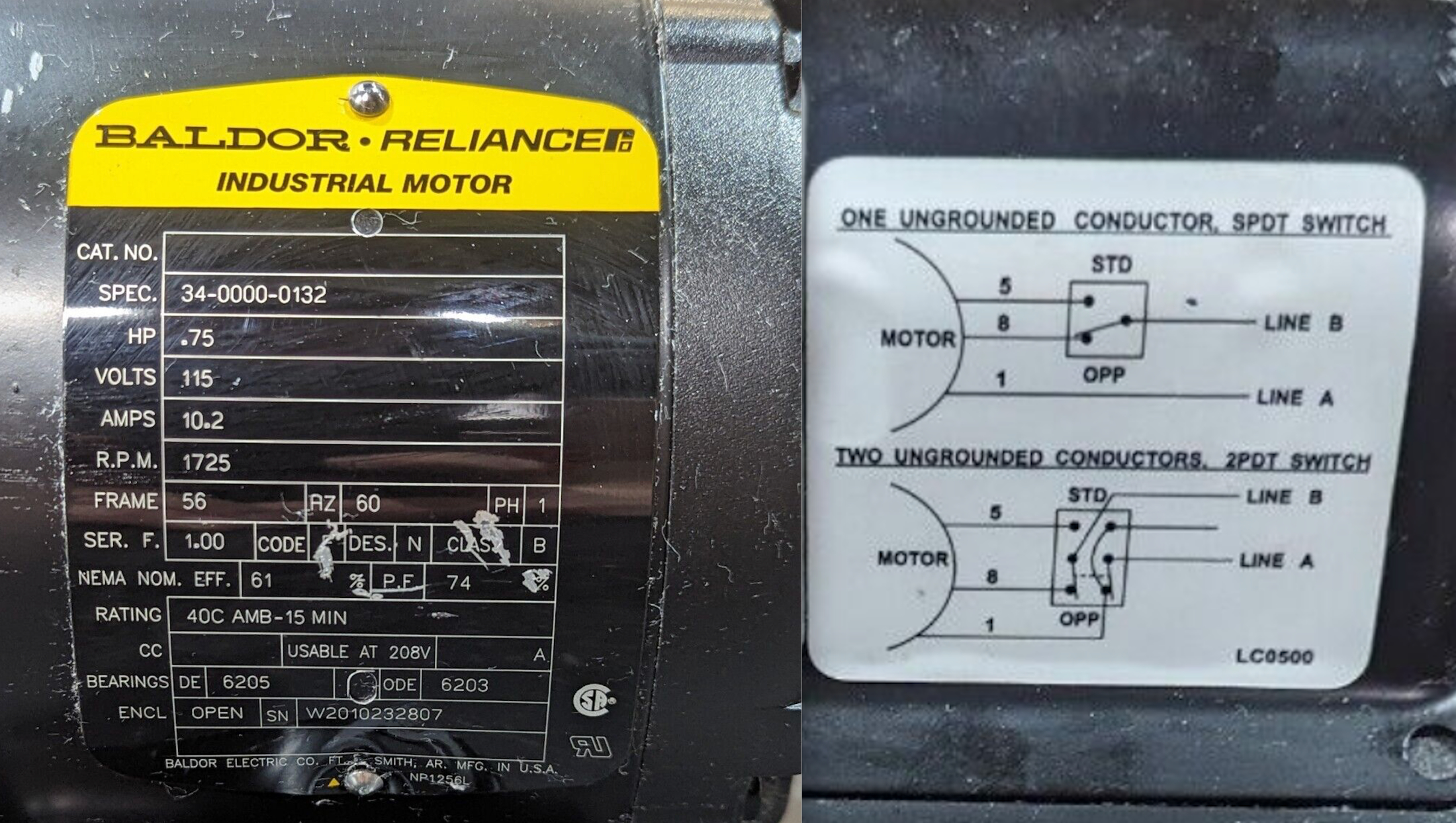

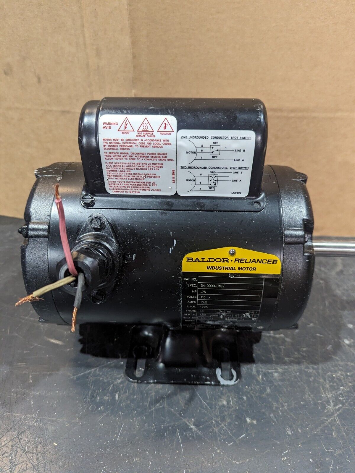

    I just purchased a 3/4 hp single phase Baldor motor on eBay, which hasn't arrived yet. I need it to rotate counter clockwise when looking at the shaft end. There are three wires sticking out of the motor - green, red, and white. I understand that the green is ground, and it doesn't matter which way the other two connect to the two remaining plug terminals.
    The wiring schematic on the motor shows how to reverse the direction, if necessary, but I'm not sure I know how to interpret it. I think Std means clockwise, and Opp means counter-clockwise, but when viewed from which end of the motor? Which diagram do I use to reverse the rotation? The top diagram seems simple enough, but the bottom diagram not so much.
    Also, what is the best way to deal with the three wires sticking out of the motor? I'm thinking I should pull off the plastic/nylon connector and wires, and attach the new cord to wherever the old wires were attached.

    The schematics show how to wire it to different types of switches in order to be able to change rotation direction as needed. Connect the neutral to line 1 and the ground to the frame or ground wire. Connect the hot to line 5 for clockwise, or line 8 for counterclockwise. Rotation is as viewed from the exposed shaft end. Cap the unused wire with a wire nut and tape.
    Ignore the wires sticking out of it. The wires marked with the numbers should be either under the bolted part of the connector assembly on the side or under the rounded cover on top.
    In addition, you can put the spec number shown on the plate into the search field of Baldor's web site and get a lot of technical information about it.

    On https://www.baldor.com/catalog/34-0000-0132 you will find a drawing CD0088.

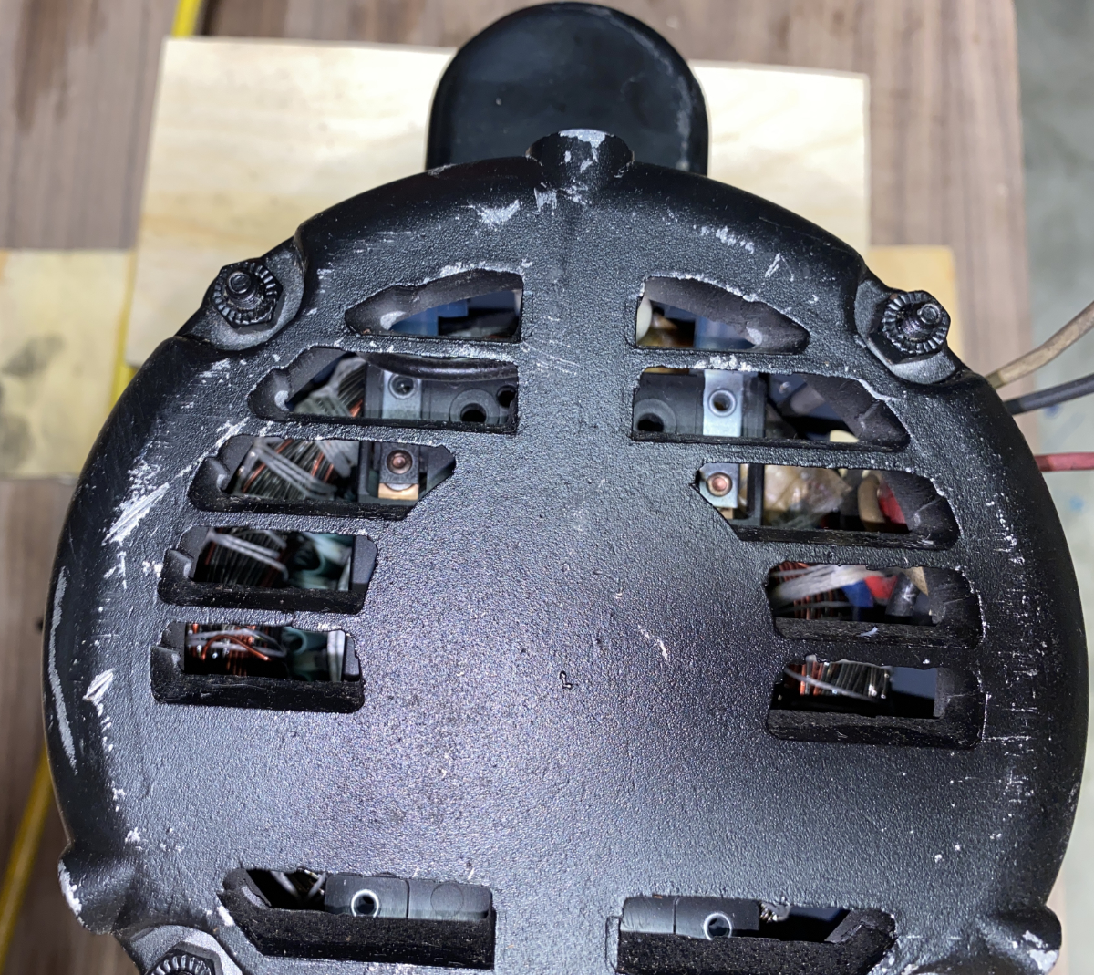

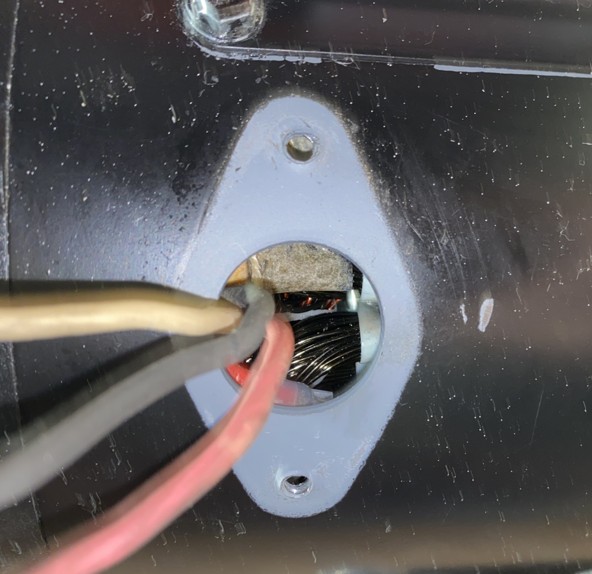

    The motor came today. I pulled the wiring connector, and the three wires just disappear into the casing, and don't pull out any further than they are. If I look into the end of the motor, I can see a couple of connections, but not what wire is connected to what. I can't imagine Baldor requiring you to take the end of the motor off to change rotation direction.
    The wiring diagram shows the rotation direction being dependent on whether the red (8) or black wire (5) goes to line B. It would seem that if I connect the white wire to one terminal on a plug, and either the black or red wire to the other, the motor would work. But if that's the case, how would I hook up the ground terminal on the plug?

    Find some bare metal screw and attach there. Longer term, ground the mounting bolts to the motor. It looks like the motor might be fully isolated from the case, so you can think more about where to ground once you mount it...

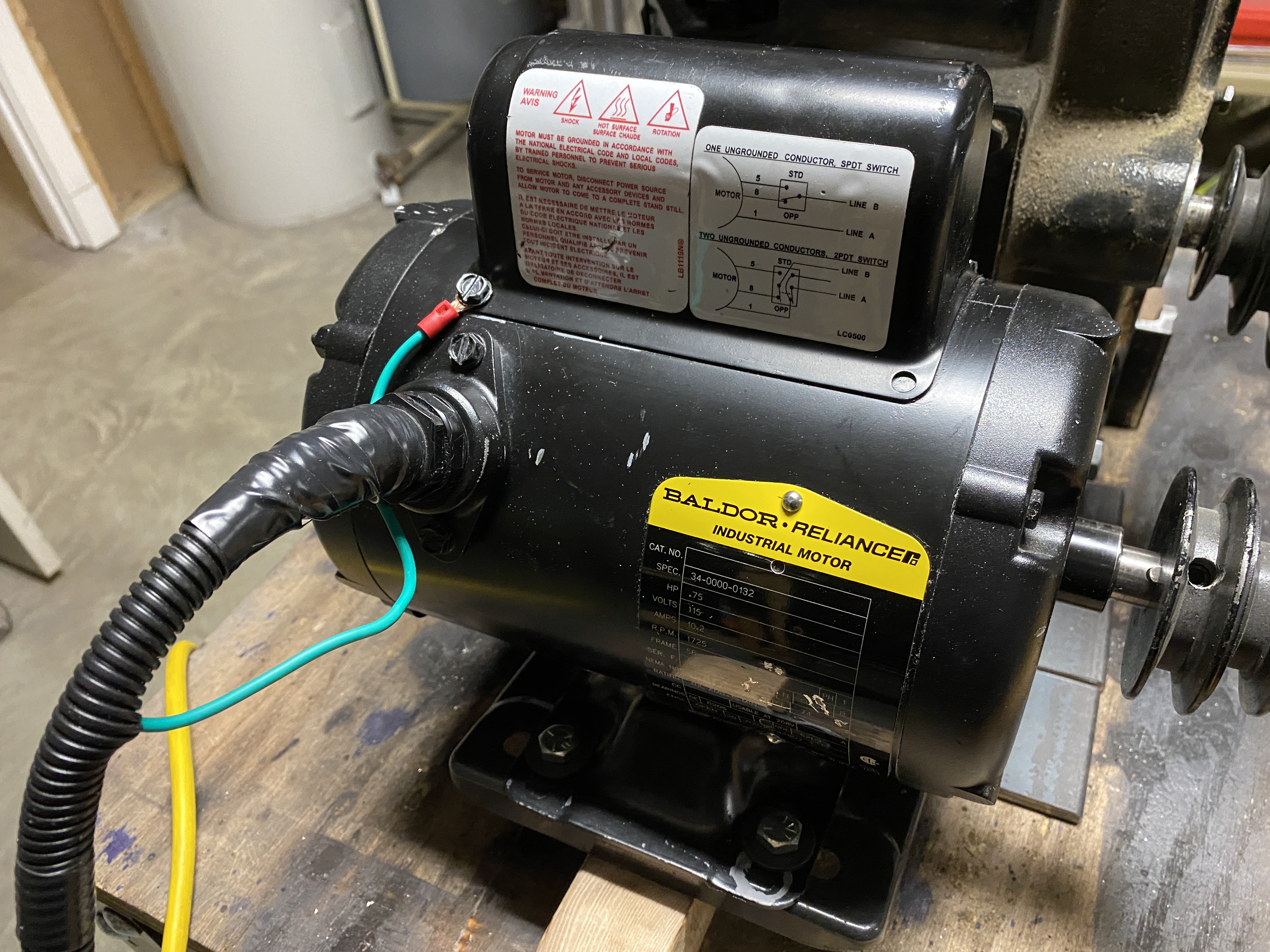

    I wired it up temporarily to an extension cord with the receptacle end cut off. I connected white to white, red from motor to black from cord, and a wire from a screw on the motor case to the green on the cord. It ran perfectly counter-clockwise, which is what I wanted. The only remaining question since I can't get to the wire connections in the motor, is what is the best way to safely connect the three 2" long wires from the motor to a cord?

    mount a small box over the place where the wires come out, using the screw holes already there, that is what I would do...

    The box idea is a good one, especially since there are already existing threaded holes for mounting. Other options are a couple layers of shrink tubing after soldering the wires, or crimp connectors with shrink tube. Both will hold reasonably well as long as the cord isn't being pulled on when the motor is mounted.

    It's all wired up now, and works perfectly. Thank you all!
