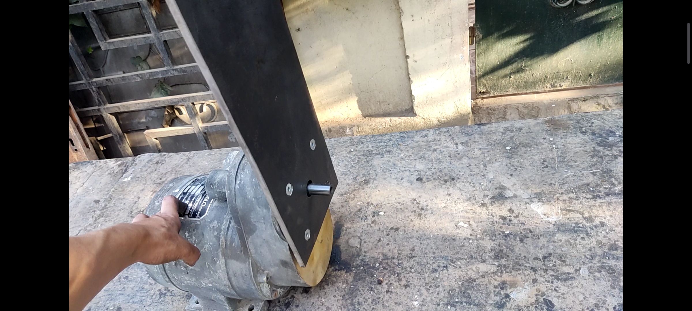

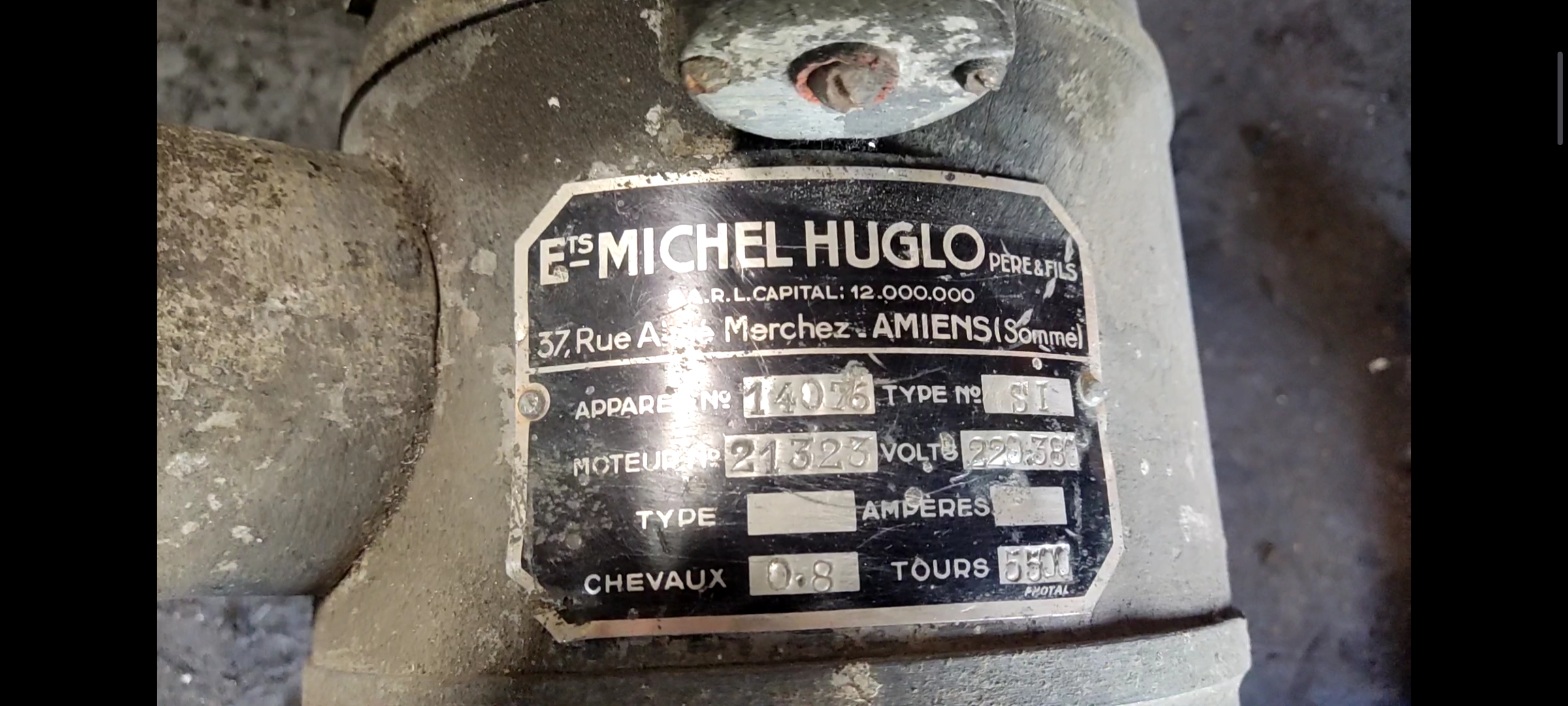

    Hello guys, i'm planning to make a belt sander with this high speed motor (5500 rpm) and my question is, Can i use this motor for the belt sander?
    Thank you for your reply.

    These people have a explainer on calculating the appropriate speed for a belt grinder belt: https://www.redlabelabrasives.com/bl...a-belt-grinder
    I suspect 5500 RPM is quite a bit too high for direct drive, you might need to add a speed reducing pulley set between the motor and belt driving wheels to bring it down in speed.

    Hi The motor looks like a gear up to the posted speed ....I find 3600 rpm motor speed is best for me.. remove the gear drive and see if you have enough torque....If you want to grind metal you need horse power so I am not sure this motor is right for your application... hope this helps.

    I agree, 5500 RPM and potential wheel diameter will verge on astronomical FPM, versus reduction available attached to the motor. I can't read French, but if there is sufficient power, a variable ratio is a good option for a sander/grinder.

    Hi, i already did that and i found that it contain 2 pulleys and belts to increase speed and yes the motor has 2400 rpm with a 1.5 hp. And i think that this helps, thank you!
