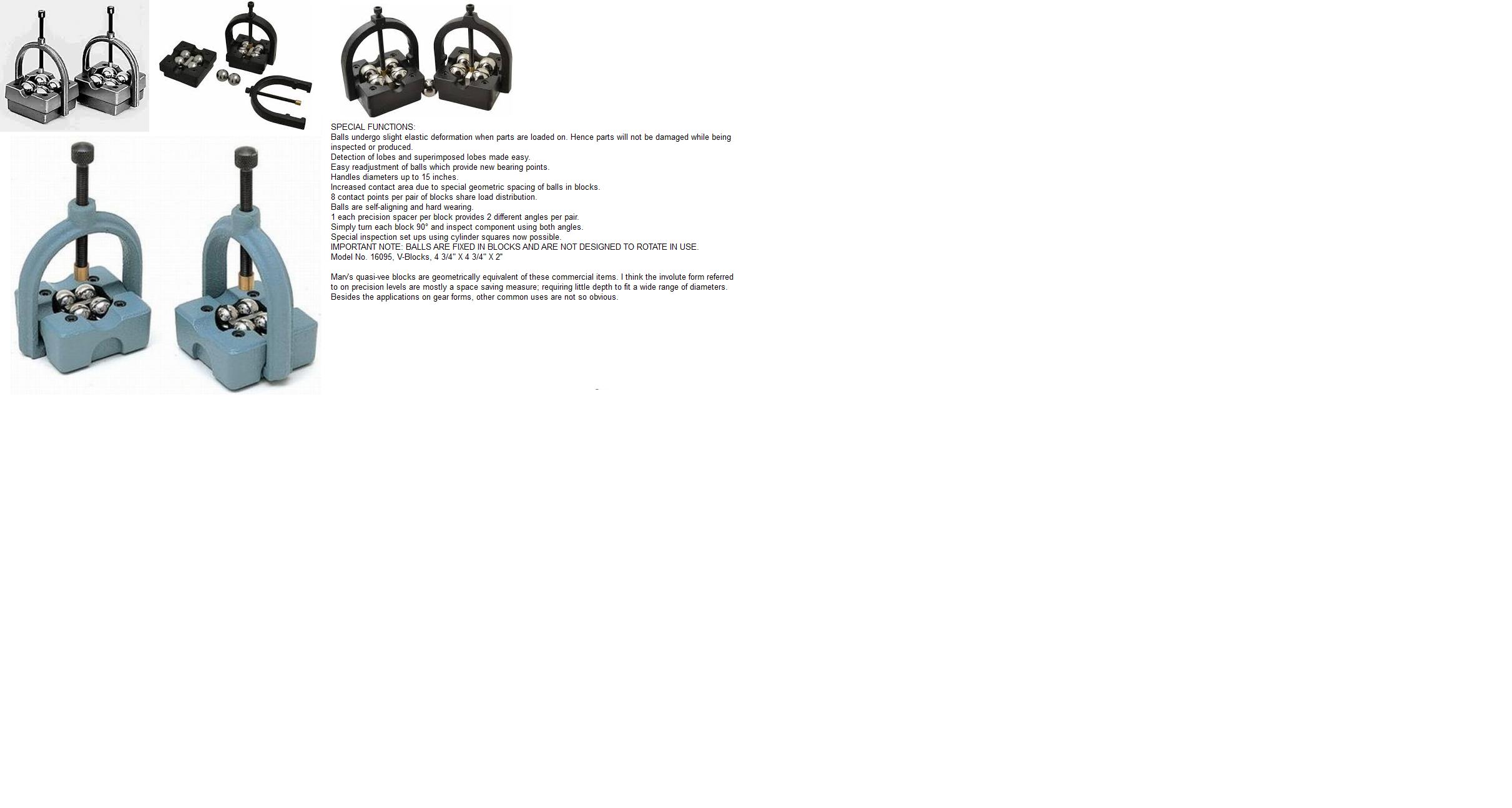

    This discussion on involutes is more than interesting; including proper sizing per diameter of conventional Vee blocks. The Vee in spirit level tool height setting gauges is purely inadequate. Why those 'um...gineers' don't get it is beyond me.
