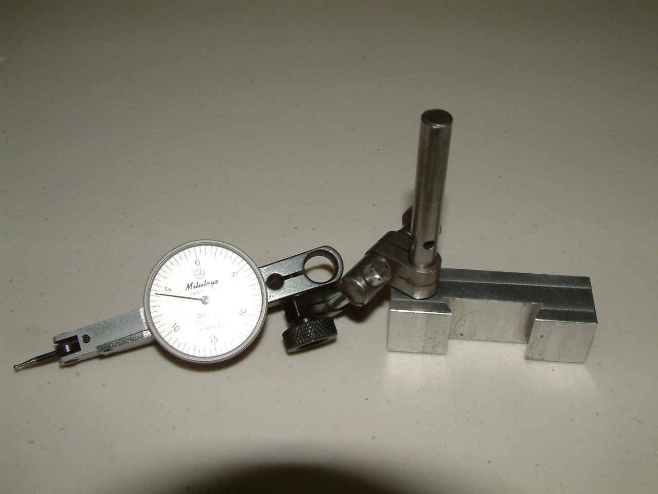

    Yep it is another indicator holder. Used one of my aluminum tool holders for a dial indicator just for the lathe.
    Nice to have a dedicated indicator that can be used instantly on demand. 1/4-20 tapped hole for the post and it can be inverted, used on either quadrant of the QCTP.
    Cheers, JR
