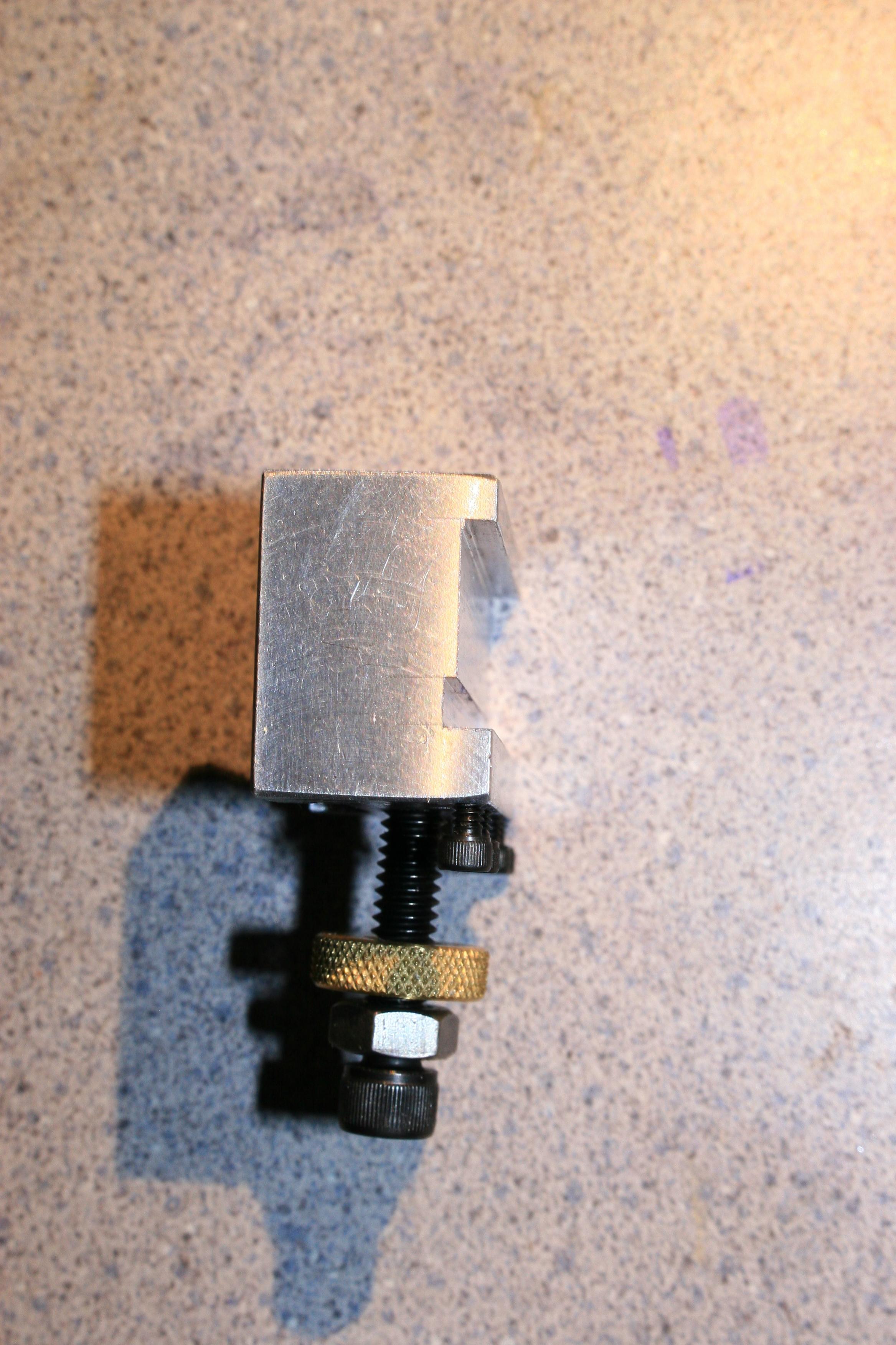

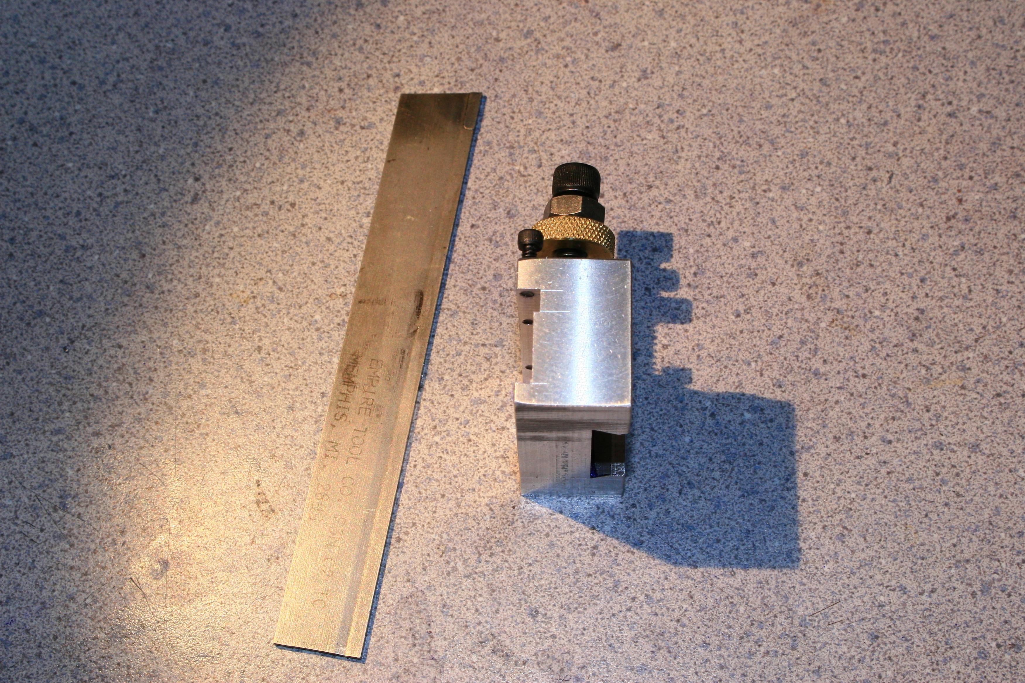

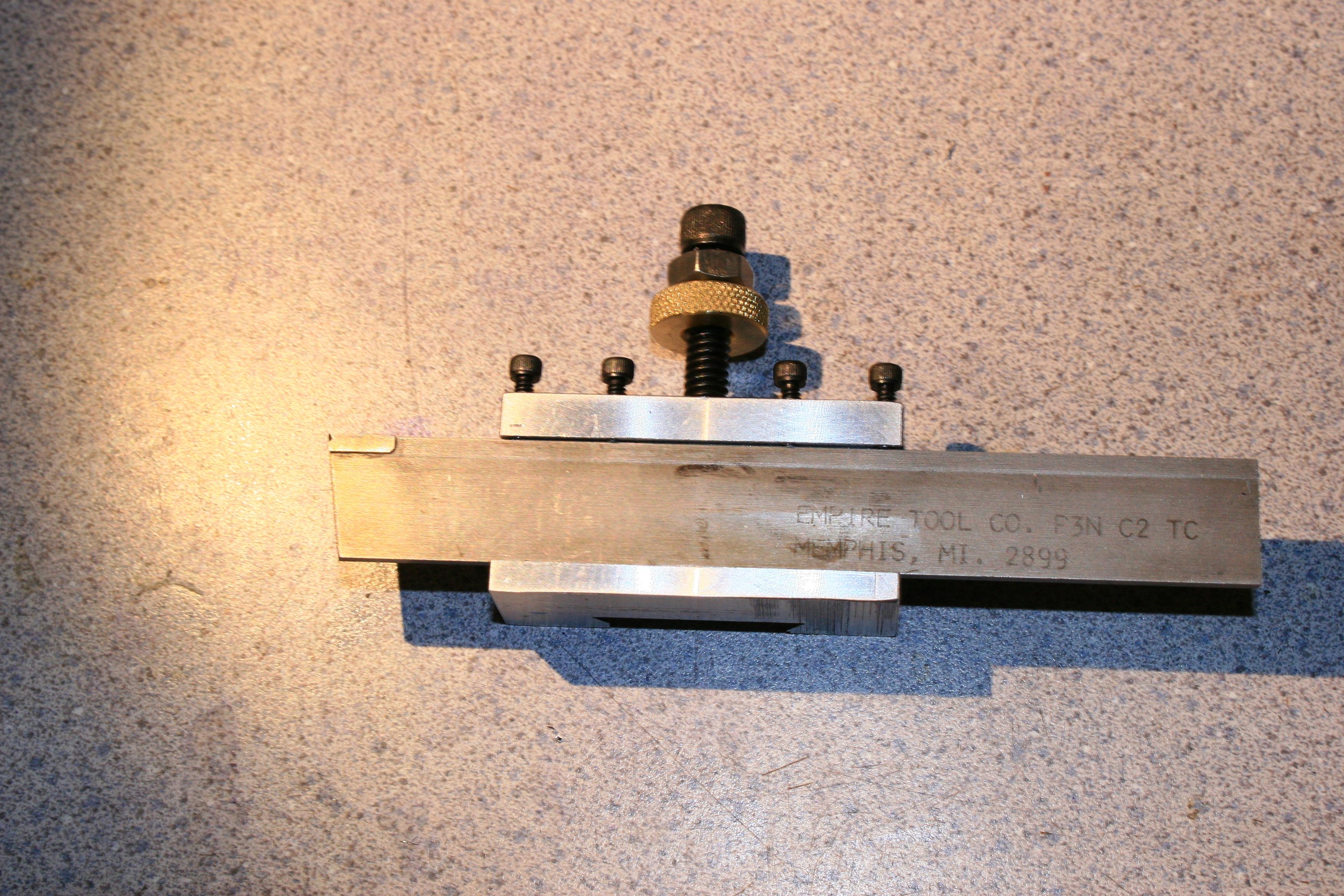

    I had this carbide tipped cutoff tool that would not fit in the standard 250-007 holder.
    A new holder was needed so using one of my new blanks I came up with this:
    The original post for making the tool holder blanks is Here:
    https://www.homemadetools.net/forum/...r-plans-104972
    Cheers,JR
