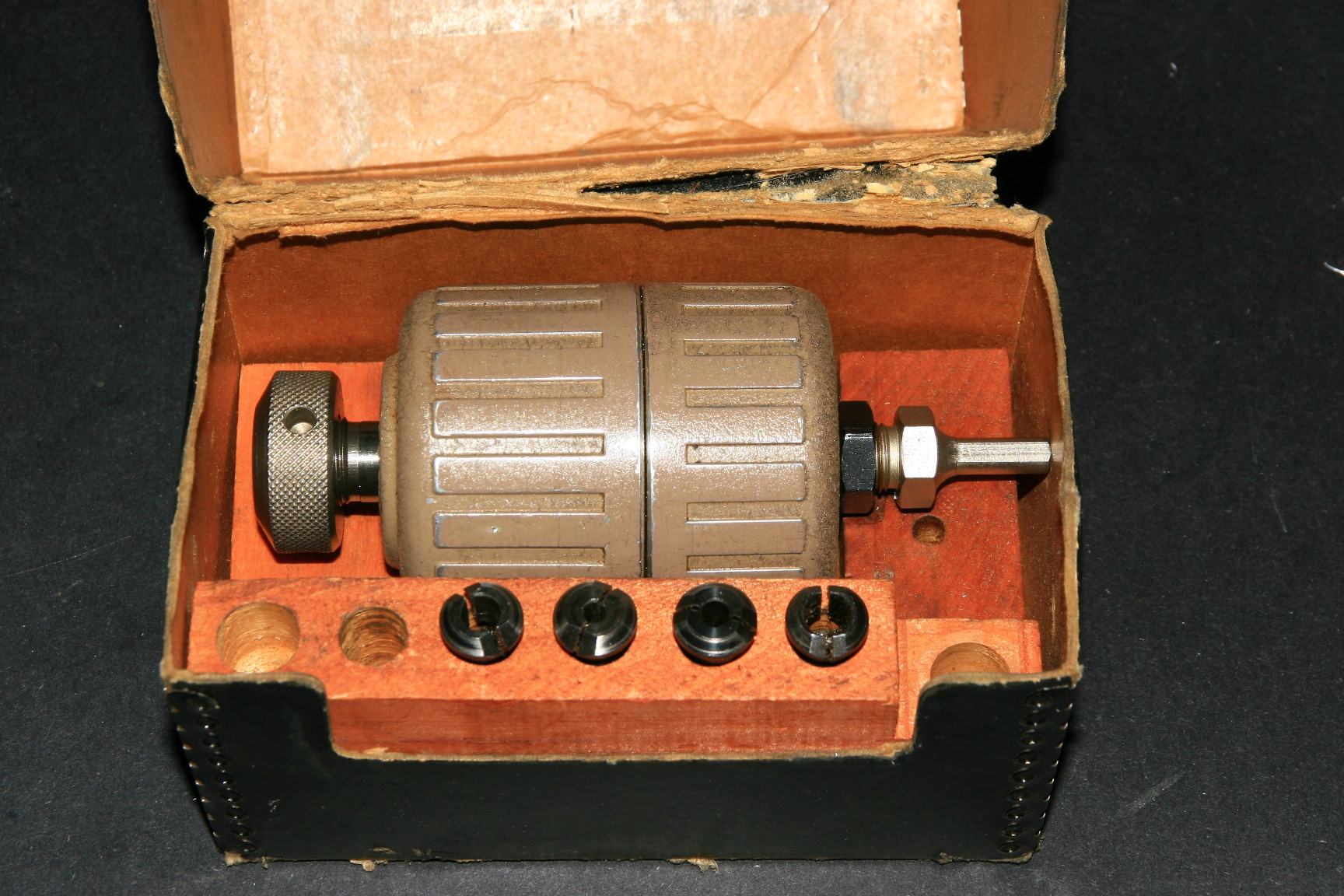

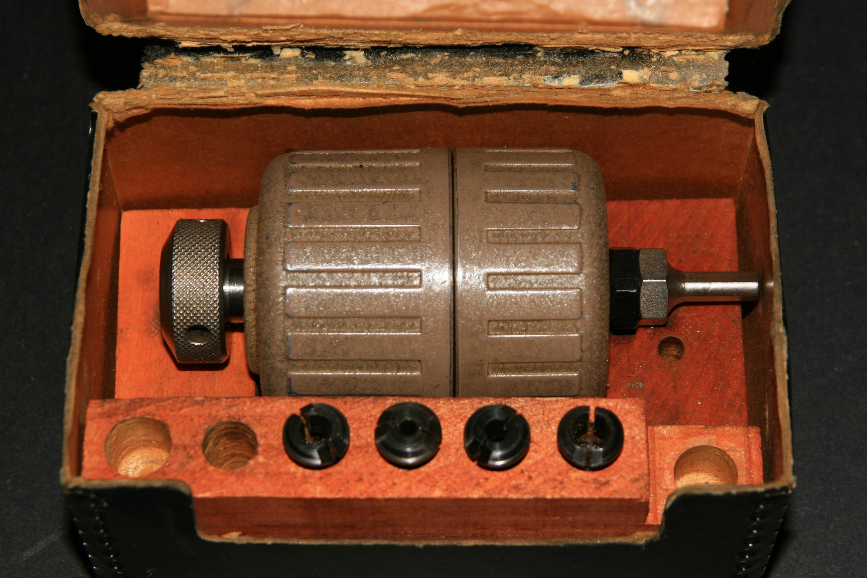

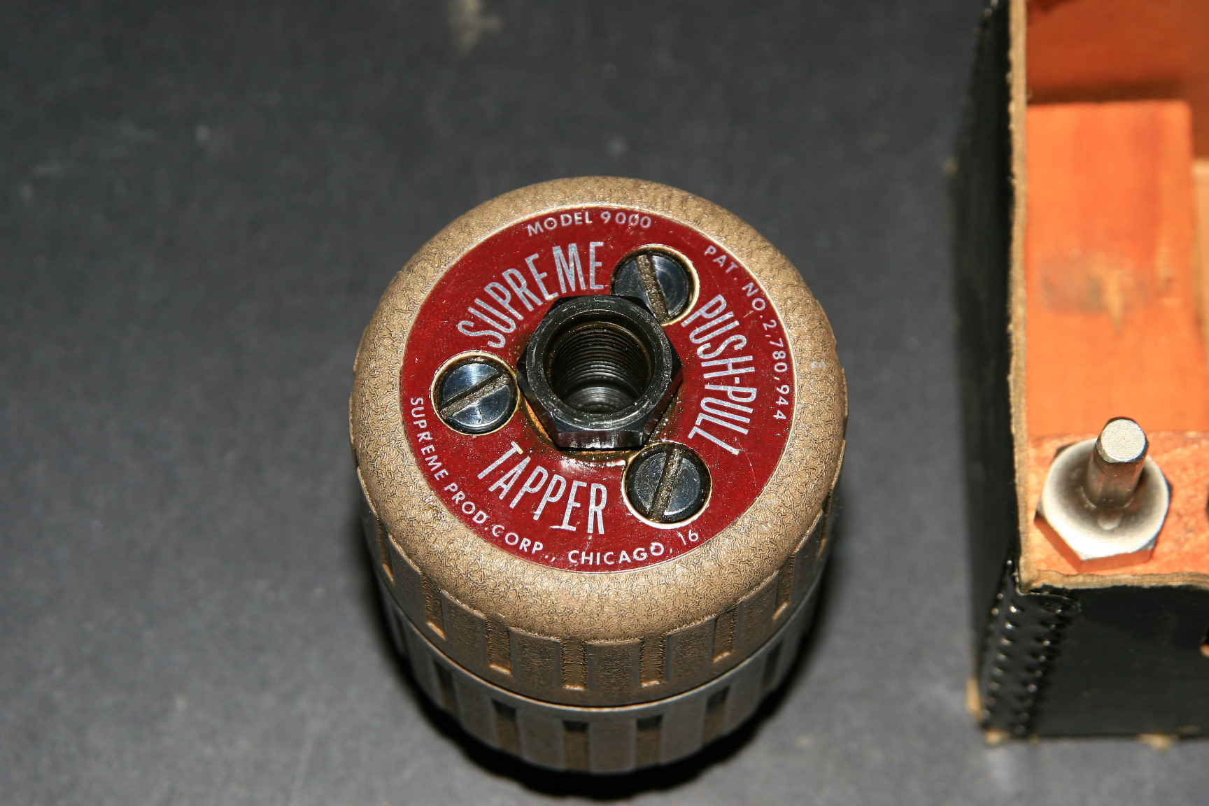

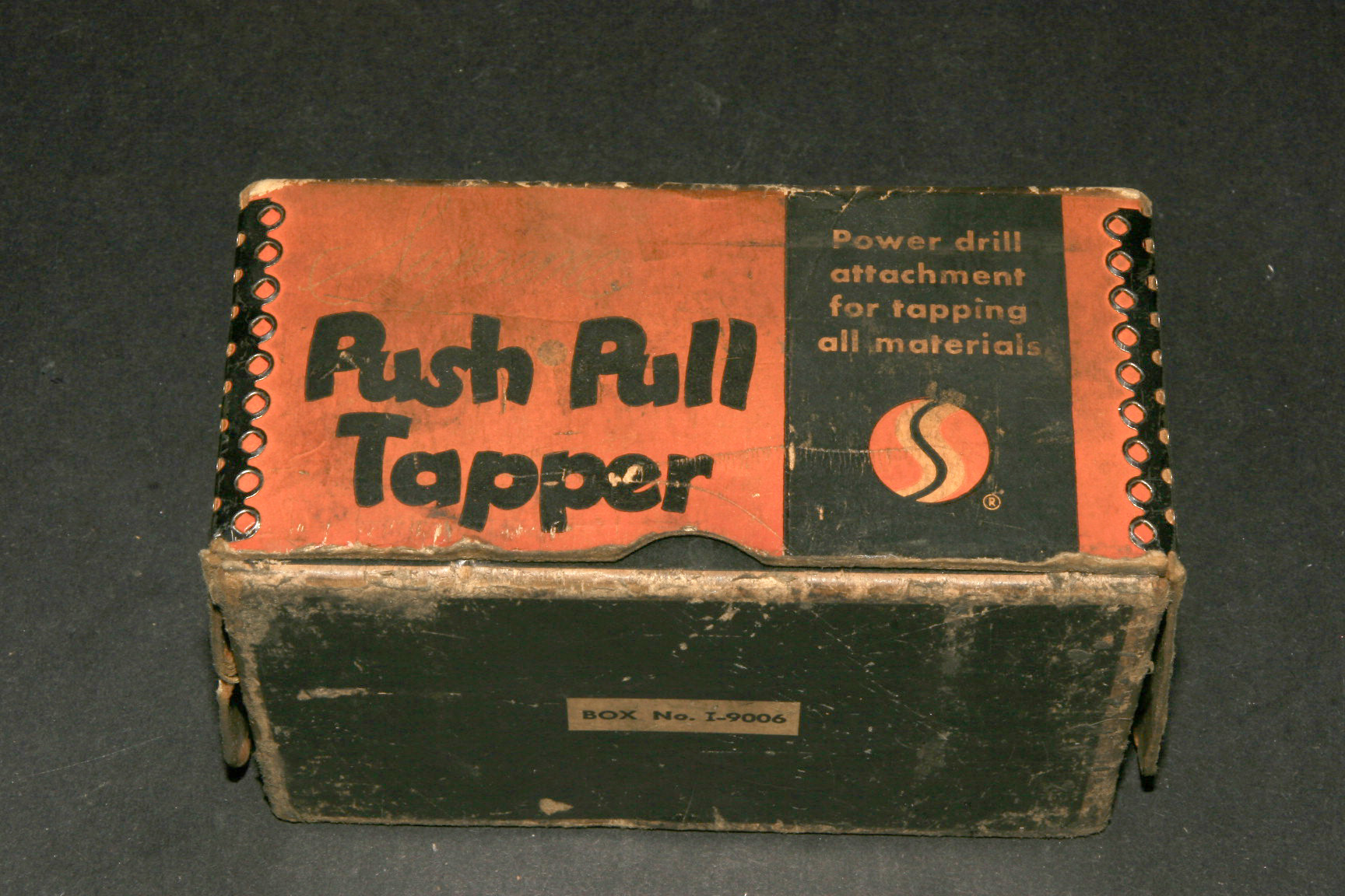

    Then all of a sudden a PushPull Tapper came up on the bay. Got it for $50.00 and it had 4 collets with it. Now this one
    looked like the one I really wanted. This is model 9000.
    Yep, it was the one! All you need to do is put in a tap. ( 4-40 to 5/16) collets are available but mine was missing the 6-32.
    Thats ok since my main use will be 10-32, 1/4-20, and 5/16-18. I would not even try this with 6-32 or smaller.
    Here is the difference in how it works. Start DP with unit in the DP chuck, bring down the quill and the tap sill start as soon as you
    grip the rotating collar. When deep enough just release your grip, raise the quill about 1/2" and grip the other rotating collar.
    That's it. You do not have to stop the DP and you do not have to "unwind" the Tapper 1 1/2 turns like you need to do with the others.
    I think all of these were made to be used with a portable drill motor. Supreme makes a Versatapper that was made for a drill press
    and has a capacity of up to 1/2" taps. I think you also need special Supreme collets for that one.

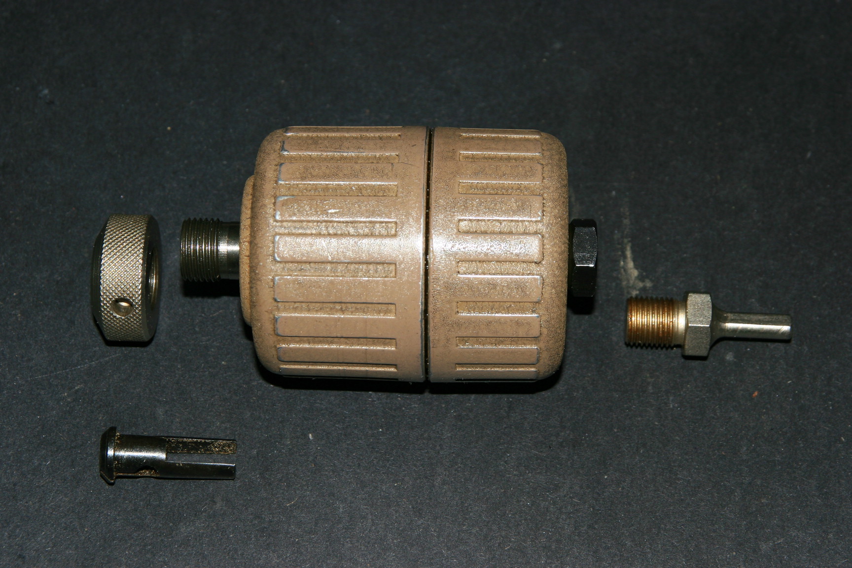

    Here are the differences between the units as the method for attaching chucks or collets is different as well as the driving spindle.
    I will first describe the PushPull Tapper and then post two more times with the pictures and descriptions of the other units.
    The PushPull Tapper has 5 (I think 5) unique collets for holding taps. It does not hold screwdriver bits.
    It is not made to hold a chuck but is made to be used with special collets.
    The nose thread is 5/8-16 and the "nose nut" fits that thread for holding in the collets.
    The drive side has a 1/2-20 thread and the unit came with a 1/4" to 1/2" arbor.
    I don't care much for that 1/2 to 1/4 adapter and will replace it with a 1/2-20 adapter.
    Reversing is semi-automatic. No need to stop the drill press.
    Well that is it for the PushPull tapper. Here are the pics for it.
    Cheers, JR
    Attached Thumbnails Attached Thumbnails PushPull Tapper Three types displayed with differences-img_2492.jpg   PushPull Tapper Three types displayed with differences-img_2493.jpg   PushPull Tapper Three types displayed with differences-img_2494.jpg   PushPull Tapper Three types displayed with differences-img_2495.jpg   PushPull Tapper Three types displayed with differences-img_2496.jpg

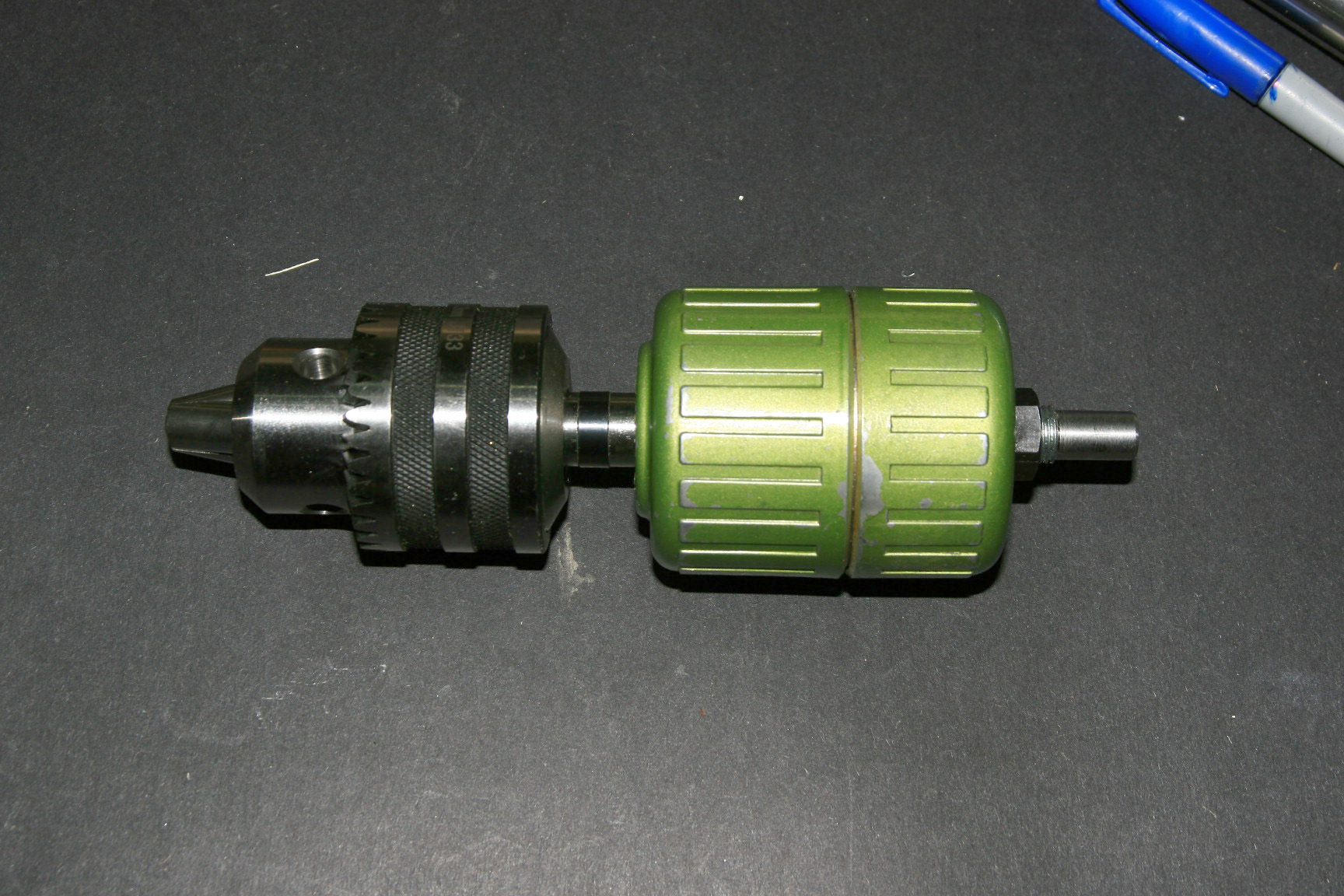

    Green Unit

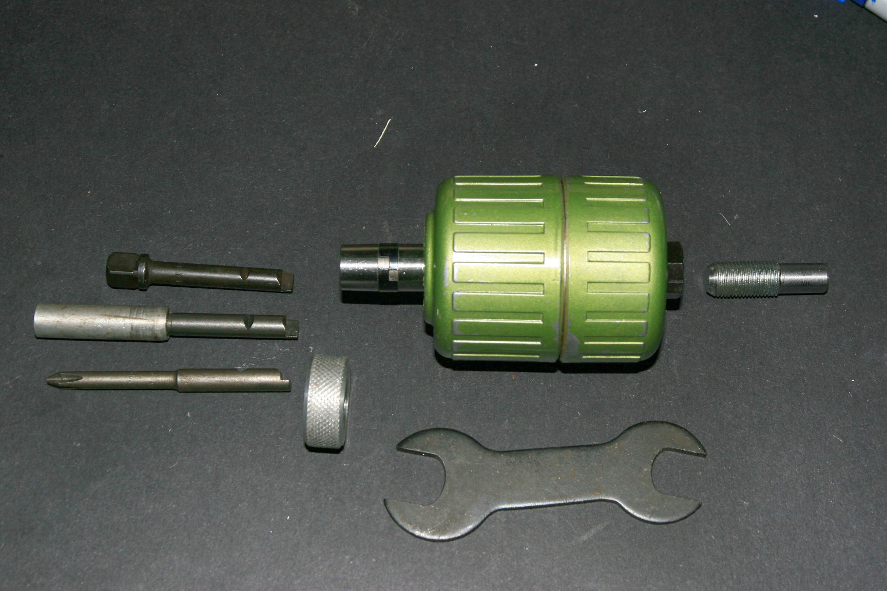

    Here are the differences of the Green Unit (Rigid Supreme)
    First off it is green. So you know right away that it is different.
    Then there is the drive side. It is threaded 1/2-20. Good thing since it came without an arbor.
    Now the real difference is the front end. It has a JT1 taper on it and the aluminum "nose" piece fits on that taper.
    But wait. A drill chuck with a JT1 will fit there too.
    I added a Jacobs chuck and now it can grip taps. So far with my 1/4-20 it works great. No Slip, no bunch, you know the rest.
    It operates exactly the same as the model 4100. No actual model number on it, just a place for two numbers to be punched
    followed by 00. Whatever, I know what it is since it is Green!
    This one had an instruction manual.
    It is in the best shape of all of them. Quite snug works fine.
    Cheers, JR
    Attached Thumbnails Attached Thumbnails PushPull Tapper Three types displayed with differences-img_2497.jpg   PushPull Tapper Three types displayed with differences-img_2499.jpg   PushPull Tapper Three types displayed with differences-img_2500.jpg

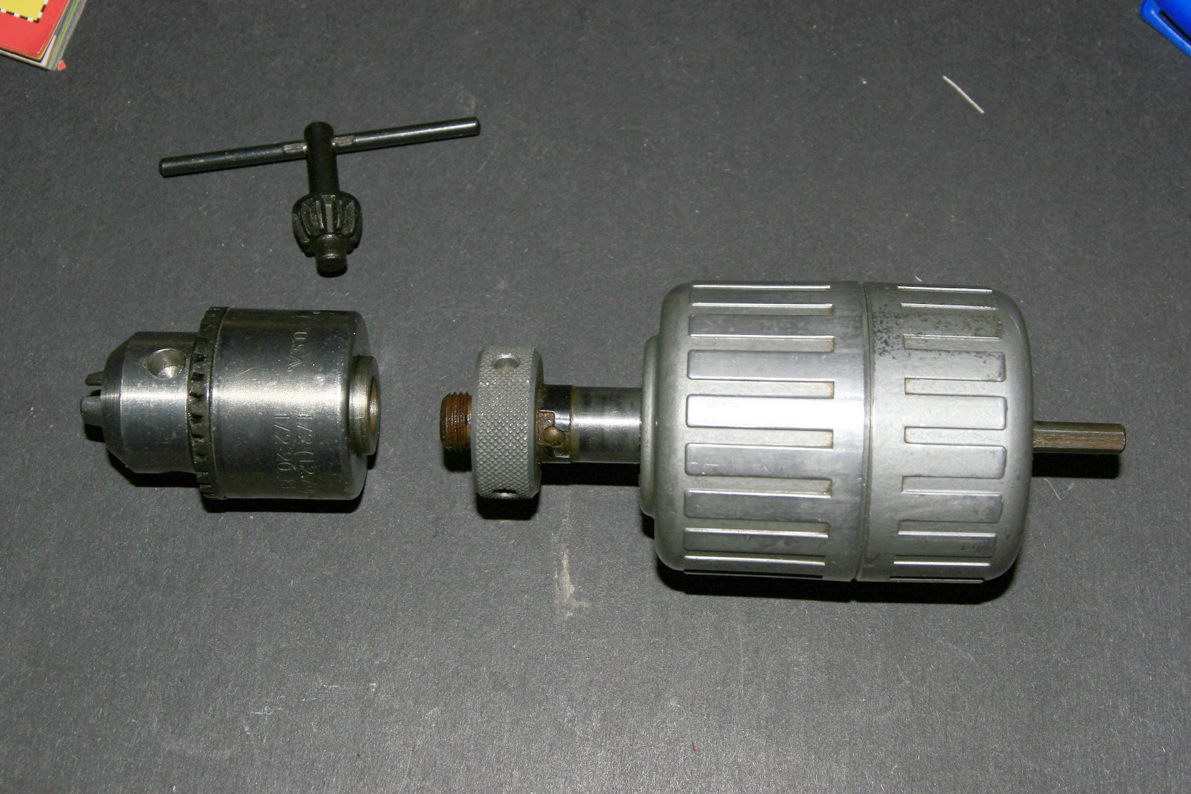

    Model 4100 Supreme Reversible Gear Reduction
    Here is the 4100. Just that same old gray color. Looks a bit Navy to me. I like it.
    It was my first and the one that got me started looking for it's cousins!
    Big difference is the 1/4" input shaft. Not changeable like the other two.
    It works fine but is a bit long..
    The nose on this one has a 1/2-20 thread so it is easy to put on a chuck.
    The aluminum nose piece on this one is frozen in place. It may be hiding a
    morse taper under it but this one is not coming off.
    Best practice for this tool in my thinking would be to get a small dedicated drill press with
    maybe say a MT2 or MT3 spindle. Then get an Morse arbor that fits that drill press with
    a 1/2-20 threaded end. Now if you can find a PushPull Tapper with collets you have a
    dedicated tapping setup for small sizes up to 5/16". By eliminating the original DP chuck
    you will gain head space and a shorter tool string.
    Next option is to buy a Supreme Versatapper and use it on your drill press.
    Cheers, JR
    Attached Thumbnails Attached Thumbnails PushPull Tapper Three types displayed with differences-4100supreme.jpg
