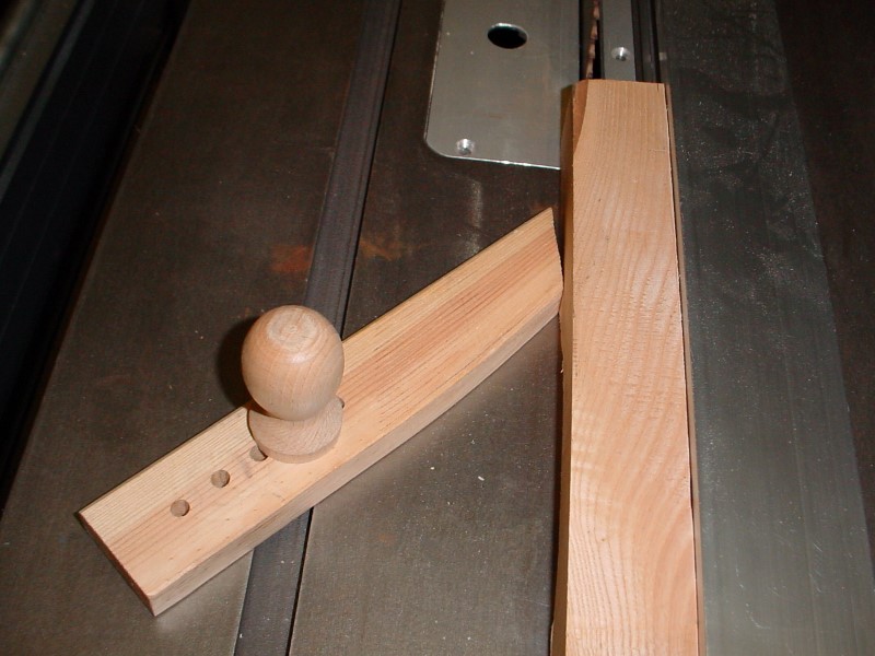

    Here is a nice little thing very very useful :

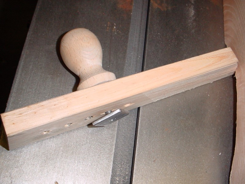

    The nice trick is that it can be used on different tables, you just need to put the screw in the proper hole, depending on the distance between the table T slot and the piece, and need to change the little square nut to adapt to the T slot of the table.
    Cheers !

    Interesting take on a featherboard. Well done Christophe.
