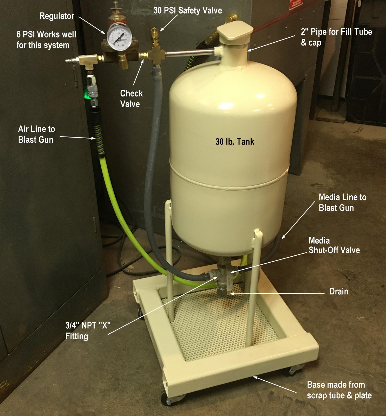

    PA blaster made from a discarded 30 lb. propane tank and scrap tubing & perforated steel plate.
    I have seen plans for these for a long time and wanted to build one.
    It does work much better than the siphon feed system in my blast cabinet.

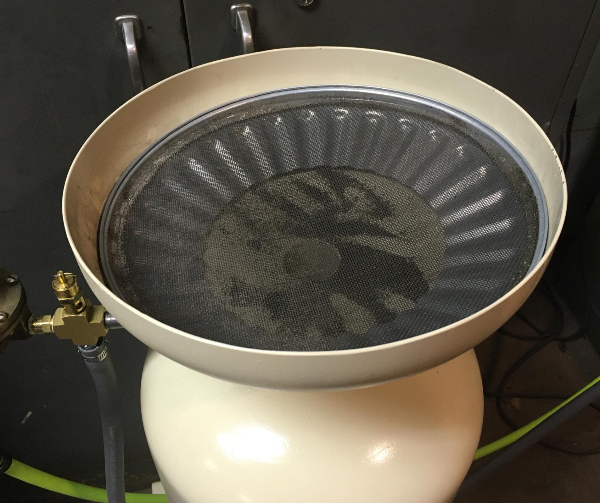

    The fill funnel was made from a portion of a 21 lb. propane tank and a piece of pipe. It allows the use of a screen and avoids spillage.

    Hello Tekcraft, thank you for sharing this.
    Could you share a tad more pics of the connections to the gun, I am a lot interested in building this on my own. Thanks in ahead.

    I don't have a photo right now but the connection is a standard connection like any suction gun system has.
