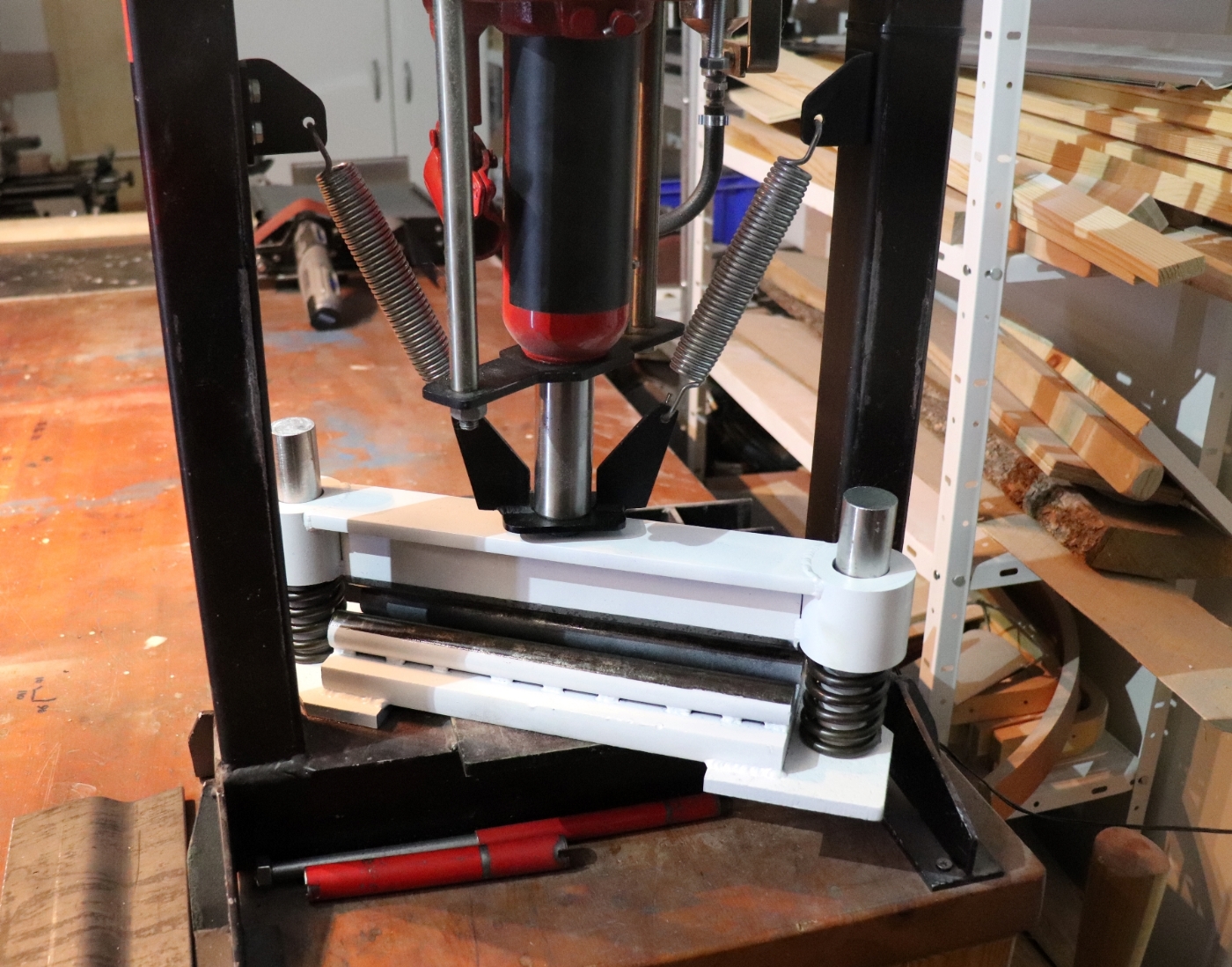

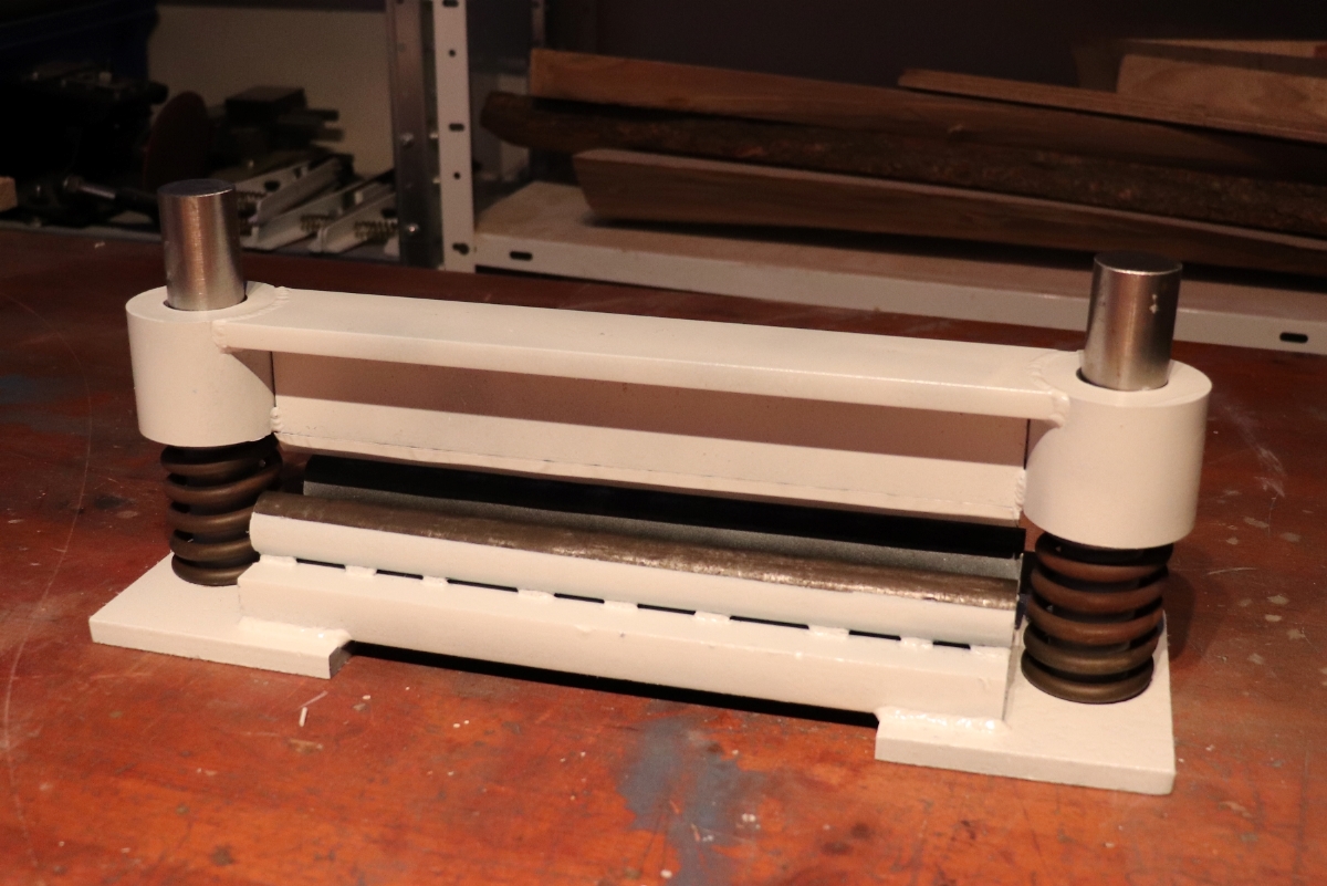

    Made a simple brake to my press.
    Info about mounting the jack: http://www.homemadetools.net/forum/m...255#post109941
    Info about the actual press: http://www.homemadetools.net/forum/h...615#post104791
    Allows to bend max 310mm wide 5mm sheets with 15mm radius.
    Material is 10mm thick steel plate, valve springs from a truck and machine steel (SBQ) for the blade guides.
    Video about the use: https://www.instagram.com/p/BsQqEcbg-wS/

    Nice little Press Brake Tuomas! Great addition to your shop! Did you put bushings in the upper post housing?
    PJ
    Thanks buddy. Nope. Jack and the post / blade are are at the same line, so blade stays straight enough without pushings.
    Housings are made from pre-machined tube here its called " ainesputki" its sold in hardware stores. I found suitable axles from the eye bolt. So i got good enough fitting without lathe.
    Cost for the material was about 25$.
