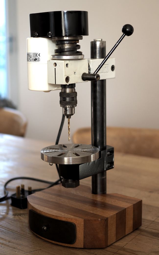

    I have an Emco Unimat 3 lathe that I've had for a long time:
    Emco Unimat 3 – glue-it.com
    However, although the pillar mill/drill attachment is really useful it is a pain to keep converting the lathe between mill/drill and lathe. This got me wondering if I could buy another pillar on ebay and make a base and table for a permanent pillar drill.
    The full article is here:
    Unimat 3 Pillar Drill – glue-it.com
    I've got a slightly more powerful sewing machine motor for it now and this also rotates in the correct direction so that it can hang down under the pulleys. The result is a tiny pillar drill that sits perfectly on the model making bench. Overall it is around 40cm high.

    You have a great idea. The conversion and adaptation of the mill/drill attachment is nicely made. Also thanks for the link to your website.

    NICE!!!! I have planned to do something similar, only using SL1000 & DB200 parts, to make sort-of a Unimat 3..... BUT mine will bolt to the bench when I'm done....

    I've updated the Unimat Pillar Drill - the bracket that holds the table was never quite right with regards to the accuracy of the hole and so the table was not quite dead upright. So I filled the hole with Durafix and then machined the hole again in place on the pillar drill.
    It's now absolutely spot on in terms of accuracy

    Nice Conversion Job!!! What is the drilling capacity in terms of max drilling depth and chuck capacity?

    the maximum chuck capacity is 9mm - but this can be increased if you use the 3-jaw lathe chuck
    the spindle is threaded 14x1mm
    Travel = ? will have to measure this along with the maximum throat

    I own a couple of Unimat DB-200 lathes so I know what they are capable of doing.
    I have not had a Unimat 3 in my hands, so I am wondering what diameter the post is? I am assuming it is larger than the DB post and therefore more rigid...
    Could you tell me what the diameter is?
    Dick

    I've just measured all of the specifications:
    Motor power: 120W @ 7000rpm
    Ratios: 3.7:1 and 2.5:1
    Spindle speeds: 1900rpm & 2800rpm
    Spindle mount: 14x1mm
    Spindle travel: 25mm
    Throat: 64mm
    Max chuck to table: 122mm (3mm drill bit max is ~85mm)
    Dividing plate: 6, 8 and 10 holes
    Divisions available: 1, 2, 3, 4, 5, 6, 8, 10
    Table mount: 14x1mm
    Column diameter: 28mm
    Column length: 325mm

    The column is 28mm diameter and never had a problem with rigidity of the column and have used this for gear cutting.
    I have a Hobbymat lathe and I fix this column to the cross-slide and an indexing plate to the back of the hobbymat spindle:
