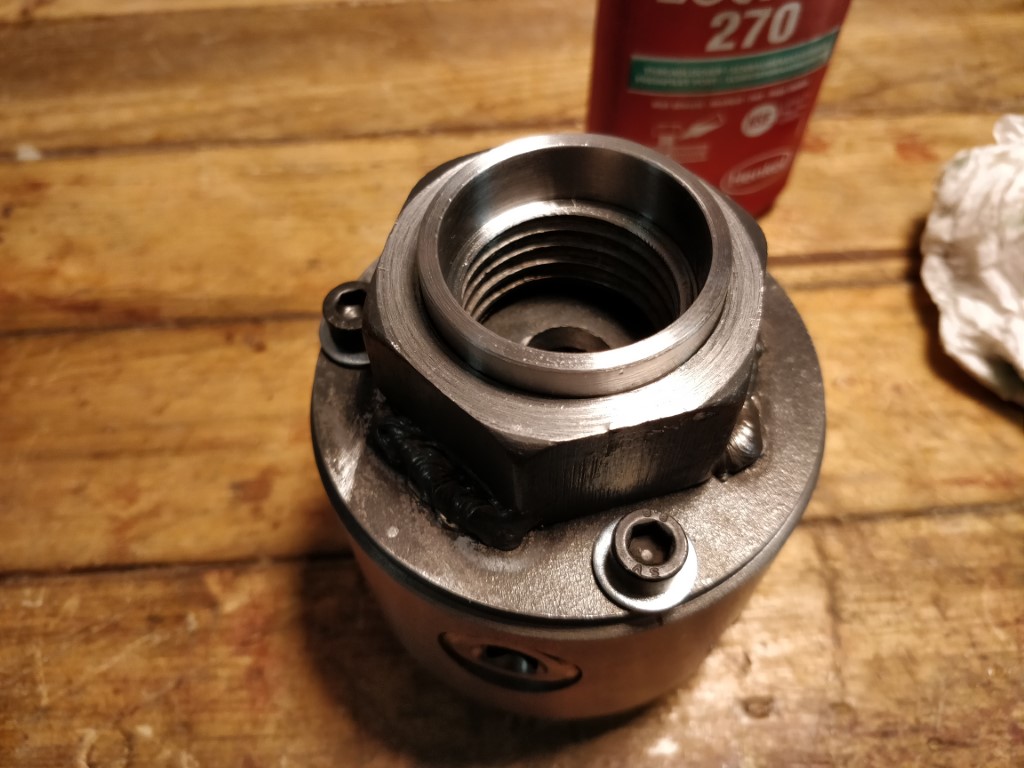

    First I use a big M33x3.5 nut. I face it on the lathe, using my slide adaptation for the tool rest.
    A 80mm flat stock blank.
    Turning it round on the metal lathe.
    I mounted the nut on the spindle and applied the plate, centered with the live center, and glued with a few drops of CA glue in order to keep it centered until I weld the parts.
    Welded on 3 faces only, keeping the 3 others free for getting room for the screws.
    Turning down the rabbet for the back of the chuck.
    Drilling the holes.

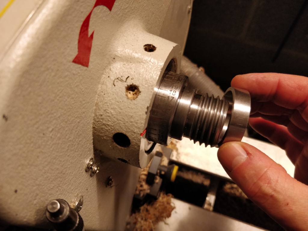

    Here I changed my mind.
    I initially thought that the nut would center well enough, hitting the first shoulder after the threads on the spindle.
    Unfortunately, it was not. Screwing/unscrewing the nut turned out to be non repetitive and not accurate with respect to keeping it's center.
    Having a look at how the regular wood chuck is centered, I realized that it is centered on and against the next shoulder of the spindle.
    So I decided to turn a ring in order to precisely fit that shoulder.
    Here is where the ring goes, I still have to accurately fix it to the back of the nut.

    So, I bored an inner shoulder to just fit my ring.
    I was first thinking to weld this ring but I eventually decided to simply glue it with Loctite.
    There is no traction effort on that ring, and this Loctite is already very strong.
    Now I have the ring installed, I had to touch up a little bit the rabbet for the chuck.
    And here it it. I had to shim with a piece of paper behind a screw, and I reached an off center error within 0.02 mm at 5 cm on the rod, which fully accurate enough for my needs.
    This little chuck is really nice and very accurate, and can hold small pieces, far smaller than a wood chuck would do.
    I'm very happy with it and it is already at use every day I work on that lathe.
