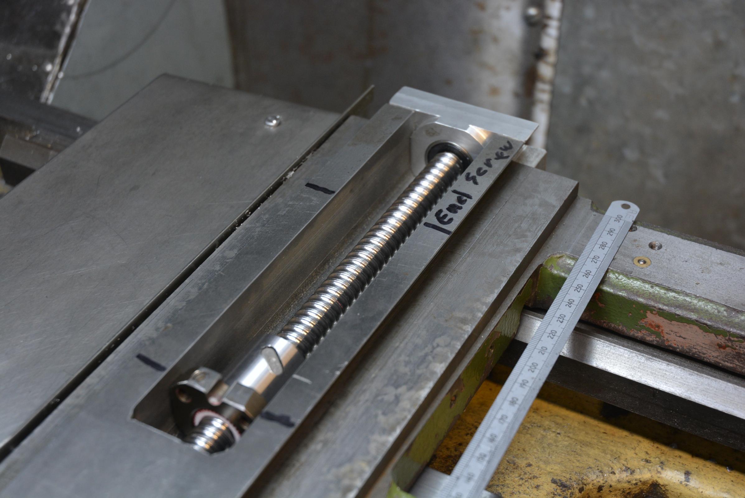

    Any data on the ball screw cross slide enhancement would be much appreciated, at least by me...

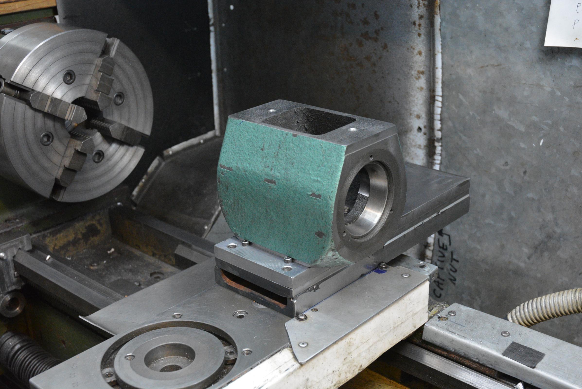

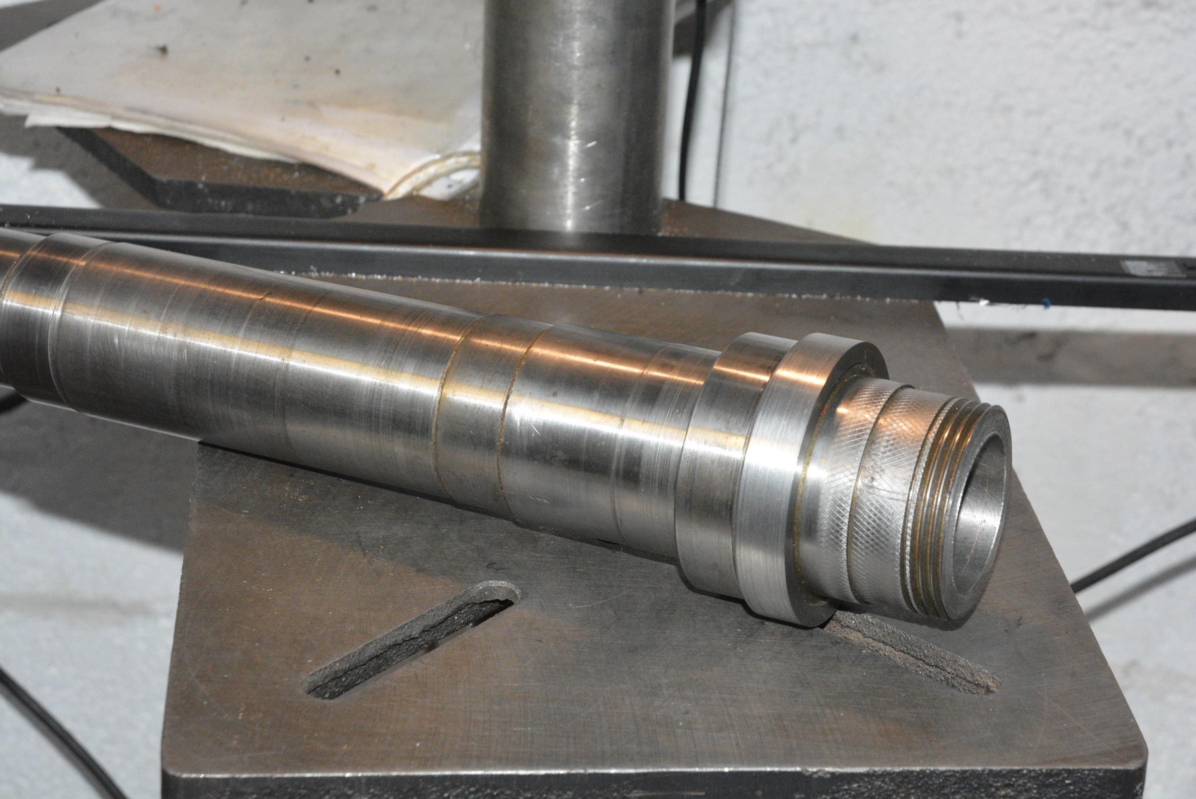

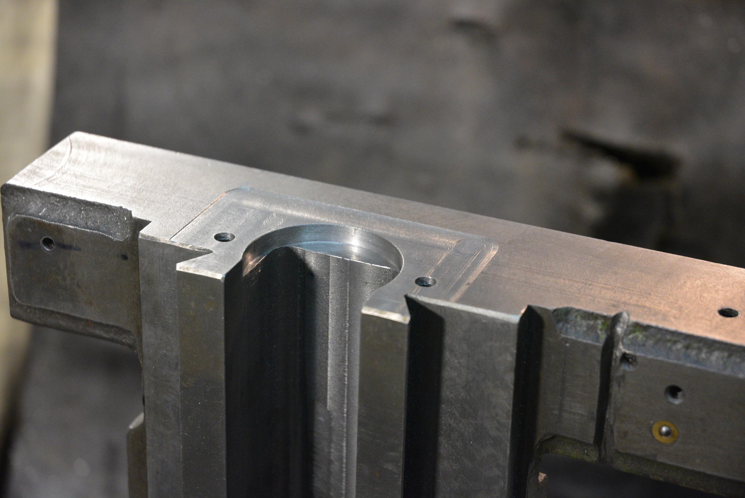

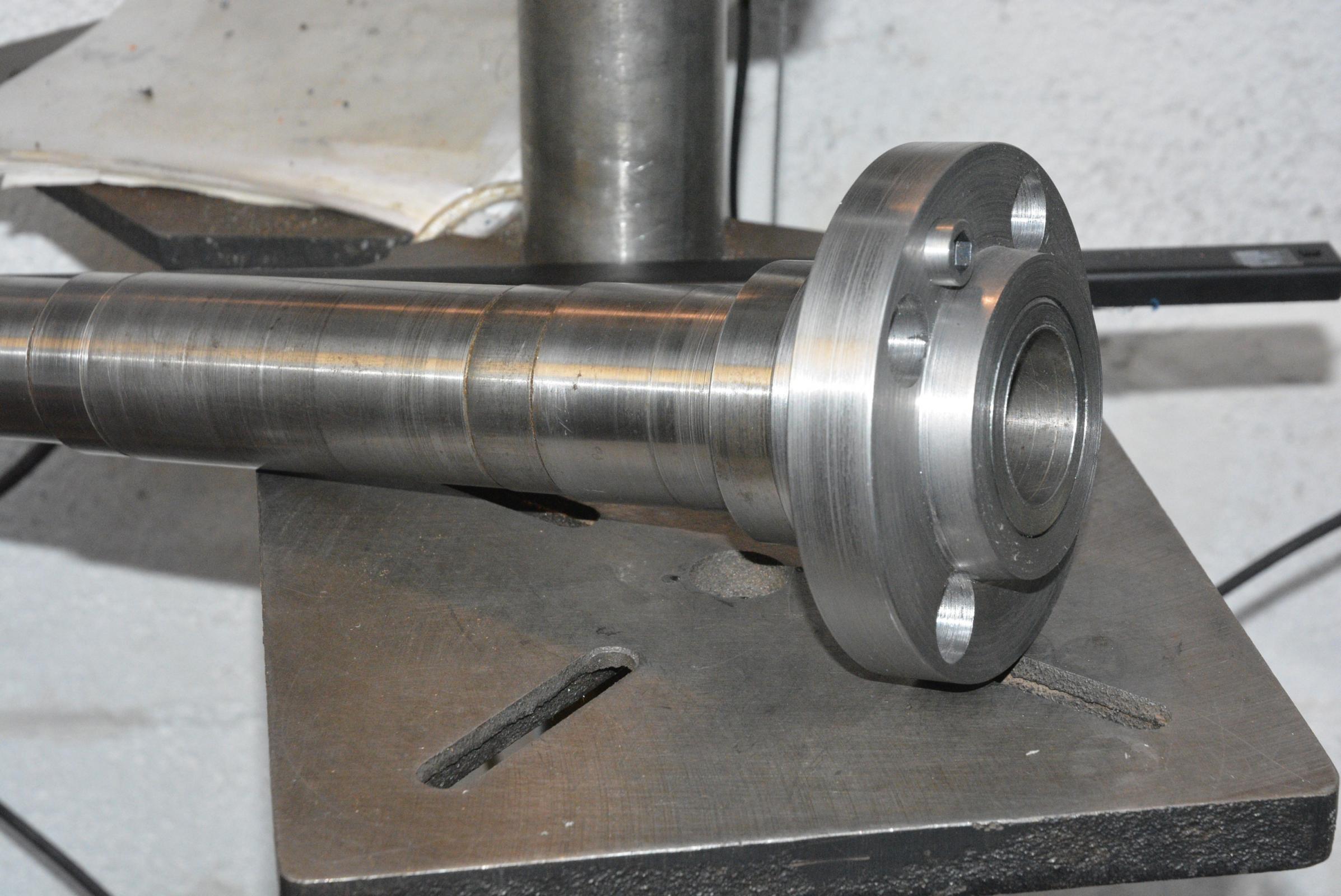

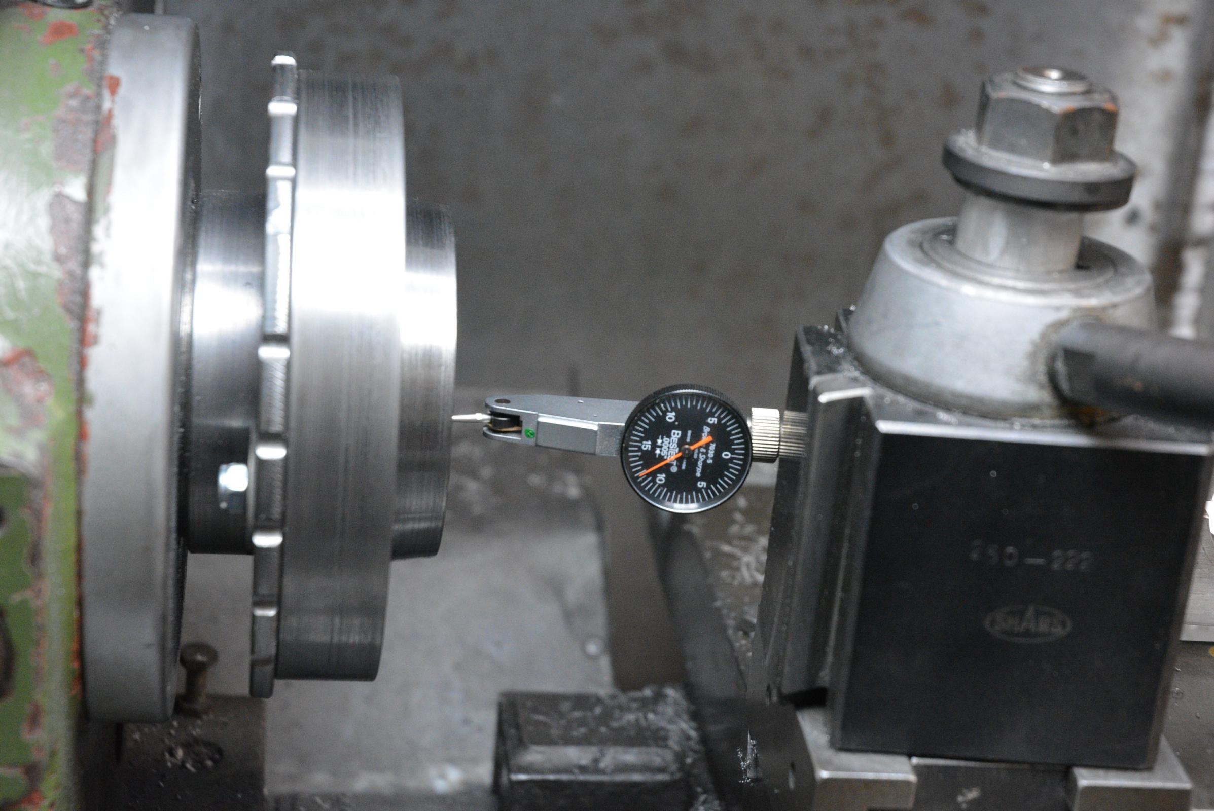

    I do plan to make posts on both of those subjects and also another recent job, I converted the screw on chuck mounting to a Bayonet type. This provides for a quicker chuck change, a more accurate chuck change and the ability to run backwards. Here are some teaser pix.
    Precision Grinding a Hardened Shaft with an Improvised Toolpost Grinder-dsc_2961.jpg Precision Grinding a Hardened Shaft with an Improvised Toolpost Grinder-dsc_2939.jpg
    Precision Grinding a Hardened Shaft with an Improvised Toolpost Grinder-chuck_mtg_36.jpg Precision Grinding a Hardened Shaft with an Improvised Toolpost Grinder-chuck_mtg_37.jpg
    Precision Grinding a Hardened Shaft with an Improvised Toolpost Grinder-chuck_mtg_57.jpg Precision Grinding a Hardened Shaft with an Improvised Toolpost Grinder-dsc_3182.jpg

    Grinding tapers using the compound was one of my objectives so that drove the design along with budget. I wish I had a better chuck mounting system but the two setscrews on the neck of my screw on chuck do a reasonable job of keeping the chuck on when run in reverse. I do check that it's staying tight periodically though.

    Nice work Tony, I am particularly interested in your bayonet chuck mounting conversion. I have long thought of a way to convert my screw on chucks while keeping the original mandrel (plain bearings) judging by the marks on your mandrel it would appear to be the original. I am thinking modern adhesives may provide the answer but any ideas would be well received.

    I'll make a post on that topic separately. When I got my lathe it came with a spare spindle with a bit more meat at the chuck end. So I was able to still use the lathe for preparation of the other.

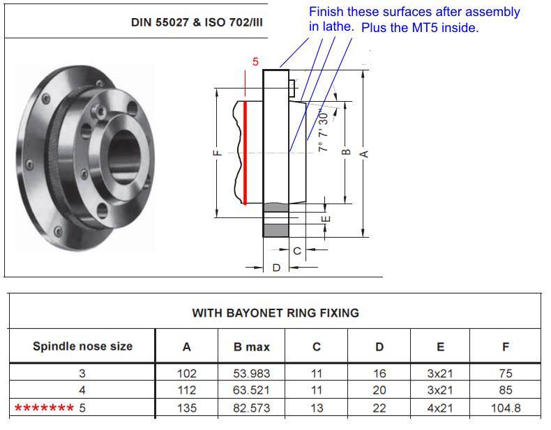

    Nice Tony! I’m kind of confused by the term “bayonet”. It kind of looks like the beginning of a Long style or “D” type taper mount. Or were you referring to sumptin else?

    As I said in my original post here. I shall be doing dedicated posts on on each of the three things mentioned, but to answer your question briefly. My preference is for the long nose taper style but that would have required making a lot of swarf from big lumps of steel or CI for the chuck backplates, whereas the D style or bayonet only needed a minimum of work modifying the existing backplates. "Bayonet" is not my term it is a recognised standard. The taper dimensions etc. are mostly the same as a D type. There will be full details in the dedicated post. Meanwhile
    Precision Grinding a Hardened Shaft with an Improvised Toolpost Grinder-chuck_mtg_64.jpg
