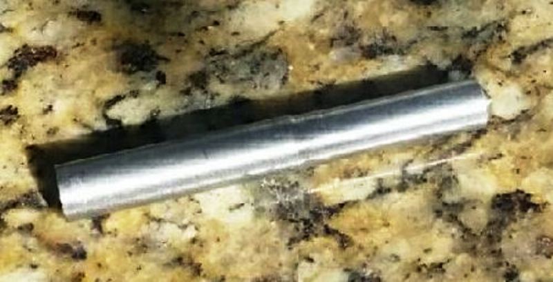

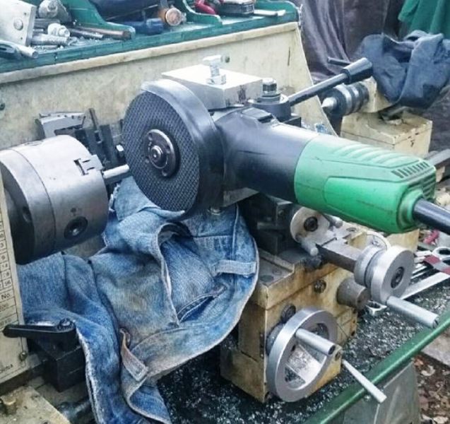

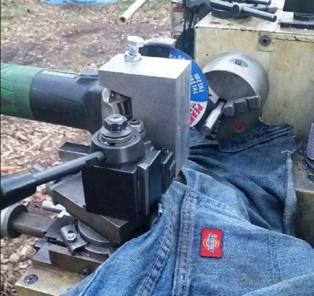

    After the upgrade of my toolpost stud my angle grinder would no longer mount onto the compound so today I reworked the mounting scheme for it to attach it to my QCTP using a tool holder. I machined a bar of steel which then bolted to the aluminum block and the bar then goes into a tool holder, so the toolpost stays on the lathe if I want to use it. I reoriented the grinder due to the change in the mount and now it extends horizontally outward rather than upright as before. I was surprised to find that it's more rigid and delivers a nicer finish, even with the 80 grit wheels that I have, and it goes on and comes off the lathe a lot quicker so I'm happy with this transformation.
    Precision Grinding a Hardened Shaft with an Improvised Toolpost Grinder-mount-2.jpg Precision Grinding a Hardened Shaft with an Improvised Toolpost Grinder-mount-2b.jpg
    Precision Grinding a Hardened Shaft with an Improvised Toolpost Grinder-test-grind.jpg
    Here's a test grind. Accurate within a few tenths on the diameter (.4989 - .4993).

    Do the bolts in the AL block just clamp onto it or do they thread into the grinder body? While trying to make a much simpler guide bar for mine I discovered the threaded hole I was using it attach it was not perpendicular to the axis of the shaft but canted up a few degrees...grr

    The bolts go through the block and thread into the handle holes on the grinder head, then nuts on the bolts fasten the block to the grinder head.
    If you look closely you'll see that my bolts are tilted to match the grinder handle holes and it was a challenge machining that block of aluminum so that it all fit, working from measurements that I made of the grinder. It's plenty solid but if I were doing it again I might try to hold the grinder using clamps on the body, or perhaps adapters that fasten into the handle holes and then some sort of attachment to the hopefully parallel adapters.
    I don't have to worry about the pants, they're not mine. ☺
