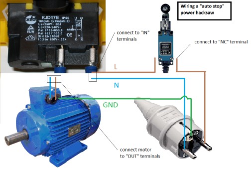

    After a long break, I did some work on the saw, mostly electrical. A few more details, some paint, and we can call it finished

    This is how I wired it
