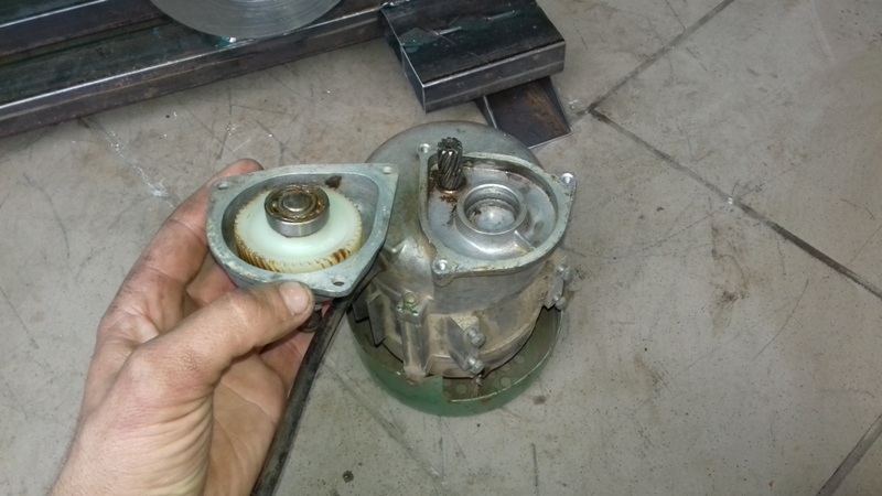

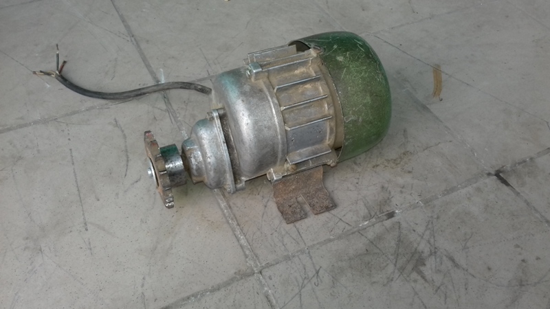

    I will add information about the motor. This is a German Grunhain with 240 watt with a built-in gearbox.
