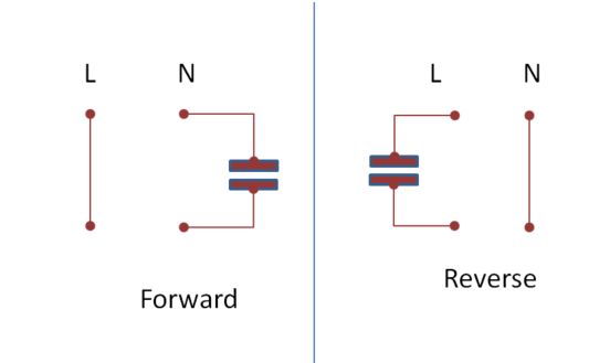

  13. #40
    Jul 2017
    Port Elizabet, SA
    246
    92
    Thanked 443 Times in 109 Posts
    garage nut's Tools
    Power Hack Saw help needed-motor-direction.jpgGood day guys
    1) Question still...If I want to make the legs stiffer, do I weld another piece if angle to the leg, forming a box or just use a piece of 30 x 30 solid. I have to go and buy either.
    2) I can change the direction of my motor by removing a bridge and fitting a Cap and then fitting the bridge where I removed the bridge. What is the normal way of doing this with a switch? do I buy a second cap or is there a special switch I must ask for.
    3) To reduce the speed of the motor I will used an idler shaft with pulleys, Will a piece of normal 20mm mild steel be ok for this shaft.
    I want to use this power unit to drive my ring roller I am also in the process of making. Huge thing to roll 60mm 3mm walled pipe for a car chassis.
