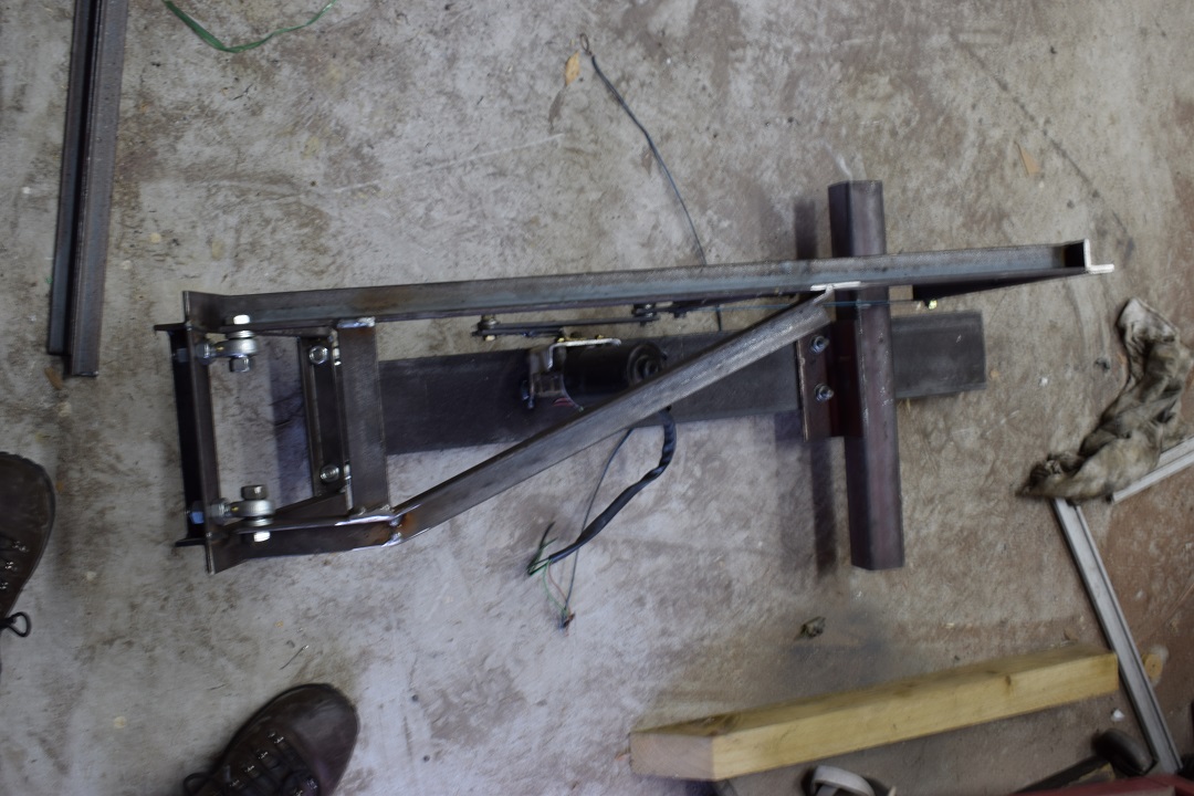

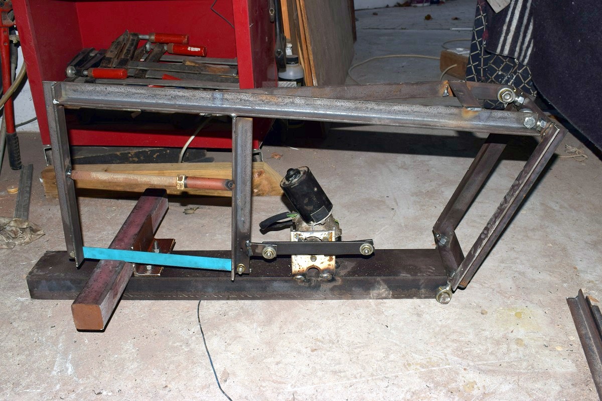

    Saw is working. Needs finishing off, proper vice, switch, arm rest and a coat of paint.
    Power Hack Saw help needed-powersaw.jpgPower Hack Saw help needed-power-saw-top%5D.jpg
    I must say it is very slow, so will start by adding weight to the arm.
    I drilled the holes to mount the blade 2mm longer than the blade pitch in an effort to avoid a complicated and time consuming blade tensioner, but the blade wobbled on its first cut. I then added the 16mm threaded rod. nut and piece of pipe to push the two arms appart and add the desired tension.

    Can only offer a hint here; but a current and pro-grade hand hack saw uses threads and an over-centering lever, stipulating 50k of blade tension. The current designs of good saws are rectangular tubing and diecast fittings. They cut like no hack saw ever did in the past, easier mechanically to tighten and rigid frames have to be the root.
    Can't think of a measuring instrument at low cost. However, it shouldn't be too hard to generate a linear formula calculating 'X' amount turns of a known pitch produces tension of so many pounds per revolution.

    I almost never criticize anyone's build and I will not do so now.
    I will offer a couple of hopfully helpful comments though.
    Looking at your frame design I note a couple of potential flaws the use of angle iron for your legs that the blade is attached to might not have been the best choice but be that as it may I believe you need to box those legs from as high up to as far down as possible to add more rigidity to the frame As it is currently made I have reservations as to whether or not you will be able to acheive enough blade tension to ever obtain true straight cuts. Right now it looks like you could tighten the adjusting screw until the legs of the frame actually bend and never get the blade tight enough to run true.
    Additionally you mentioned adding weight to have more down force on your blade. Having the ability to add or subtract weight will help in making cuts on the different types of materials you intend to cut However back dragging on the teeth will greatly shorten the life of the blade to overcome this some additional mechanisms in the way of possibly a rotating cam of an up lifting link that causes the frame to raise slightly on the return stroke relieving the load on th teeth as the blade returns. It looks like you should be able to do this by adding a cam to the motor spindle easy enough but the link bar which would be raised by th ecam may be a little more complex.

    Material used is all 30 x 30 x 5 angle iron. Pretty solid. There is almost no flex while sawing.

    The previous comments by two extremely experienced contributors were in the spirit of helpful advice to do that very thing. i.e. improve what has been made. To simply ignore such advice would be less than sensible. That doesn't mean that the advice should necessarily be followed, just that it should not be disregarded out of hand.

    Have you retained the fibre gear in the wiper motor. When these motors are used in garage door etc. applications the worm is usually replaced by a brass worm. I am a bit dubious as to the amount of load a fibre gear will withstand. Otherwise a simple and practical application for a motor that already employs a reciprocating action.

    Nice job Mr. Garage Nut. I have to dispute Mr. Toolmaker51's recommendation of 50k blade tension unless he really meant 50kg which is much more like it. 50,000# would bend the frame into a pretzel.
    I did find this recommendation (at https://www.g-w.com/pdf/sampchap/9781590702499_ch12.pdf ) of 100kg which is 220# (avoir du pois). "Tighten the blade until a low musical ring is heard when the blade is tapped lightly. A high-pitched tone indicates that the blade is too tight. A dull thud means the blade is too loose."
    Here's another good power hacksaw blade link: Technical Information for the Hacksaw Blades : Pilana
    For now, a "C" clamp would serve as a vice.
    Good job. Ive touched up you photos a bit so I could try your idea myself. I have tried to design one using a clothes washer transmission like one shown in an old magazine (Popular Science?) but it was hopeless. There just wasn't enough detail.

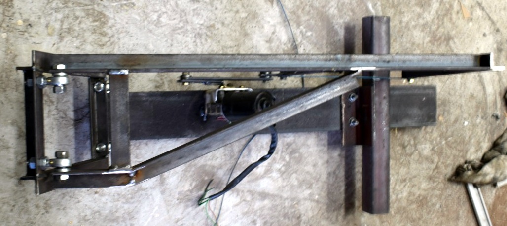

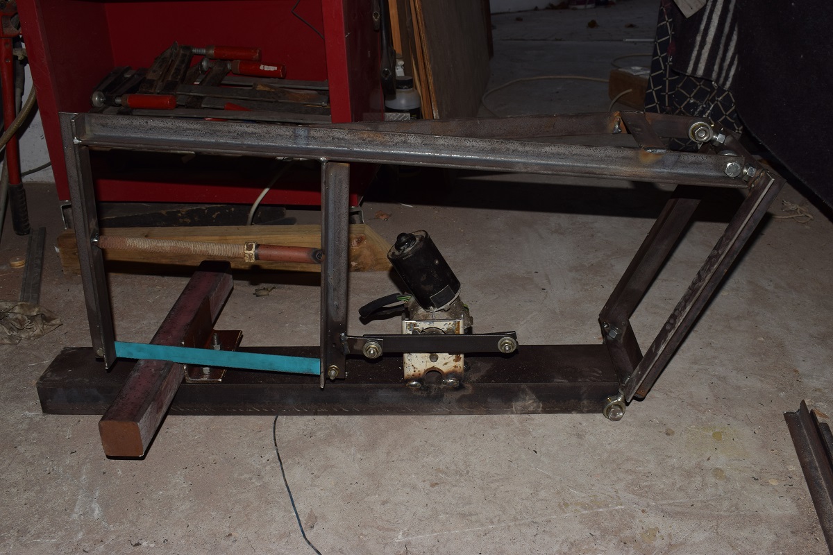

    Thanks for sharing.
