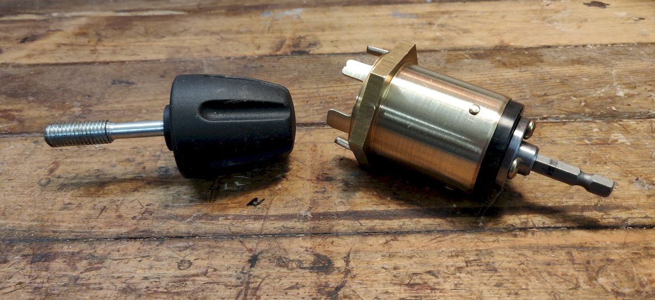

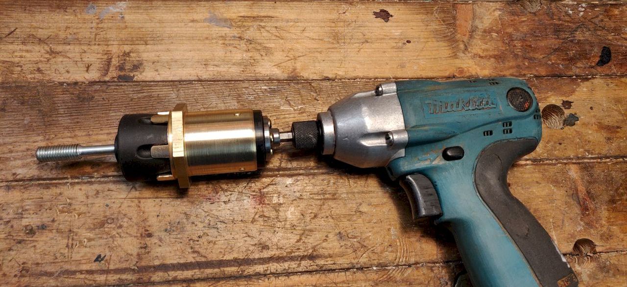

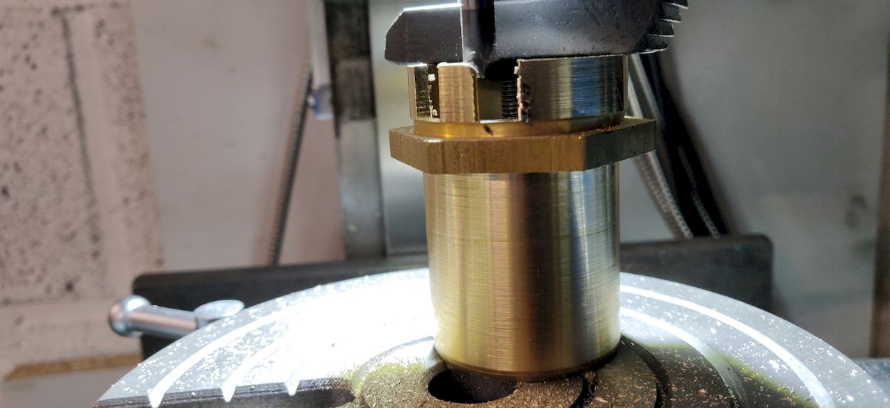

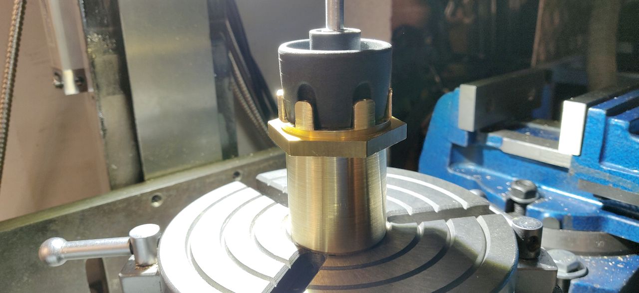

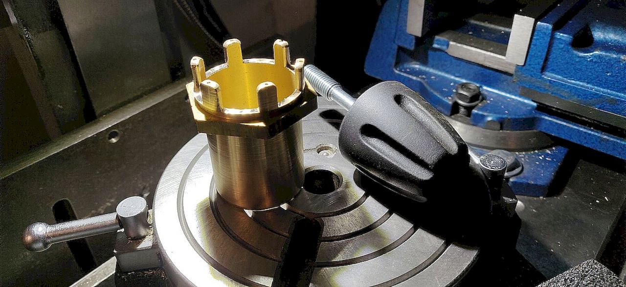

    Hi,

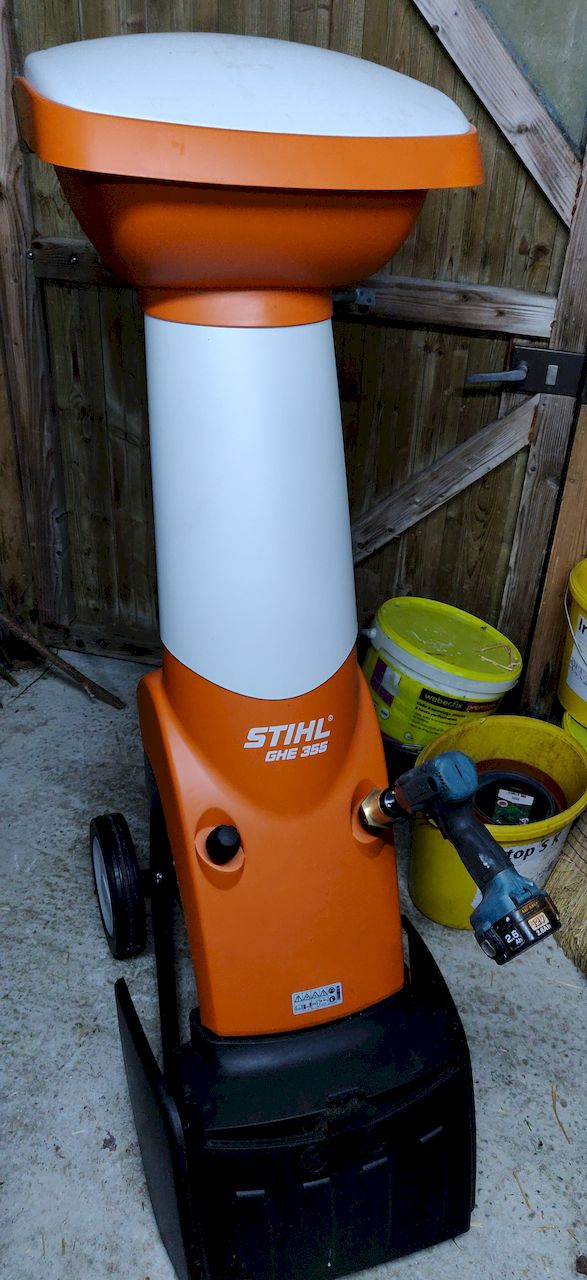

    My Stihl shredder is a great gardenning tool, it's powerfull and reliable, but it is inevitable that from time to time, it gets clogged...

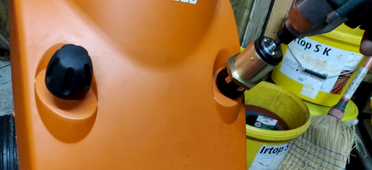

    To fix that, you need to unscrew both of the black knobs on the front (maybe 20 revolutions each), clean the blades up, re-screw both of the knobs, start again, and sometimes, it can happen more often than desirable, you get quickly tired of screwing, unscrewing with both hands ...

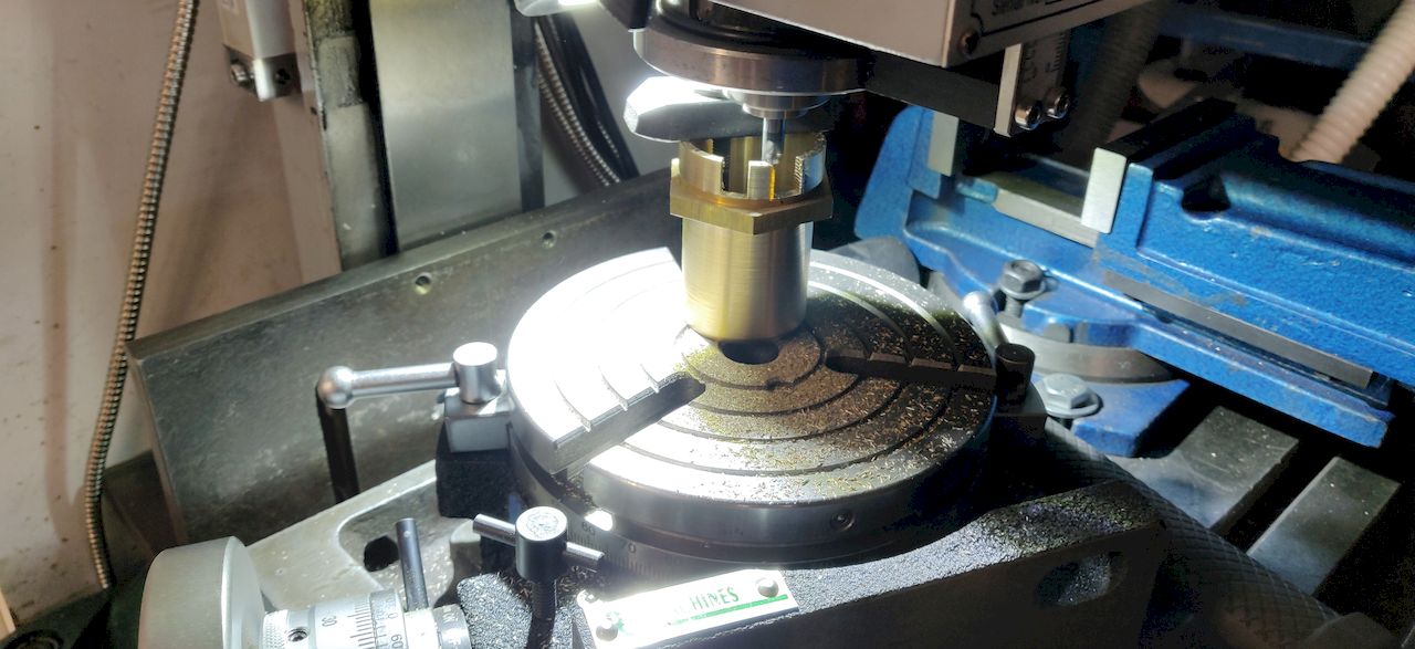

    I had the idea to speed up the process, using a power screwdriver. So I needed a big socket that could fit on the knob.

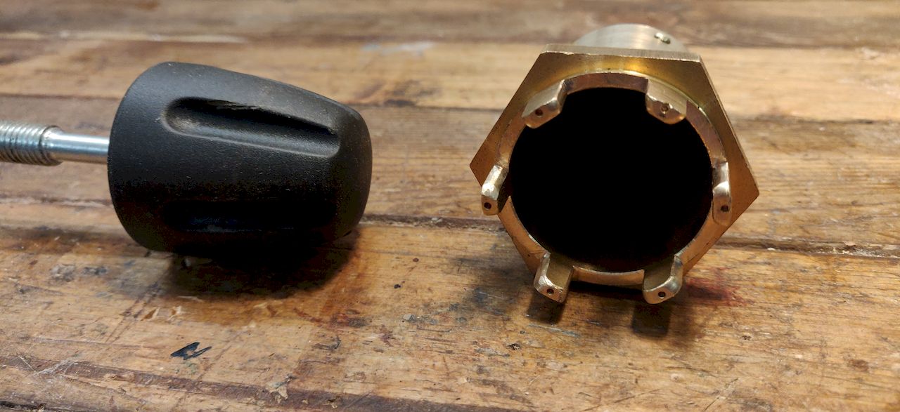

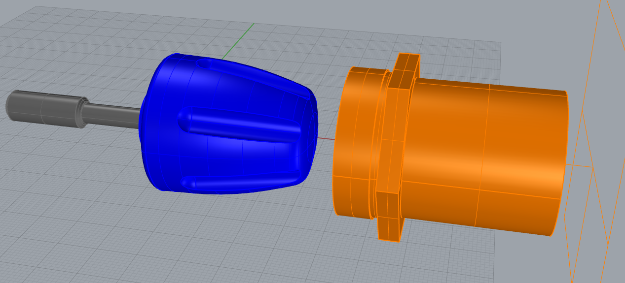

    In order to check how I could do that I initially 3D modelized the knob, I was thinking doing something with my CNC out of wood.

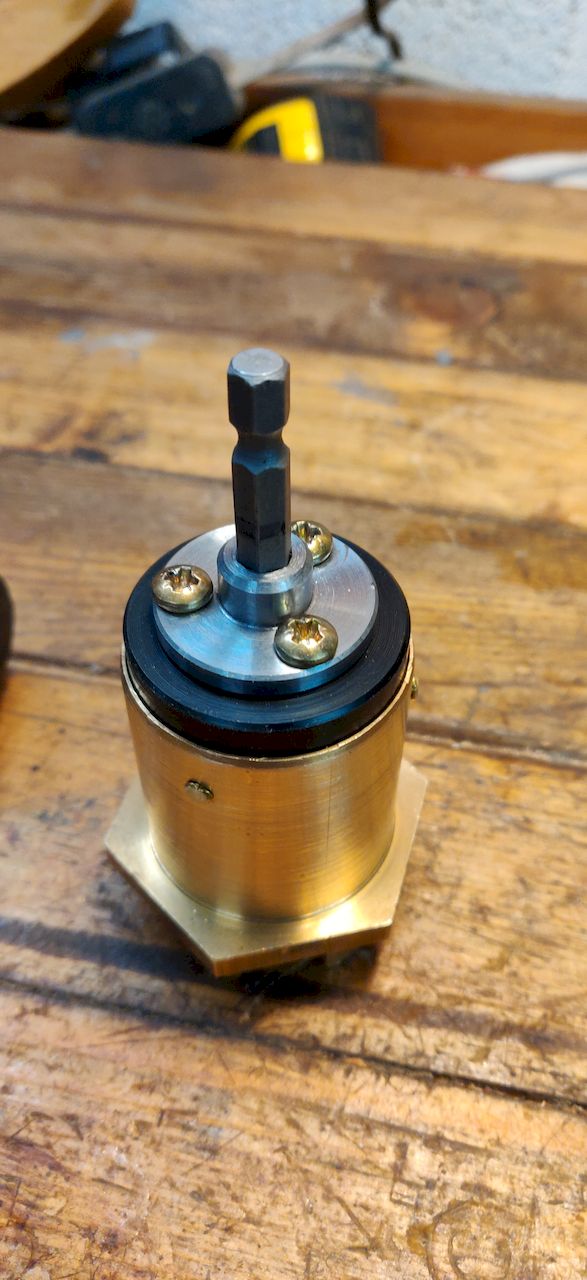

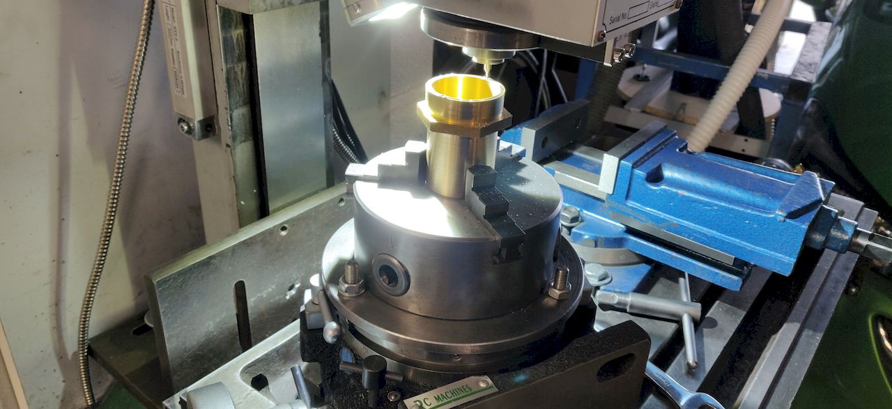

    But I realized I had this big brass fitting sitting on a shelf, and it could do just right with "little" work.
    So I decided to go the conventional way, using my mill and my lathe. (I like it !)
    Here are some pictures of the process and eventually the final product I came up with.
    Thanks for reading !
    Cheers !
    Christophe

    Couldn't you have more simply replaced the plastic capped bolts with regular bolts and used a socket in your drill? Or am I missing something?
    Jul 2014
    France, Brittany !
    913
    832
    Thanked 1,707 Times in 481 Posts
    Christophe Mineau's Tools
    Yes, I certainly could, but I preferred something non intrusive .

    No need to apology Bony, there's no trouble at all, your remark was absolutely relevant, but I never miss an occasion to play with my tools and to give myself some challenges.
    Here I did know this brass copler I had could fit, but it was not easy to predict the exact milling to be done with precise dimensions . Hence the 3d modelling, I could make some virtual cuts and see the intersection between the cylinder with the odd shape of the button.
    It's just fun for me, I like doing this, and I was initially thinking of doing the complementary shape of the button with my small cnc, stacking layers of plywood I would have cut following the different sections of my drawing.
    But at the end I had fun playing with my conventional mill and the rotary table.
    But for sure, do not see any logic but trying to have fun with my tooling and finding solution to unprobable challenges I set to myself.
