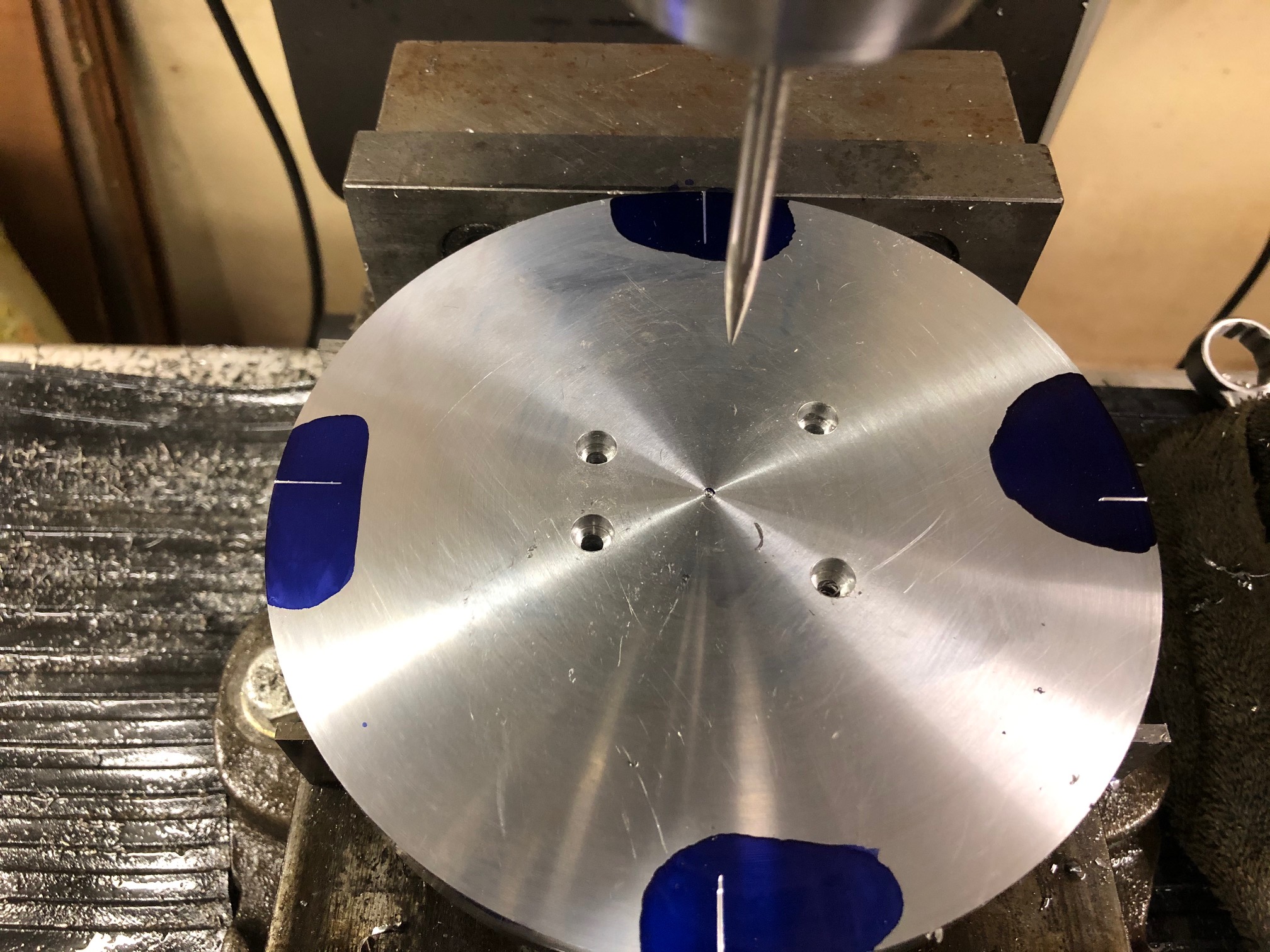

    Well guys I have finally started on my Power Drawbar,which is a pretty good challenge for me since I am a beginner at the lathe and mill.So my game plan is to try and follow J Ramsey design and keep it compact but works and will work over the yrs.J Ramsey said that his has lasted for the last 14yrs so that what I'm shooting for and will put me at 80yrs old by then I have two of these 6" disk one will serve as the base which will bolt to the BP then this one in pic will have the impact and the actuator mounted on it.And I have to say that laying out these holes was a big challenge cause math is not one of my strong suites,but being hardheaded and determined is.So here I am so far,if anyone has any suggestions I am all ears I don't want to make any silly mistakes.
