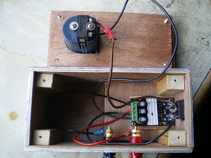

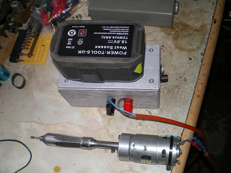

    Since retirement my 18 volt ni-cad power tool batteries have expired from lack of use, as I still have 9 power tools I have upgraded to 4 Ah lithium. To get more use from these new batteries I thought a power box might be useful to use with my home made rotary tool and for use as a nickel plating current supply as voltage is easily set from 3 to 18V.
    I used a dead radio as a socket mount but could have made something similar from wood. Nothing special inside just a cheap PWM board and a few bits I had in stock.
    Since making it I have realised how useful it is to be able to work outside with better lighting than in the shop.

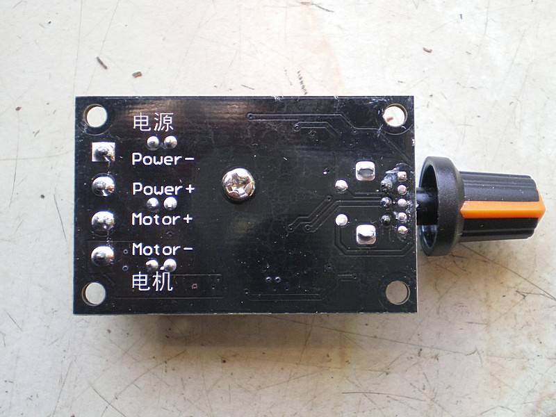

    Say more about the PWM board, please. Schematic? Source?

    Hi Don, there is not much to say about the pulse width modulator board, there are hundreds for sale on Ebay very cheaply, just make sure you choose one for the amps rating you need. Connections are clearly marked.
