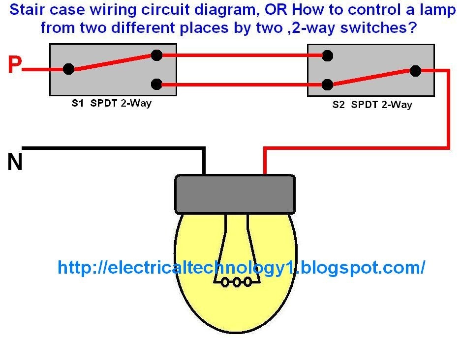

    If you find out that you still need to change the switch state to close the gate, try this diagram for a staircase light....
    Possible to use NC/NO switches as 3-way switches?-switch-diagram.jpg

    Yes these can be used as 3 ways ,you must use common of one switch as power,common of other switch as load and the no and nc become travellers ( they get connected together . eg nc to nc , no to no.THis will complete the wiring for a 3 way switching ciruit.
