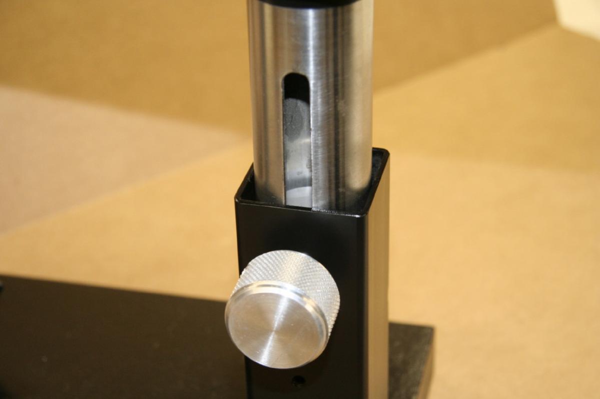

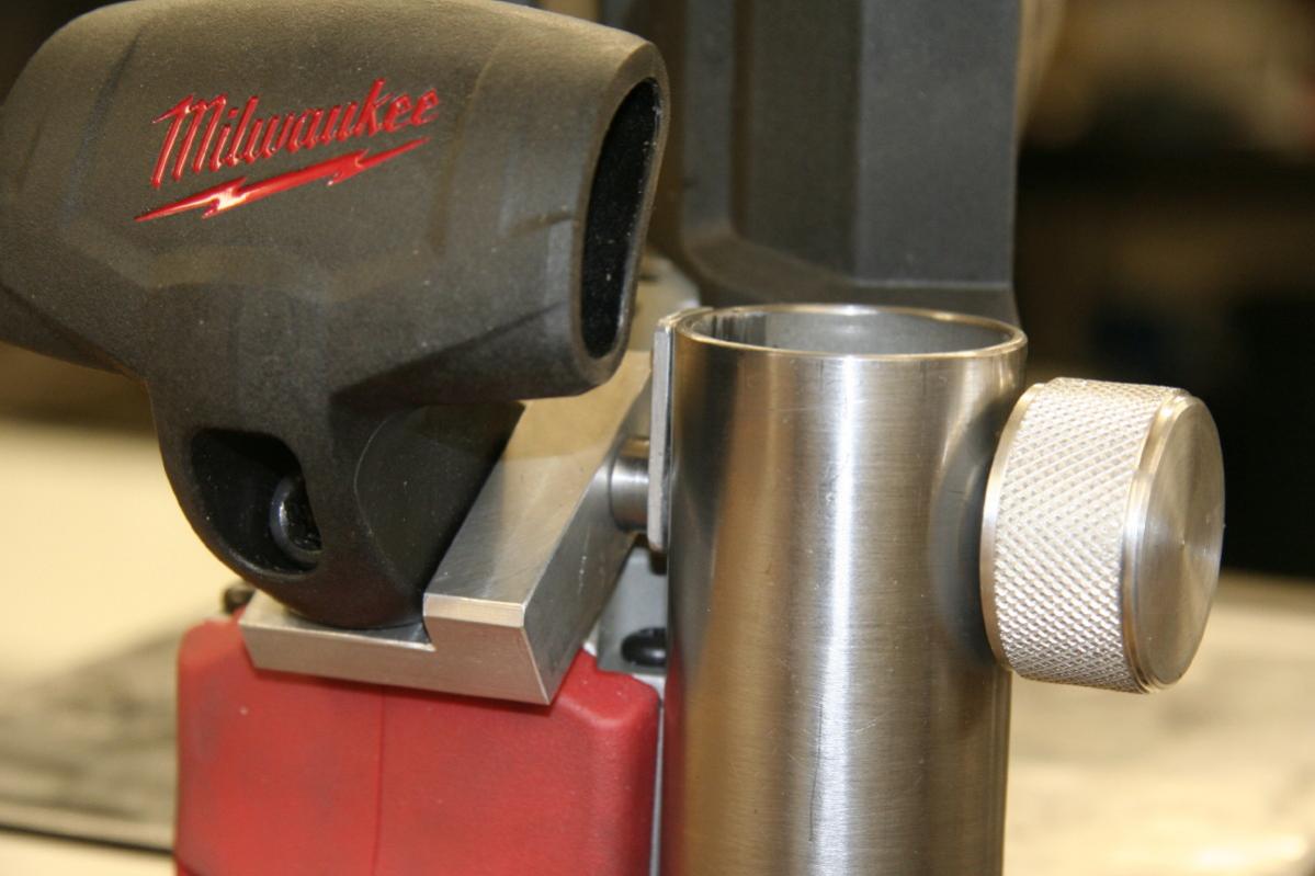

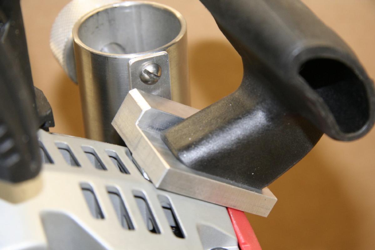

    Portable Bandsaw Stand

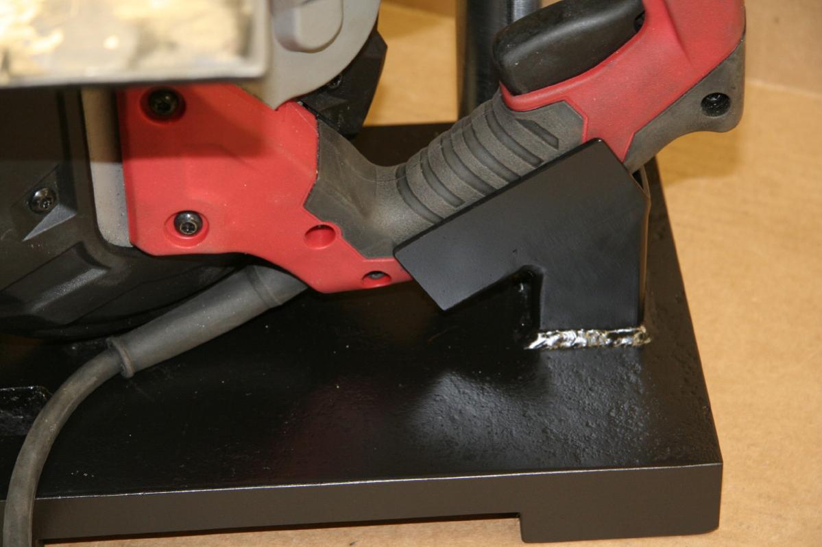

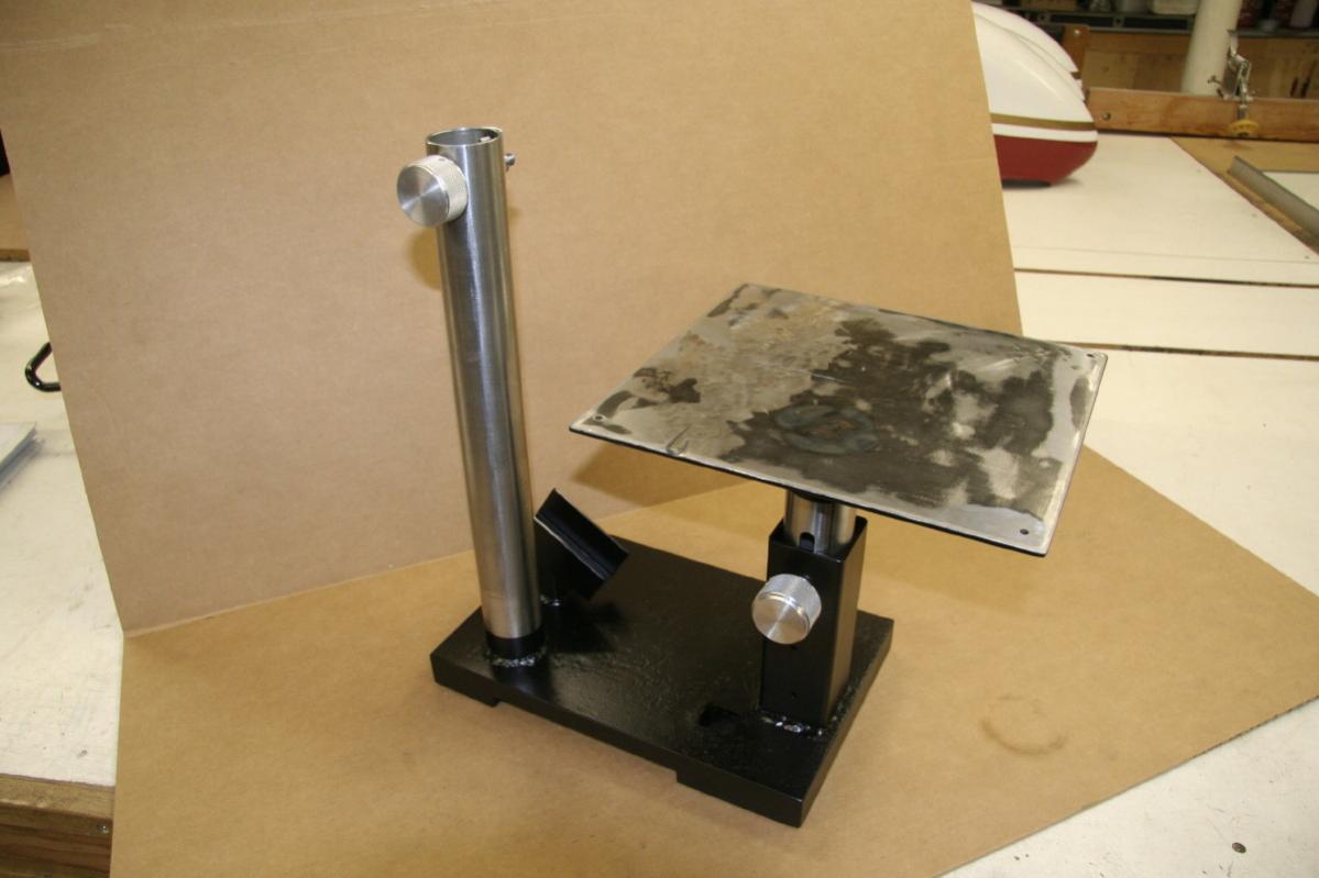

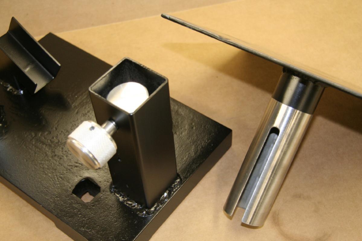

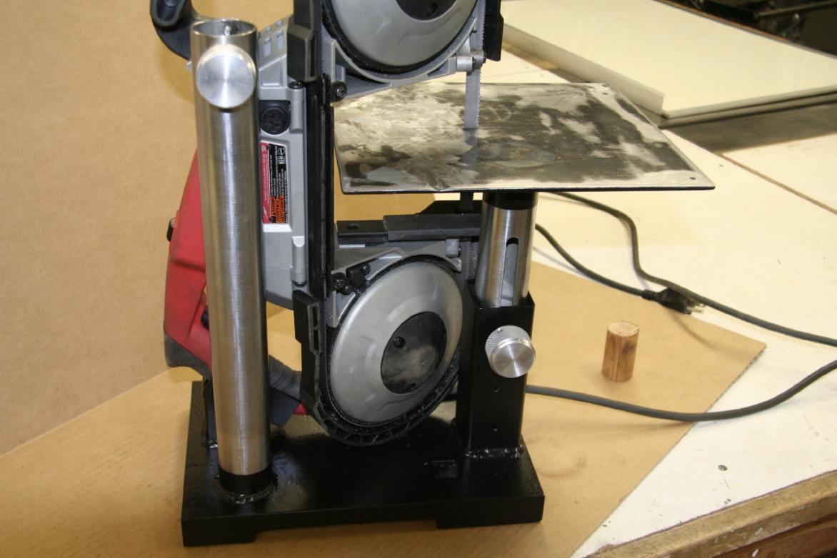

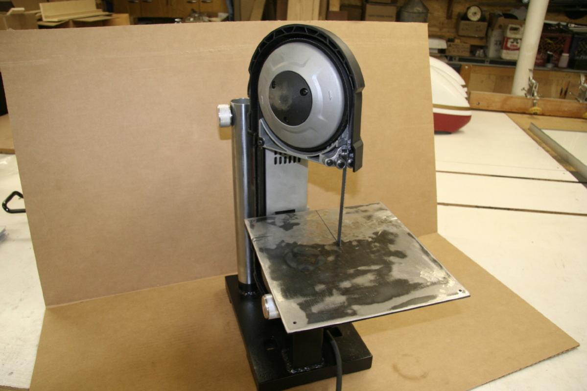

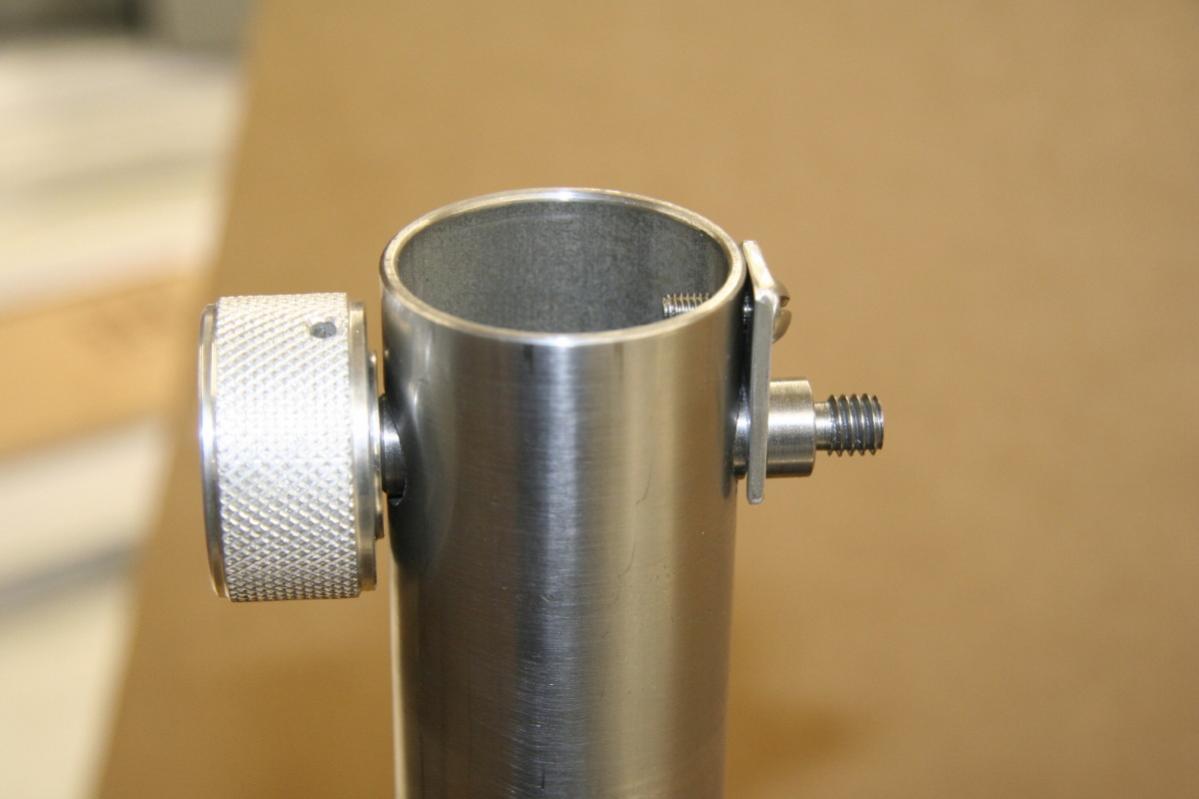

    Protable Bandsaw Stand. I made the base from 1/2 of a Railroad Rail base plate from a switch point, very heavy and nice to machine. The res from scrap from around the shop. Steel round & square tubing, 6061 Alu for the nobs, 6061 Alu for the saw forward handle adapter fitting, CRS 1018 for the machined re-tension shafts, 1/8" thick Cold Rolled steel plate for the table (recycled from an old aircraft jack stand), and a little paint to make it nice. Very solid and stable, I can set it anywhere to use it. About 3 in of table travel. Inspirational credit to You Tuber Chuck B. (Outsidescrewball).

    The plate is 1.1875 thick. Very stable and solid, no vibration.

    I like your heavy base made from part of a railroad rail base plate from a switch point. The wider switch point base sure makes the saw very stable but still light enough to move around.

    Few commercial benchtoppers have slow FPM, yours solves that well, I'm impressed. Despite access to various machine tools, I have a thing for metal-cutting bandsaws, especially vertical. I can see where your Stand, and my Milwaukee Portable Bandsaw Table (but then it's a horizontal) make a good team.
    I'm also struck with an idea to build your Stand into right-hand half of work bench, it serving as table for the bandsaw...I'm always notching long stock in thickness from 10ga to 1/4". That would support both sides of material better than a regular bandsaw, very much like the Roll-In or Marvel pattern vertical machines.
