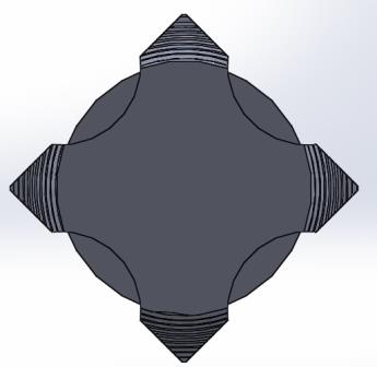

    A new member was asking how to drill square holes so I thought I would share a process that I have used successfully in the past
    for instance to make a 5/16" square hole in soft material or even in mild steel as long as it is not too thick I have taken a 7/16" NC starting tap and ground it square. the teeth will broach out the material to make a square hole. Care must be taken when doing it like this because the 60° cut angle is wrong for this application
    press the modified tap through the holes
    here is a drawing of how the tap would look
    Ideally you would use a 5/16 sq piece of tool steel ground to the shape of a broach
    like this

    they are no replacement for a proper broach but in a pinch and with care you can make quite a few hole turn square before the teeth break off
