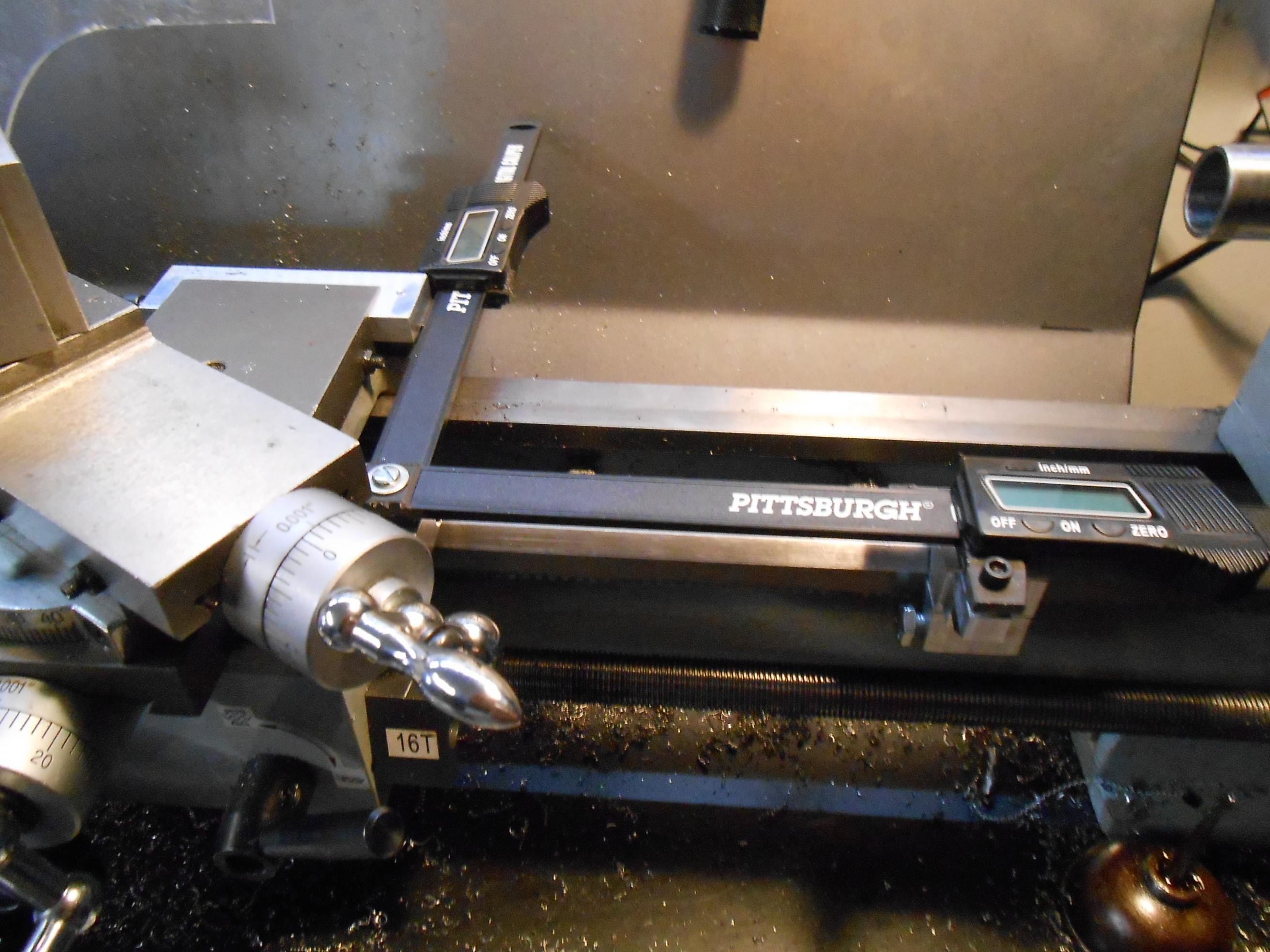

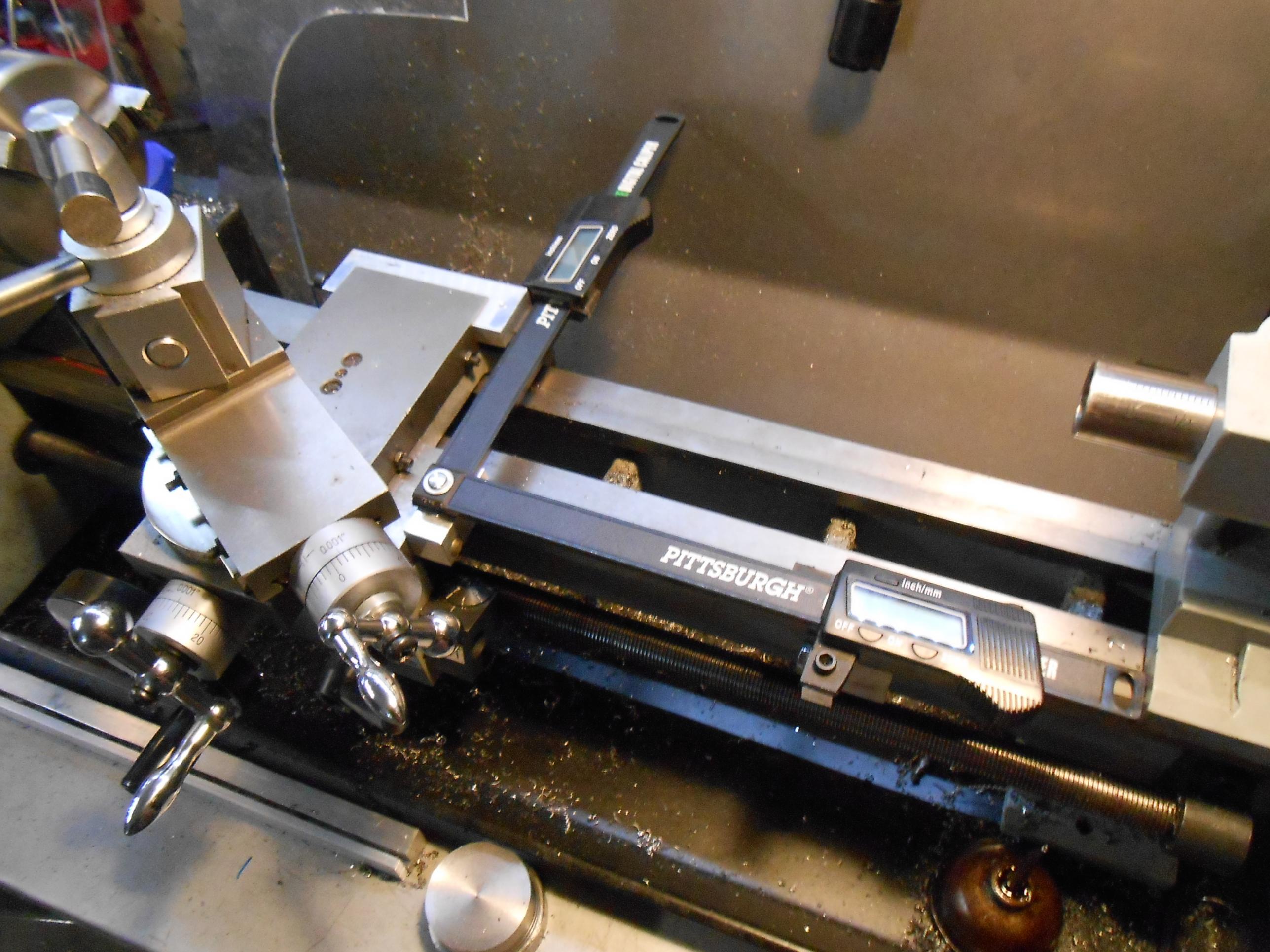

    Just a shot of some cheap Harbor Freight digital calipers I adapted to my mini lathe. I will be adding similar to the tail stock and possibly even the compound slide. It's about the cheapest DRO you'll find and they are quite accurate! They repeat everytime too.

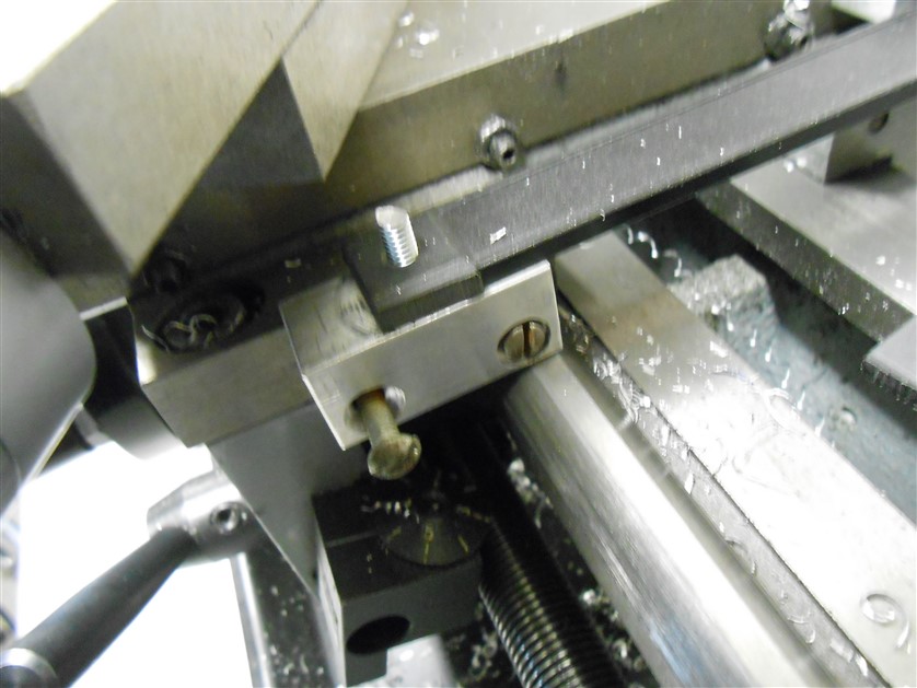

    I likeee, sure would be nice some closer pic of the mounts as I am lazy!

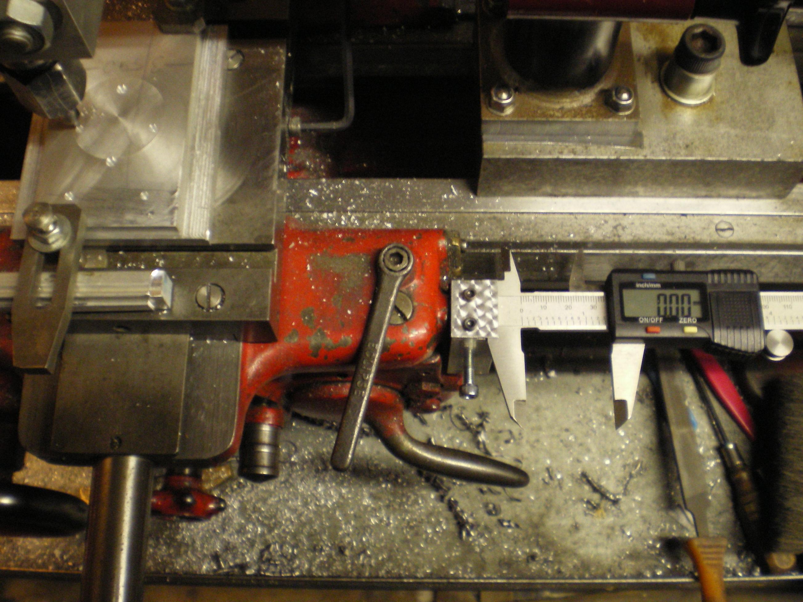

    Nice work Bobs,
    I also use this method for occasional use on the lathe saddle, in my case the calliper is not modified.
    I mostly use it when coordinate drilling and it is mounted on the thread dial spigot, very useful and accurate.

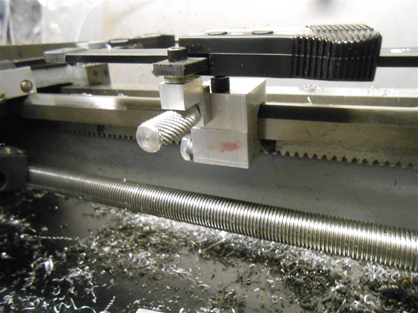

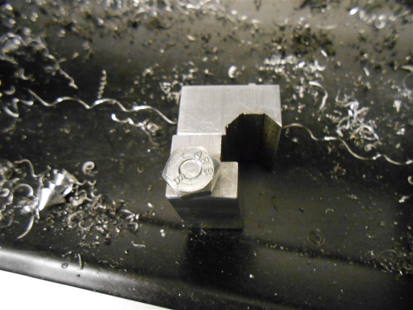

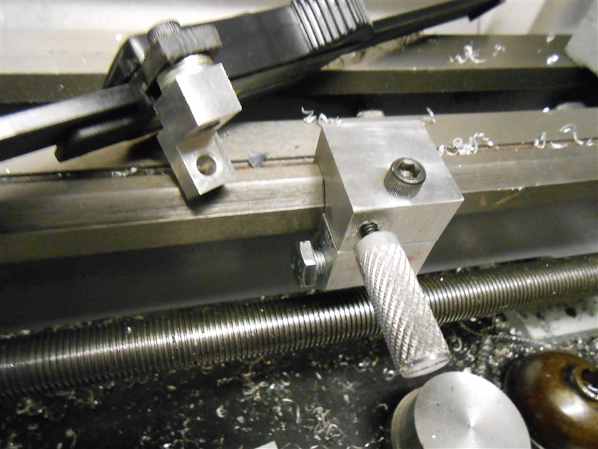

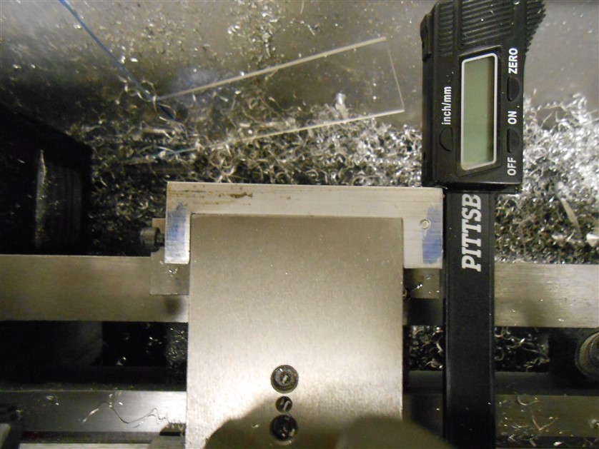

    Alrighty. Here's a few. I made U shaped bracket that clamps onto the cross slide at the back. One cap screw on the left side holds it in place. At the front side of the cross slide I added an attaching block. There was 2 existing holes there so I took advantage of those. The last one is actually one of two stop blocks I made for the ways. I used one of them to attach the end of the caliper and made a knurled knob to so no tools are needed to remove it.
    Of course every machine will be different. Mine is a 7 X 16 Microlux.
    Hope this helps.
